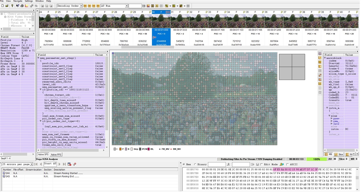

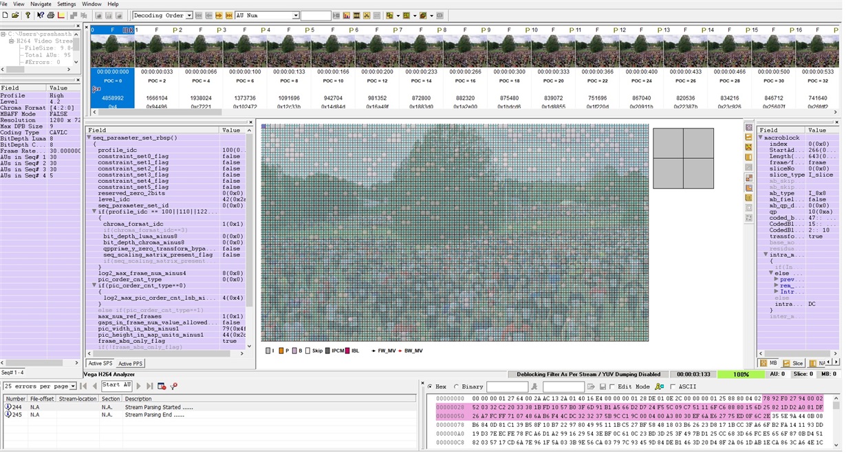

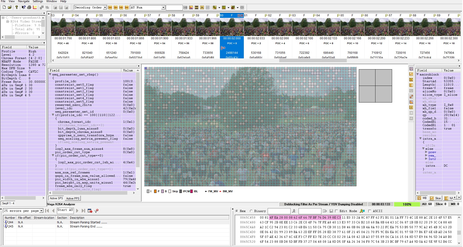

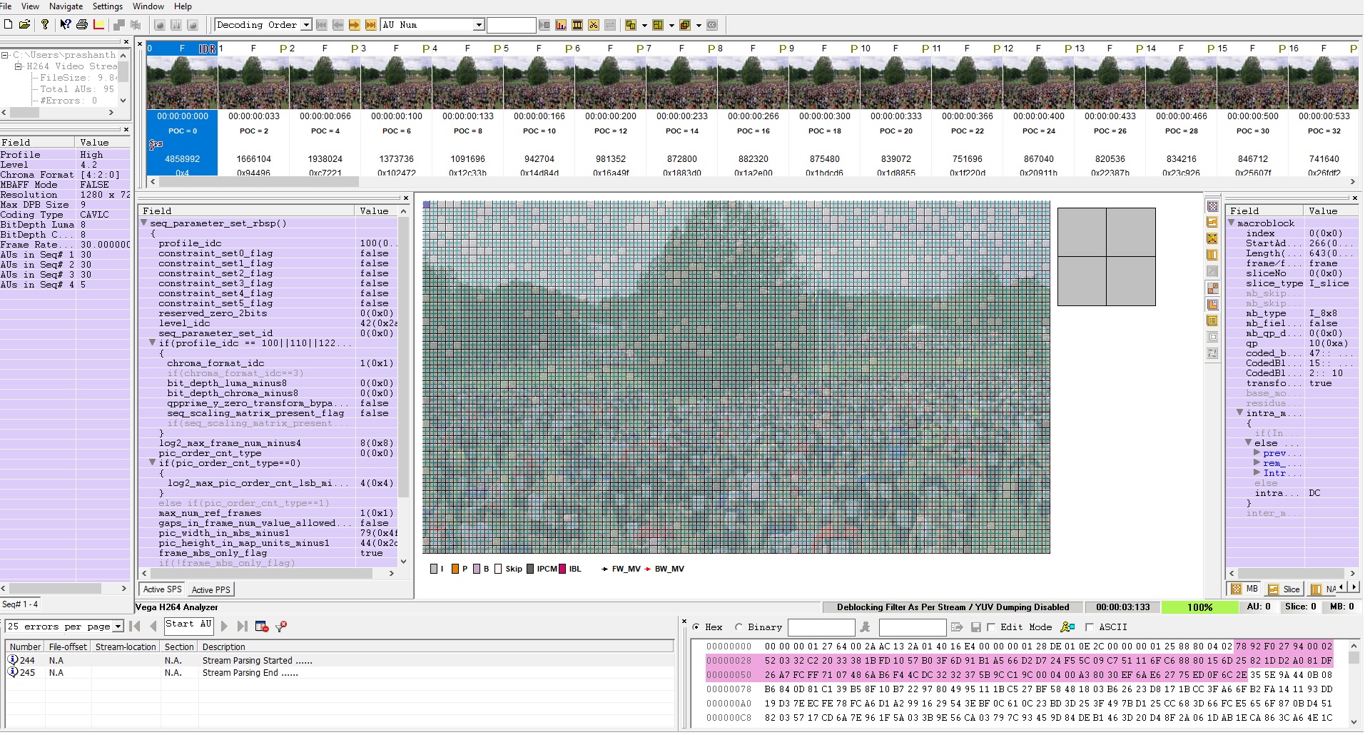

  • Suman,
    With the above parameters, I am able to encode all I as IDR frames in my standalone setup. Here are sample config file and the snap shots showing IDR frames as SPS PPS IDR P P P ... SPS PPS IDR P P P ... SPS PPS IDR P P P ...
    Can you dump and share your encoded bitstream?
    Attached the configuration file used by me to generate above bitstream.
    sample.cfg
