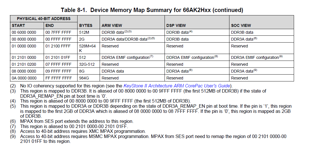

  • Where are the DDR3A and DDR3B located? I think when I access 0x80000000 from DSP, by default I access DDR3A right?
    Please see the K2H datasheet for memory map.
    Seeing from 0x8000_0000 on DSP core is DDR3B. But, if you have the MPAX setting to convert Physical address from 0x8:0000:0000 into logical 0x8000:0000, then what you saw is DDR3A address. If you use the GEL file on DSP for initialization, this has the MPAX set-up. Or, you can double check DSP core address 0x0800:0000 region for the MPAX set-up to confirm.
