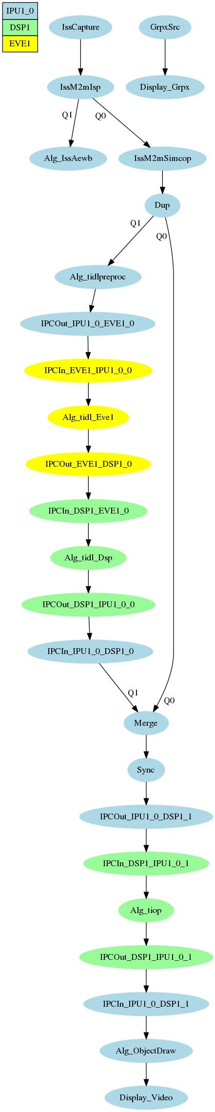

I would like to run tidl with sensor AR0140 through iss capture link on TDA3 rvp.
I generated a new use-case for it, but I couldn't see anything from camera.
But when I remove tidl link from my use-case, the camera worked well.
1. Can you please help me check my use-case.txt is correct?
Here is my txt content,
IssCapture -> IssM2mIsp -> IssM2mSimcop -> Dup -> Merge
IssM2mIsp -> Alg_IssAewb
IssM2mIsp -> Alg_SceneObstructionDetect (IPU1_0)
Alg_SceneObstructionDetect -> Null
Dup -> Alg_tidlpreproc (IPU1_0) -> Alg_tidl_Eve1 (EVE1) -> Alg_tidl_Dsp (DSP1) -> Merge
Merge -> Sync -> Alg_tiop (DSP1) -> Alg_ObjectDraw -> Display_Video
GrpxSrc -> Display_Grpx

    Can you share logs for working case & non-working case? & It's supported only ISS capture.
    Gaviraju

    The non-working case is combine "iss_capture_isp_simcop_display" & "tidlOD", which the use-case.txt is as below.
    UseCase: chains_issTidlOD

    Are you creating a use-case manually or using a use-case-gen-tool?
    All the frames are dropping at the sync link, so what is the "syncThreshold" value is set in the use-case?
    Gaviraju
  • Hi Gaviraju,
    1. I use use-case-gen-tool to generate _priv.h & _priv.c, then manually create the use-case.c .
    2. syncThreshold is 600, what value do you suggest?
    thank you,
    Gary
  • Hi
    Set syncThreshold = 6000 then see the result.
    Gaviraju

    From the log, I observed you are getting this error
    Assertion @ Line: 191 in system_linkApi.c: procId < SYSTEM_PROC_MAX : failed !!!
    It seems you are passing the wrong link ID to function "System_sendLinkCmd", So please check the link ID in this function.
    > if ((0U != frmList.numFrames) && (FVID2_SOK == status))
    This will fail when there is no output buffer available in the queue
    The Source to Link Latency from ISSM2MSIMCOP  to ALG_TIDLPREPROC is taking too much of time around 1200 ms, So please add timestamp print statement while sending NEW_DATA command in  ISSM2MSIMCOP  link & add same print in the ALG_TIDLPREPROC  link when you are receiving new data command & observe the differences.
    Gaviraju

  • Hi
    SRCS_ipu1_1 += tidlpreprocLink_algPlugin.c
    file: vision_sdk/apps/src/rtos/alg_plugins/tidl/SRC_FILES.MK
    Gaviraju
  • Hi Gaviraju,
    When I ran alg_tidlpreproc on IPU1_1, there was an "out of memory" error.
    Here is the debug log,
    [IPU1-0]     21.251204 s:  ### XDC ASSERT - ERROR CALLBACK START ###
    [IPU1-0]     21.251265 s:
    [IPU1-0]     21.251540 s: out of memory: handle=0x8208b2fc, size=64920576
    [IPU1-0]     21.251631 s:
    [IPU1-0]     21.251662 s:  ### XDC ASSERT - ERROR CALLBACK END ###
    [IPU1-0]     21.251753 s:
    [IPU1-0]     21.252180 s: ti.sysbios.heaps.HeapMem: line 221: ti.sysbios.heaps.HeapMem: line 221: out of memory: handle=0x8208b2fc, size=64920576
    [IPU1-1]     21.252455 s:  Assertion @ Line: 460 in dmaSwMs/dmaSwMsLink_algPlugin.c: pSystemVideoFrameBuffer->bufAddr[0] != NULL : failed !!!
    [IPU1-1]     21.253187 s:  Assertion @ Line: 460 in dmaSwMs/dmaSwMsLink_algPlugin.c: pSystemVideoFrameBuffer->bufAddr[0] != NULL : failed !!!
    Here is the related code.
         pSystemVideoFrameBuffer->bufAddr[0] =
                            Utils_memAlloc(
                                    UTILS_HEAPID_DDR_CACHED_SR,
                                    ( pDmaSwMsObj->outBufSize ),
                                    ALGORITHMLINK_FRAME_ALIGN
    and
         outBufSize = pDmaSwMsObj->outPitch[0] * maxHeight * 2;
    Can you suggest what maxHeight should be and where can I find it?
    Thank you,
    Gary
    Please print the "outBufSize" variable & see the value is valid or not.
    This value depends on the width, & height set in the use-case. So check what value are you set in the use-case.
    Refer below usecase file for setting
    vision_sdk\apps\src\rtos\usecases\iss_mult_capture_isp_simcop_stereo_tda3xx\chains_issMultCaptIspSimcop_Stereo.c
    #define REMAP_WIDTH 800
    #define REMAP_HEIGHT 384 these 2 macro used to set "dmaSwMsLink" width & hieght
    Gaviraju
