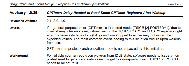

    Thank you for the suggestion.  We have been performing multiple changes and debug activities, which I will summarize here.
    We saw this errata, and that made us remember that a previous developer had patched arch/arm/mach-omap2/timer.c in our previous v3.14 kernel to force nonposted synchronization mode on our timers.
    With devmem, I have confirmed that our running kernel now has TSCICR POSTED set to 0 for all timers.  After this change, the soft lockup I mentioned on Feb 17 went away completely.

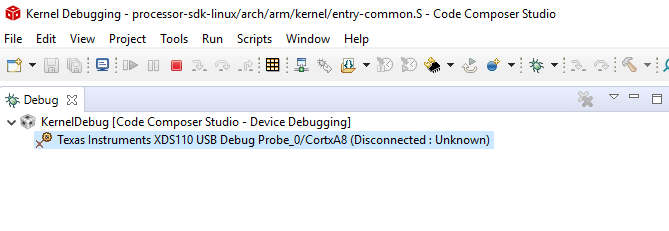

    We are still seeing a lockup of an unknown nature, but we have found a way to resume operation.  If we connect to a locked up unit with JTAG and Code Composer, we notice a processor state of Disconnected: Unknown as shown in this screen shot:
    This is an unusual state, since we normally see Running or Suspended for the CortexA8.  If we then connect to the CortexA8, it transitions to the Suspended state.  Then if we click the Play button the execution of the kernel continues as normal with no lockup.  We have been able to fix the lockup about 7 times by starting the session, observing the Unknown state, connecting to the CortexA8, observing the suspended state, then resuming.
    On several instances after the resume, we have observed workqueue lockups.  A sample of log buffer for these lockups are:
