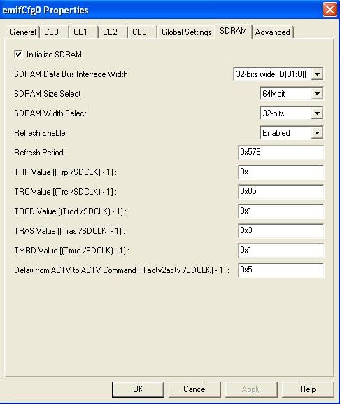

    BTW: I used the default DSP/BIOS EMIF setup for DSKC5510 which is shown as follows. Does it look Okay to you?
    Anyway. Thank you very much for your help.
    Simon
    Your EMIF setup looks good.

  • Hi Xinwang,
    I am doing the C5509 with DSP/BIOS. But I have problem find the dialog you showed there since I always use DSP without BIOS. Could you help me with open the dialog. Thanks.
    Han Zhang
  • Hi Han,
    I am not sure what you mean by "dialog". If you were talking about that image I showed, you could find it by the following steps. I assume you would use CCS 2 for doing it.
    1. Generate a DSP/BIOS file, *.cdb.
    2. In the file you just generated, go to the section Chip Support Library. Click on "+" and locate EMIF. Go to the subsection EMIF configuration Manager. If you setup DSK correctly, you should be able to see a default configuration: emifCfg0
    3. Right click on emifCfg0 and choose properties. Here is the place where I took the screen shot.
    Good luck.
  • Hi Xinwang,
    Thank you very much for your fast reply. I am right asking about the image. But I am using CCS4 and I cannot find the CSL section in the configuration tool of DSP/BIOS. Do you know how to figure it out? Thanks.
    Han
  • Hi Han,
    I have been using CCS2 and CCS3 for the designs, have never used CCS4 before. I am afraid that I may not be able to help you on that.
    However, I think using Chip Support library would be fairly easy as well. What DSP/BIOS CSL section does is just generate a c code for your graphic design.
    Why don't you use CSL directly?
