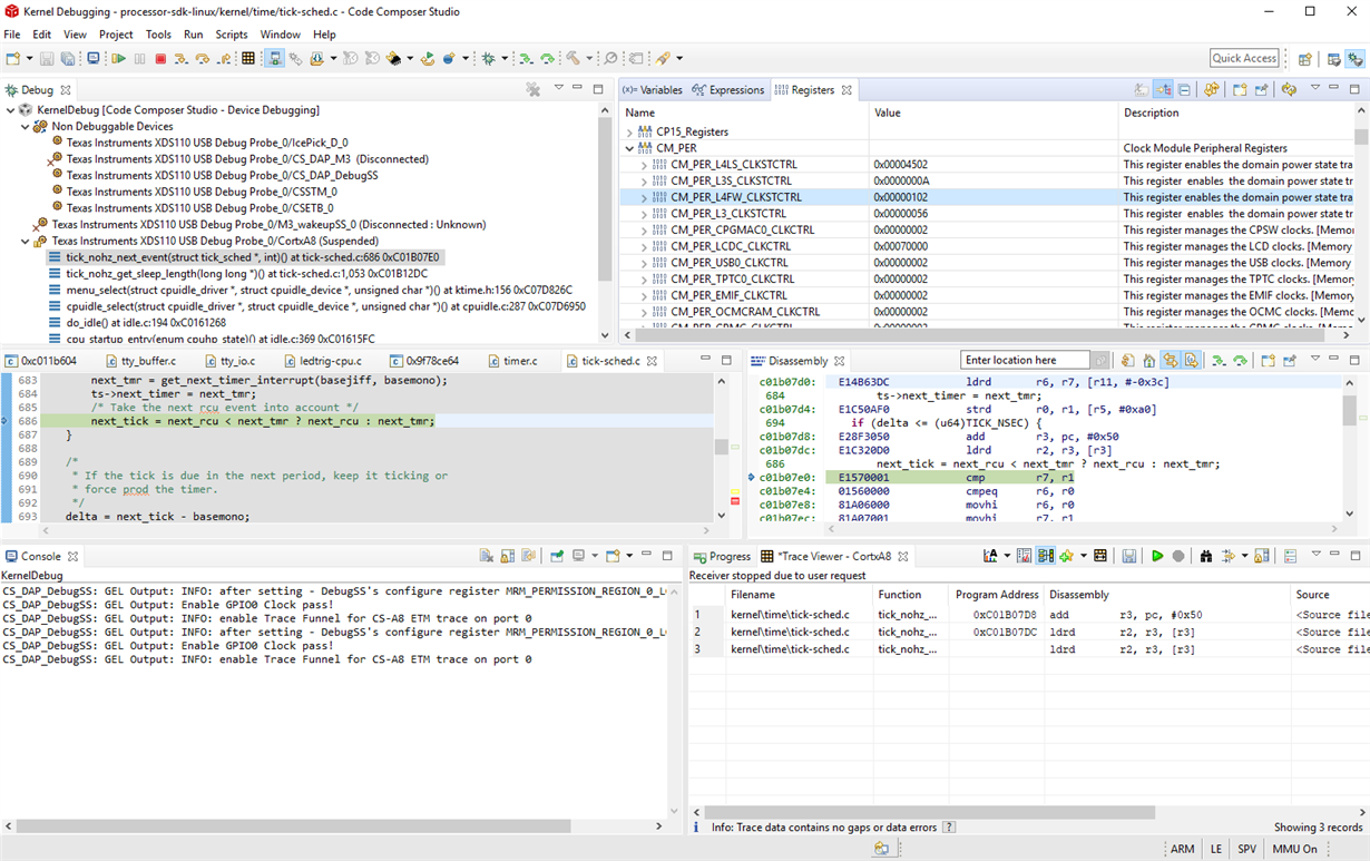

    The behavior that I expect is to be able to have Tools / Hardware Trace Analyzer / PC Trace start the trace on the Cortex A8.  When it is working, I am able to view the Program Trace as shown in this screen shot.

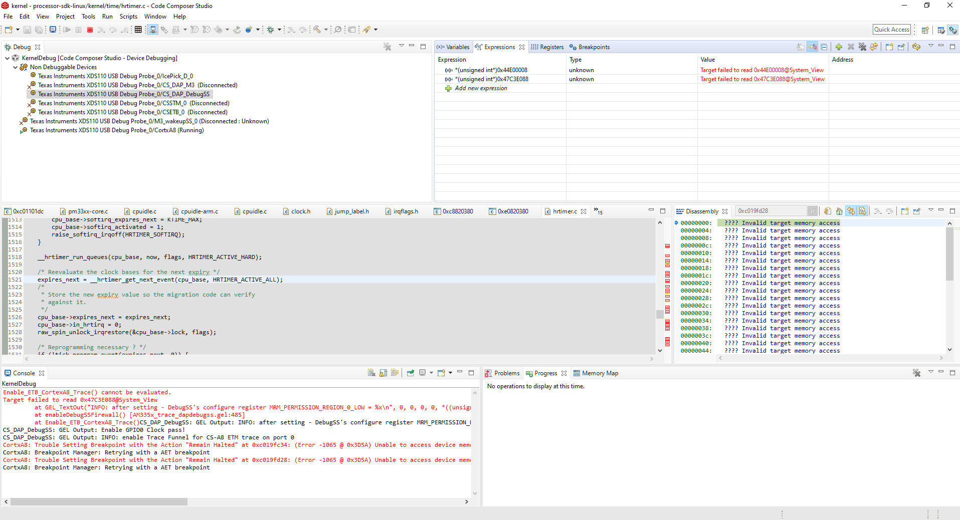

    Here are some screens showing other symptoms.  When the trace enable is working, I can enter the addresses for CM_PER_L4FW_CLKSTCTRL and FW_DBGSS_MRM_PERM_REGION0_LOW into the Expressions window for CS_DAP_DebugSS core.  CM_PER_L4FW_CLKSTCTRL has the value of 0x102 which I have set in the Registers window on CortexA8 core, and FW_DBGSS_MRM_PERM_REGION0_LOW has the value of 0xffffffff that was set in enableDebugSSFirewall() of the AM335x_trace_dapdebugss.gel.
    When the script is not working, I am no longer able to access these same registers from the CS_DAP_DebugSS core.  This screen shot shows the register access failing.
    It seems like the trace enable script works the first time I've ever connected to my Sitara board with Linux running.  It seems like the script (and register access thru Expressions window) always fails the second and subsequent attempts when Linux is running.  Power cycling both the XDS110 and the board doesn't seem to clear the problem.
