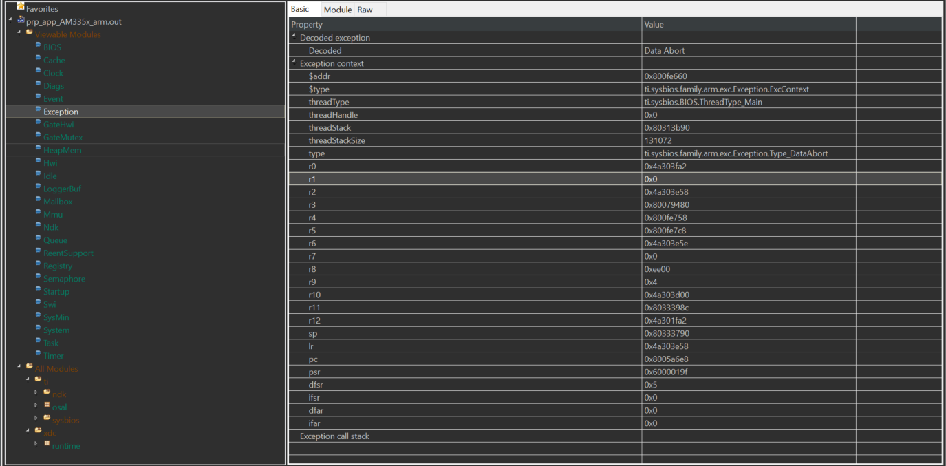

I am running my program on AM335x and i am running into data abort exception.
I see "CortxA8: Unhandled ADP_Stopped exception 0x20023" on my console when exception occurs and the ROV looks like below
MMU configuration in the .cfg file looks like below

  • Hi Shubham,
    Please see DDI0344K_cortex_a8_r3p2_trm.pdf, Section 2.15.1 Exception entry and exit summary.
    In your ROV snapshot, it appears R14_abt (lr) contains 0x4a303e58. This is an address in PRU_ICSS DMEM1, so I believe a read/write to DMEM1 caused the data abort.
    Can you please try the MMU settings contained in the file pdk_am57xx_1_0_16\packages\ti\drv\uart\test\firmware_test\am335x\armv7\bios\am335x_app_bbbam335x.cfg (see below) and let me know the outcome?

  • some more details i see on console after enabling sysmin buffer
    [CortxA8] 0 PC(R15) = 0x8005e848
    PSR = 0x6000019f
    DFSR = 0x00000005 IFSR = 0x00000000
    DFAR = 0x00000000 IFAR = 0x00000000
    ti.sysbios.family.arm.exc.Exception: line 205: E_dataAbort: pc = 0x8005e848, lr = 0x4a303e58.
    xdc.runtime.Error.raise: terminating execution
    cortex A8 trm suggests that DFSR = 0x00000005 points to
    DFSR - > b000101 -> translation fault, section
    i am not sure what exactly it means.
  • This is resolved now.
    The issue was due to library wasn't built correctly.
    One of the structure definition was changed in library header file after library was built, leading to mismatch of structure definition between the library and application.
    Thanks frank for taking time to respond and guiding in right direction.
