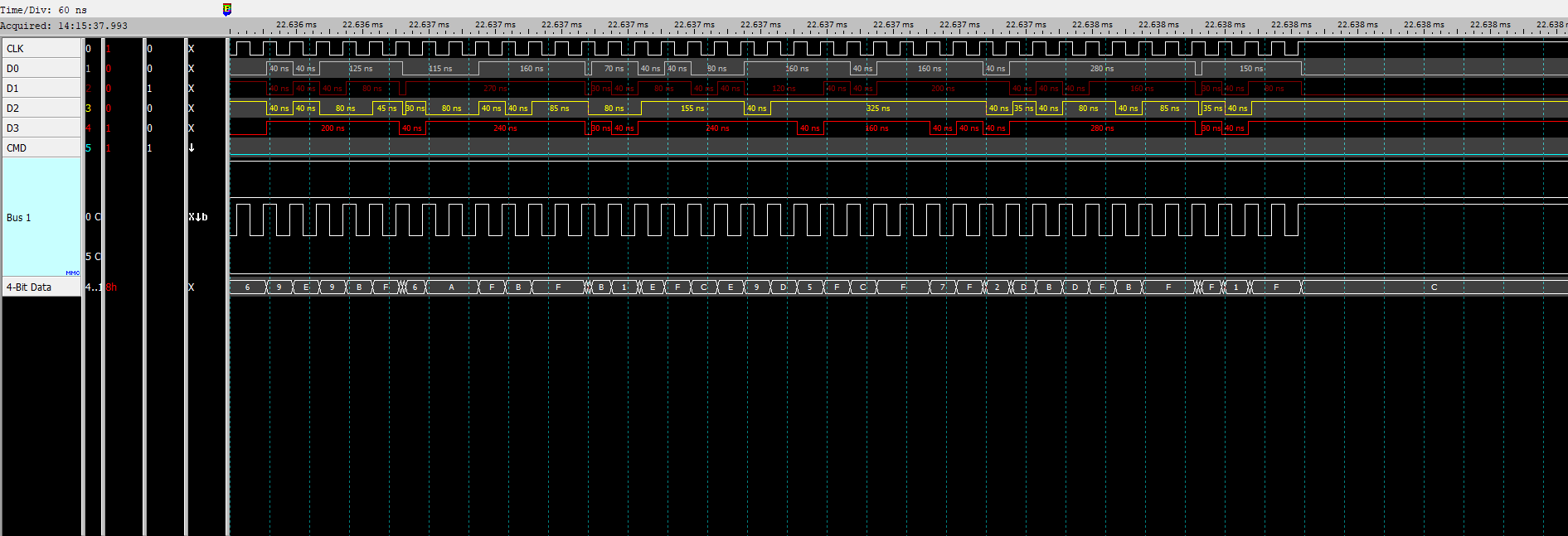

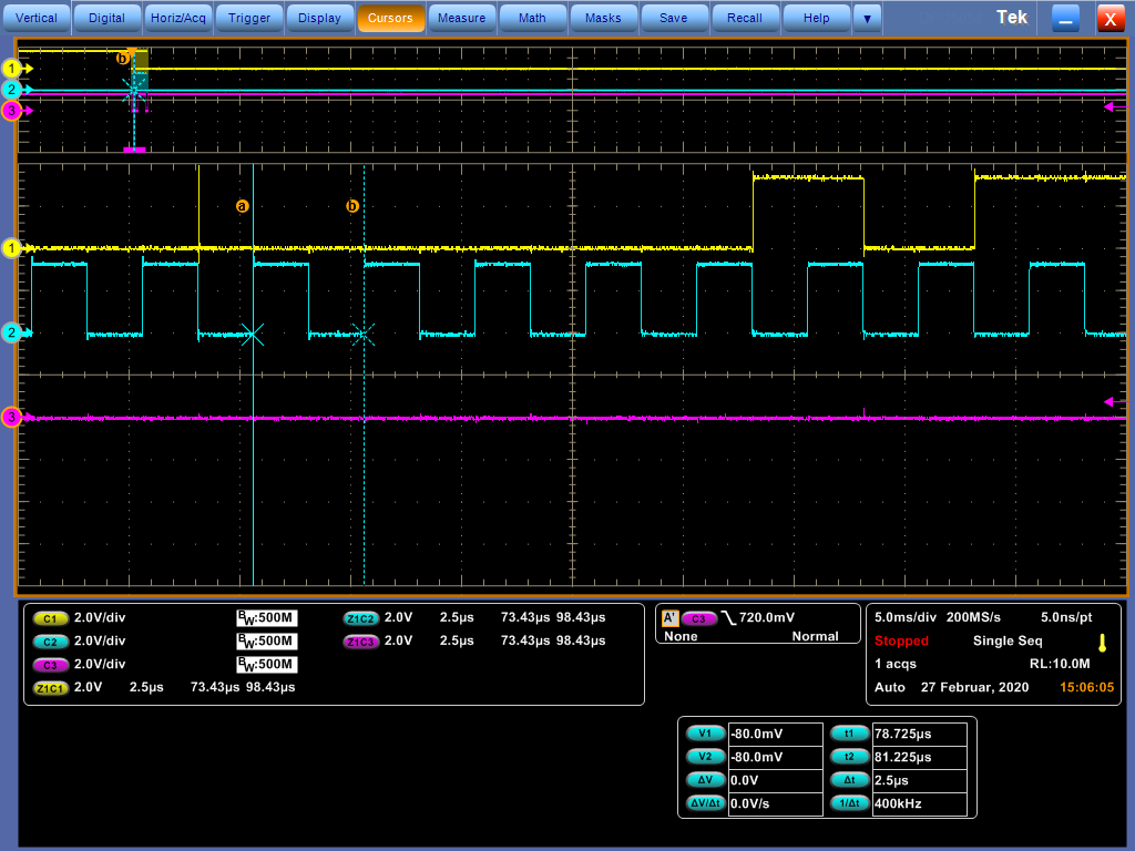

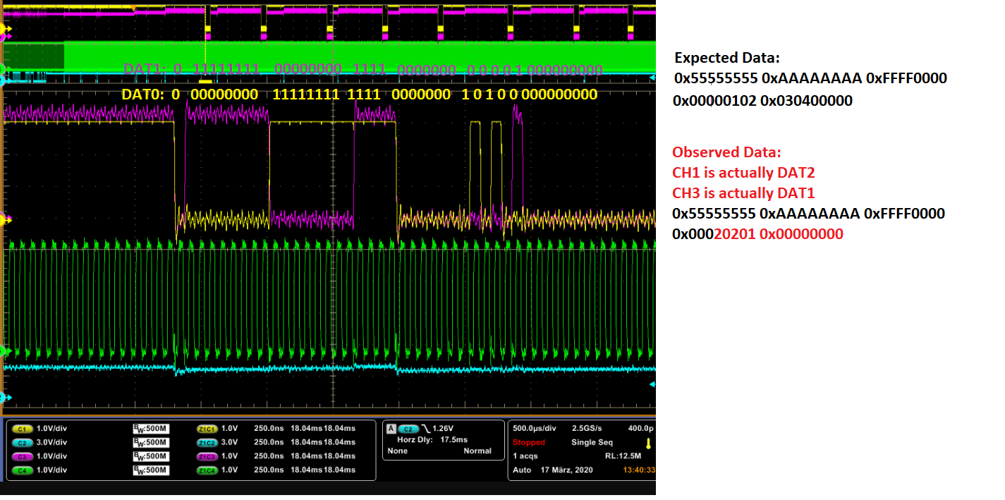

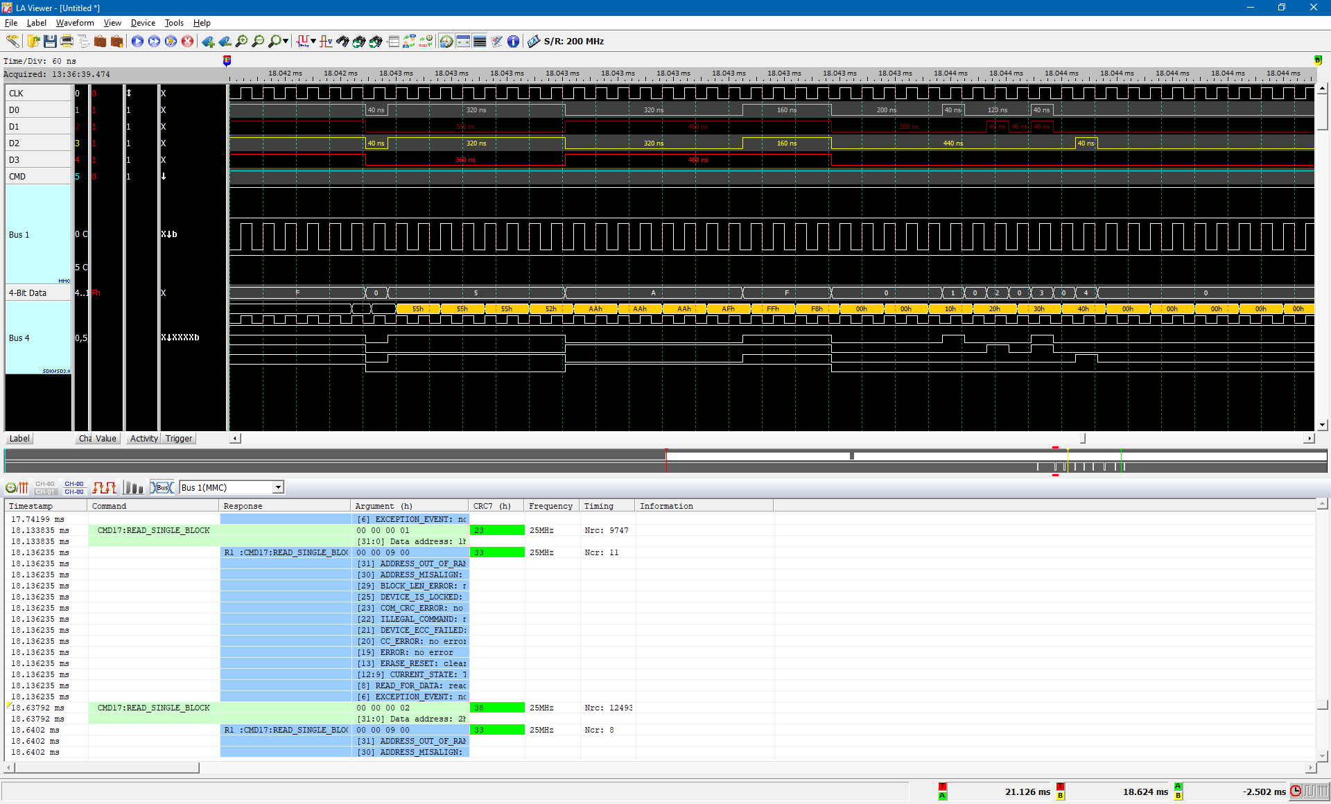

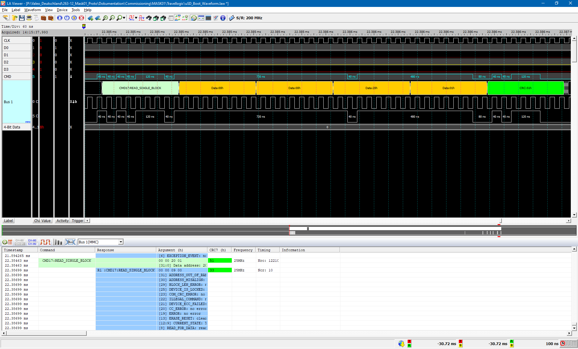

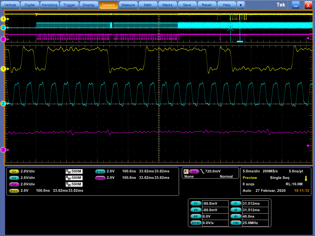

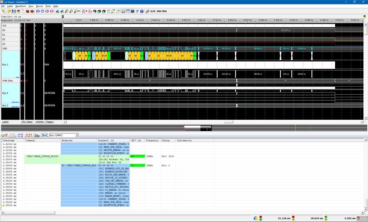

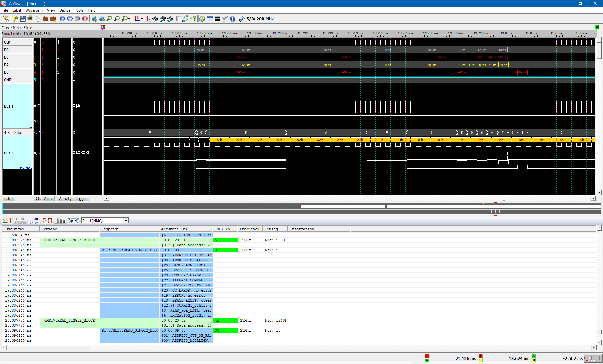

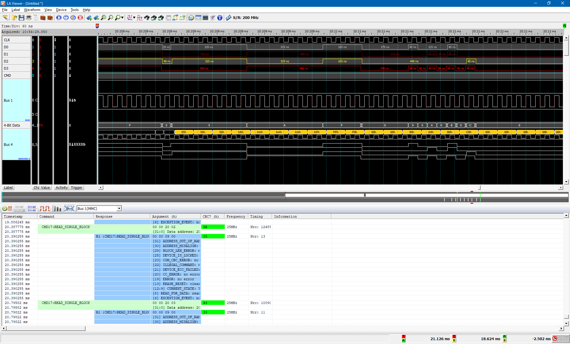

The Logic-Analyzer Traces show that the Bootloader is accessing the card and reading data in 4-bit mode.
Is there anything else beside the SD-Card, the SoM Bootloader ROM code requires to boot the SD-Card ?

SD-Card Boot from SoM, repeats several times, but SoM does not start

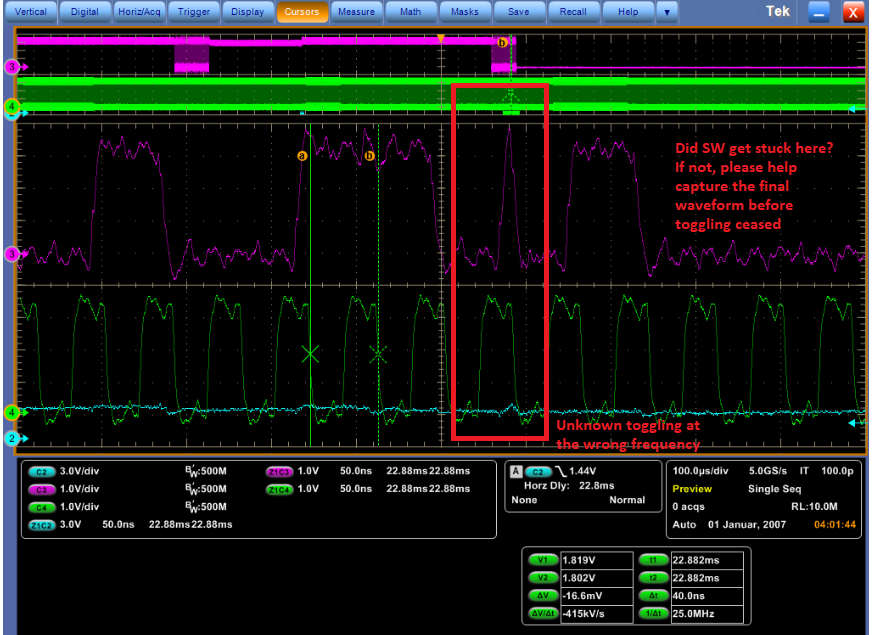

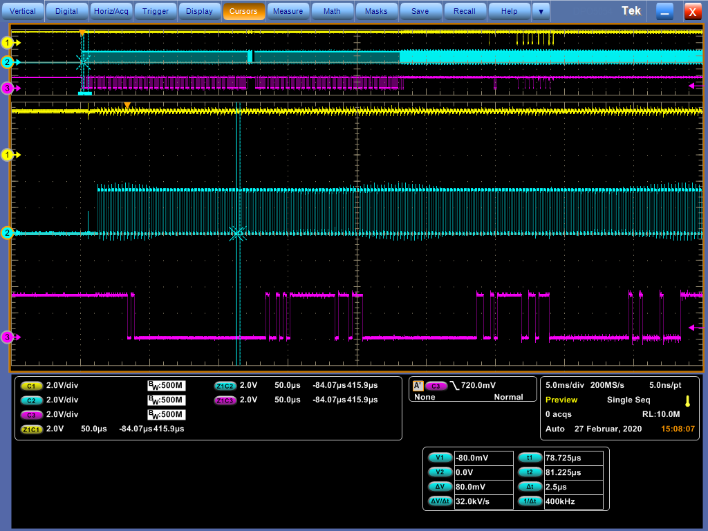

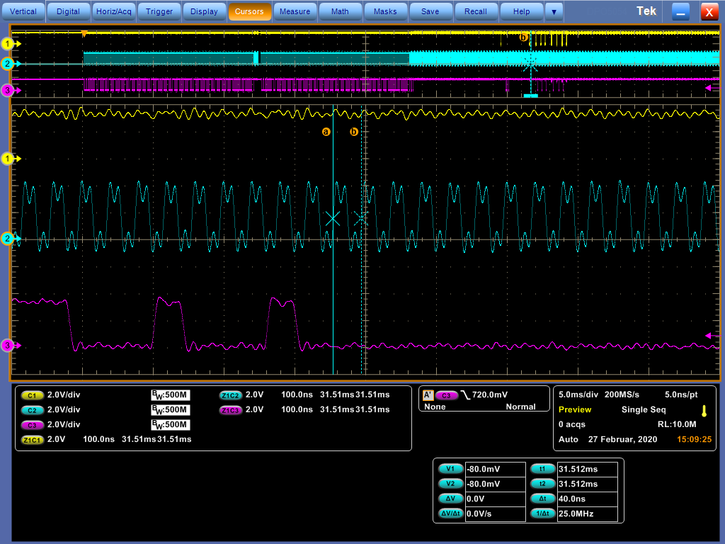

  • Hi Vishal,
    thank you for the link.
    My problem seems to be earlier in the Boot process. The ROM Bootloader seems not to be happy with
    the code read from the SD-Card, therefore I have no UART output and the processor will never reach the U-Boot code.

    Can you provide scope captures of the failed SD card access. We need to see CMD, DAT, and CLK lines.
    Vishal
  • Hi Vishal,
    The probe connections are coded into the file name (might be lost during upload). Ch.1 = DAT0, ch.2 = CLK, ch.3 = CMD
    The behaviour is different from boot to boot, here are some images from different tries
    Daniel

    The first command is this one
    the decoding is stopped after the following command / error ?
    Overview (at the blue cursor)
    detail:
    For this reason, I have added a 4-bit bus to see the data as good as even possible:
    2. last command:
    last command:
    last data (start):
    last data (end):
    I have tapped the analyzer at the uSD card side (J7 side is impossible to tap the probes)

  • Daniel,
    Based on the log analyzer results, it appears the SD card stopped responding with data halfway through the last block and the SoC read the inactive high as "0xFF" data.
    A few questions...
    1. How are you letting the SD card know how many blocks to transfer?
    2. Can you share the same log capture when the SD card is read successfully on the EVM?
    3. Can you probe the signals so you can capture the waveform at time of failure?  Key Items to check:
    1. Was slew rate fast/slow?  This will indicate whether the SD card actively drove the signal to inactive stage
    2. How was signal integrity here?
    • This looks to be happening in bootloader.  Can you add debug prints for the following registers:
      1. MMCSD0_PRESENTSTATE (Offset 0x24)
      2. MMCSD0_NORMAL_INTR_STS (Offset 0x30)
      3. MMCSD0_ERROR_INTR_STS (Offset 0x32)
      Were you able to send a CMD13 after the failure to check on device status?
    Have a great day!

  • Hello Shiou,
    we made a lot of tests and measurements today.
    The Evalboard works, reads block 0 and afterwards block 0x800 (see log)
    My own Hardware does not work, reads block 0, 1, 2, 3 and then block 0x200, 0x201.
    Data integrity seems to be good for block 0, but data is suspect.
    Afterwards, data integrity is no more good (see last block screenshot), and even data to clock relation has changed ! unexpected spikes in data detected
    Here are the images:
    read block 0: (ch.2 = CMD, ch.3 = DAT2, ch.4 = CLK)
    read last block (0x201)
    Log Decode for Own Hardware: (pdf)
    uSD_Boot_Report_OwnHW.pdf
    My own HW, Data:
    uSD_Boot_Data_OwnHW.pdf
    Evalkit Log:
    uSD_Boot_Evalkit.pdf
    If Logs are not readable (it seems so), please tell me how to upload a pdf / xlsx or similar file,
    Thank you and best regards,
    Daniel

  • Adding a picture of the CMD6 structure for reference.
  • Daniel,
    Moreover, please confirm the following:
    1. Is the following screenshot the last waveform toggling on DAT line?  How repeatable is the spike in the image?
    2. Do you have pull up resistors on the DAT and CMD lines?  Since DAT line is pulled low, that means the device was still busy when it stopped sending out data.
      1. Another possibility is if you don't have PU resistors enabled and DAT0 was actually floating.
    3. What SD card are you using?  Have you tried working with a different SD card?
    Have a great day!
    Shiou Mei

    3. Screenshots and spikes:
    - We have seen a lot of spikes in the second-last and last block read from the SD card.
    - Block 0 read (the first) seems to be fine AND THE TIMING DATA to CLOCK is COMPLETELY DIFFERENT
    - Data from Block 0 is garbage and after this, the Bootloader reads blocks 1,2,3, 0x200 and 0x201
    - at least at block 0x200 and block 0x201, THE DATA to CLOCK TIMING IS COMPLETELY DIFFERENT and
    we can recognize these spikes in data (repeatable, each time)
    (I think that reading block 0 and not receiving correct data is the source of the problem)
    block 0x00:
    block 0x200:
    different timing when reading block 0x201:
    - We have 47k pullup resistors on each DAT signal, CMD, CLK and Card-Detect
    - The rise time of the spike is much too fast for the 47k pullup, this signal must be driven actively by the card
    - We use the uSD Card from the TDA4 SoM shipping (SanDisk Edge 16GB HC A1), only with this type tested
    Daniel
  • Daniel,
    Please double check where you are probing block 00.  In your log it shows block 00 followed CMD17 immediately.  However, I don't see CMD line toggling right in front of the probe point in your capture.
    Can you also paste a screen capture of the first occurrence the timing changed on the buses?  Please also zoom in to the corresponding command right before that transfer.  Moreover, what data are you actually expecting to see in these blocks?  If you can change the blocks to all 0xAAAAAAAA or 0x55555555, it will be easier to isolate what caused the SD card to change timing.
    How many cards have you seen this behavior on & is it always reproducible?  Do you have another SD card you can use for testing?
    Have a great day!
    Shiou Mei
  • Hi Shiou,
    we have measured the commands and reading block0, images follow:
    1. Command 55:
    2. Command 06:
    3. command 17:
    Data from block 0:
    We could verify the data from block 0. Data and Checksum are sent correctly to the J7 !
    However, the J7 seems to detect an error and reads the block 1:
    which has all 0 data (timing is still o.k.)
    Timing seems to change at the first (unexpected) block 0x200 read

  • Hi Shiou,
    I did the measurements today.
    Oscilloscope channels:
    ch.1 DATA1
    ch.2 CMD
    ch.3 DATA2
    ch.4 CLK
    The ROM Bootloader reads block 0,1,2,3,0x2000, 0x2001, 0x2002, 0x2003.
    I have then prepared the data, the sd-card has following data (block 0)
    Block 0x2000 & 0x2001:
    The complete measurement (Excel)
    SD-Card_Test55AA_Log.xlsx
    The Block 0 read:
    and the oscilloscope (block 0)
    Block 0x2000:
    Oscilloscope block 0x2000:
    Read block 0x2001:
    oscilloscope block 0x2001:
    I could not see any spikes when reading blocks 2000 and up on several tries...
    Daniel

    Looks like your logic analyzer is not reading the correct data.  You may want to calibrate it.  On another note, the data coming back doesn't seem to be correct.  Am I missing something?
  • Hi Shiou,
    I believe the data is correct. (The protocol analyzer decode is incorrect, because it is not decoding the start bit, but the oscilloscope shows correct data, I believe)
    Ch. 1 (yellow) is data bit 1
    Ch.3 (red) is data bit 3
    The bits are numered from 0 to 3, bit 0 is the right-most
    The expected data is NOT as you have written above, this data is only 4 bytes long and is set to 0x01020304 (not 00000102 and 03040000)
    The ch.1 (D1) is low for '5', is high for 'A', is high for 'F' and is high for the ID bytes '2' and '3'
    The ch. 3 (D2) is high for '5', is low for 'A', is high for 'F' and is high for ID byte '4'
