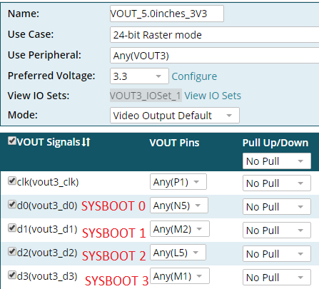

Pinmux has suggested me that I use the SYSBOOT pins for video output. I have searched for alternatives but I have not found a way not to use these pins. My question is whether we have to have some kind of design consideration in these lines shared between the VOUT and SYSBOOT.
