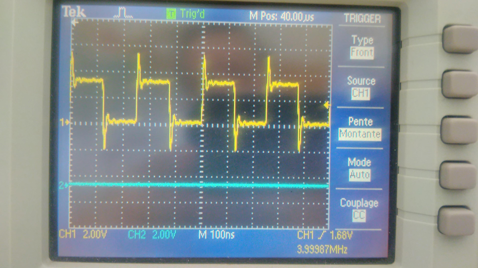

We want to output a 4 MHz clock on PR2_PRU0_CLOCKOUT. We have achieved this on an AM5728 in configuring the PRUSS_GPCFG0 register (see image below)

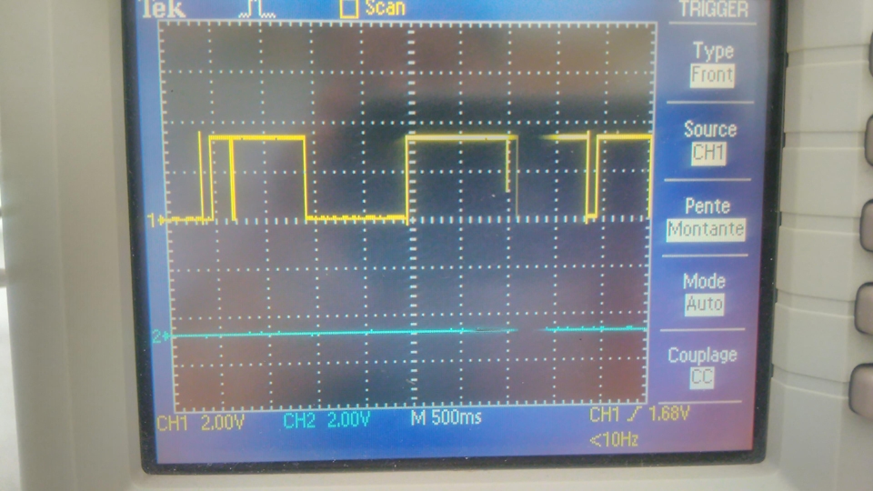

We have tried to do the same on an AM5718. However we got the following signal instead
Is there something else to do in the case of the AM5718 ? Has anybody already used this output on the AM5718 ?

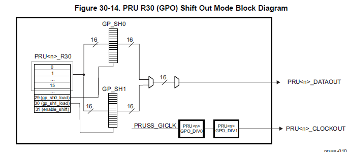

    Thank you for willing to help me. I don't think so. According to figure 30-14 (reproduced here below) of the AM5718 Technical Reference Manual,
    the output clock should be generated without setting the pin up and down by a software running on the PRU.
    Gilbert

    I have first tried to set bit 31 of R30 after having set GPO_Mode to 1, but the signal behaviour remained the same.
    Secondly, I tested the toggling of the pin with GPO_Mode set to 0. The expected square wave is visible on the
    oscilloscope trace but only for a certain time. I noticed that the same occurs with the clockout in serial output mode.
    The pin output seems to be the multiplexing of the expected signal with another slower varying signal. This
    cannot be due to a change in pinmux configuration, since our software change the pinmux only once...
    Finally, I also tried to change the processor in case it was damaged. Since I had no other AM5718 at hand, I tried
    with an AM5716 and got the same result.
    Unfortunately, I am still not understanding what is happening...
