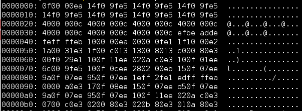

  • I suspect that this could be an issue with the boot image format. Ethernet boot uses blob boot format while SPI and NAND boot uses GP header format. Given the default uboot only supports SPI and NAND, I think that it may be in GP Header format. If you open the .bin in hex editor if you see the first two bytes as  size of the image followed by load address then it is likely to be in GP header format. b2ccs and ccs2bin are use to convert the ELF executable to blob format.
    Here is what a GP header looks like:
    Rahul
    PS: Please note that for SPI/NAND boot the GP Header could be bit reversed
    I checked the u-boot-spl.bin image in SPL directory. It doesn't look to be in GP header format.
    I checked the u-boot-spl.gph file in spl directory and I can see the header as in your picture (0001 2683 0c00 0000)  that is added to the previous image.
    Should I consider that the format I have is then the good one or should I apply any change on it?

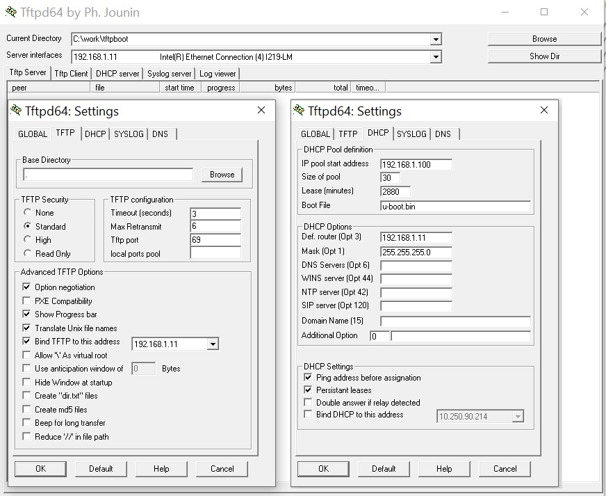

  • Hi, K. Luong,
    Sorry for my slow response.
    Yes, it works for me. I rebuilt PLSDK 6.1 u-boot to get the u-boot.bin file, and had it copied to my laptop tftp directory.  I had my K2H dip switch set to "DSP No Boot" mode. I followed instruction in "Keystone-II Boot Example" for Ethernet boot. In the BMC console, I entered
      >bootmode #8 0 115EEB
      >bootmode #8
      >reboot
    The SoC console then showed u-boot booting to u-boot prompt. The wireshark also captured the tftp transfer. I herewith attach the SoC console output and wireshark capture file. The tftp server configuration is also attached for reference.
    Rex
