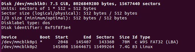

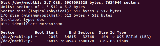

hello,
As the title explains, I'm trying to boot form EMMC memory.
for that, I have created bootable SD card.
then created two partition in EMMC
and format disk
umount /dev/mmcblk1p1; mkfs.vfat -F 16 /dev/mmcblk1p1
umount /dev/mmcblk1p2; mkfs.ext4 /dev/mmcblk1p2
which files are required in mmcblk1p1 and mmcblk1p2.
Also, guide me which procedure, I have to followed.

  • Hi andreas,
    copy whole boot directory from sd card to emmc(mmcblk1p1)
    cp MLO u-boot.img uEnv.txt /run/media/mmcblk1p1
    Same as above, copy whole rootfs directory form sd card to emmc(mmcblk1p2)
    cp -avr bin/ boot/ dev/ etc/ home/ include/ lib/ media/ mnt/ opt/ sbin/ srv/ tmp/ usr/ var/ www/ run/media/mmcblk1p2
    then after removed sd card and try to boot from emmc
    Booting from emmc is starting but after some time it will stop
    debug log:

  • Terminal Log:
    => env print bootpart
    bootpart=0:2

    And
    => mmc info
    Device: OMAP SD/MMC
    Manufacturer ID: 1b
    OEM: 534d
    Bus Speed: 48000000
    Mode : SD High Speed (50MHz)
    Rd Block Len: 512
    SD version 3.0
    High Capacity: Yes
    Capacity: 7.5 GiB
    Bus Width: 4-bit
    Erase Group Size: 512 Bytes
    => mmc list
    OMAP SD/MMC: 0 (SD)
    Still, i get same error...Booting from emmc start but kernel not start..
  • Harshad,
    In your initial post you wrote your eMMC has a size of 3.7GiB. However in U-Boot you show only have one MMC device accessible, with a size of 7.5GiB, which means that is NOT your eMMC. Looks like to make some progress you need to first get U-Boot to recognize your eMMC device in addition to your SD card. For this I would recommend to double-check your &mmc* device tree setup against arch/arm/dts/am335x-boneblack.dts (and it's hiarchy, namely am335x-bone-common.dtsi). The BeagleBone Black has an SD card slot on 'mmc1 and an eMMC connected to 'mmc2' which I suppose is similar what you have on your custom(?) board? Or are you actually using the BeagleBone Black?
    Regards, Andreas

    Output of fdisk -l
    Disk /dev/mmcblk0: 7.5 GiB, 8026849280 bytes, 15677440 sectors
    Units: sectors of 1 * 512 = 512 bytes
    Sector size (logical/physical): 512 bytes / 512 bytes
    I/O size (minimum/optimal): 512 bytes / 512 bytes
    Disklabel type: dos
    Disk identifier: 0x3202953c
    Device         Boot  Start      End  Sectors  Size Id Type
    /dev/mmcblk0p1 *      2048   145407   143360   70M  c W95 FAT32 (LBA)
    /dev/mmcblk0p2      145408 15644671 15499264  7.4G 83 Linux
    Disk /dev/mmcblk1: 3.7 GiB, 3909091328 bytes, 7634944 sectors
    Disklabel type: dos
    Disk identifier: 0x857f6ad7
    /dev/mmcblk1p1 *      2048  145407  143360   70M  e W95 FAT16 (LBA)
    /dev/mmcblk1p2      145408 7634943 7489536  3.6G 83 Linux
