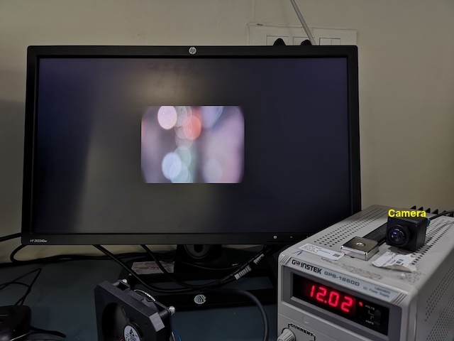

    Thanks to your pointers I've made some progress. I figured the camera output is 640x480 YUYV image. I also added vxColorConvertNode() to output RGB since display does not support YUYV. I'm getting following output now. Also, first call to vxGraphParameterDequeueDoneRef() returns but second call is blocked now. What do you suggest I look into?
    Vibhor
  • Hi Vibhor,
    That's great new.
    How many buffers are allocating and enqueueing to the capture node? Could you please use atleast 3 to 4 buffer for the capture output?
    Also please allocate 3 min buffers for color convert node output.. Display holds one buffer in itself, so 2 buffer will be tight between color convert and display node.

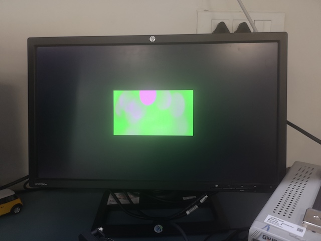

    Here's the latest update. I finally got the continuous frames going through the pipeline and showing up on display. As you suggested, it started working after using 4 to 5 buffers at each stage. I also got issue with the colors resolved. It turns out the ISP sends YVYU frames, I used vxChannelExtractNode() and vxChannelCombineNode() to convert it to UYVY and send to display. I didn't find enum for YVYU in vx_df_image_e therefore I manually swapped the order of channels in vxChannelCombineNode().
    Here's the current flow:
    YVYU from ISP ---> tivxCaptureNode() ---> VX_DF_IMAGE_YUYV ---> vxChannelExtractNode() for each channel --> Y, U, V each is VX_DF_IMAGE_U8 ---> vxChannelCombineNode(Y, V, U, NULL) Note the V and U order is swapped here ---> VX_DF_IMAGE_UYVY ---> display
    Is it possible to support YVYU in capture node and display node so that I can remove my work-around?

    Thanks for the input, setting data format to FVID2_DF_YUV422I_UYVY in tiovx\kernels_j7\hwa\capture\vx_capture_target.c and VX_DF_IMAGE_UYVY in application side worked for me. I directly sent the frames to display node without any intermediate conversion. What is the impact of this change? How will this work when we have some other camera?
    Vibhor
  • Hi Vibhor,
    Typically this component ordering is important for the YUV422 format only. In fact, i checked the driver and this variable dataFormat is primarily used for YUV422 format to know component ordering.
    I think the ISP you are using is probably not sending the YUV in matching format, we could use this functionality in CSIRx to swap the bytes. So you could keep this change when you use this ISP.
