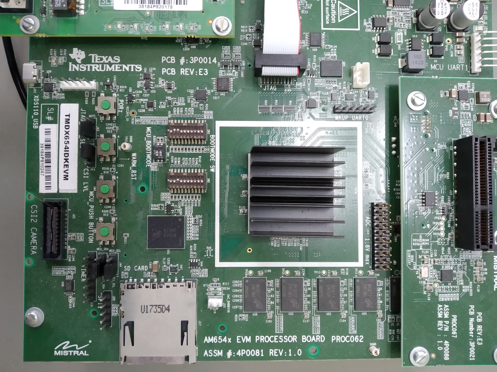

PDK - pdk_am65xx_1_0_6
AM65x (IDK) - TMDX654IDKEVM
I built EMAC test example Emac_Icssg_TestApp (in PDK 1.0.6) according to instructions in Processor SDK RTOS 06_01_00 - 6.22.7. Building EMAC Test applications via makefiles
and run it via CCS on AM65x (IDK) - TMDX654IDKEVM.
Debug configuration was created with modified launch.js as in   in PDK106.
I tried Emac_Icssg_TestApp on A53 core and I got the following output on UART:

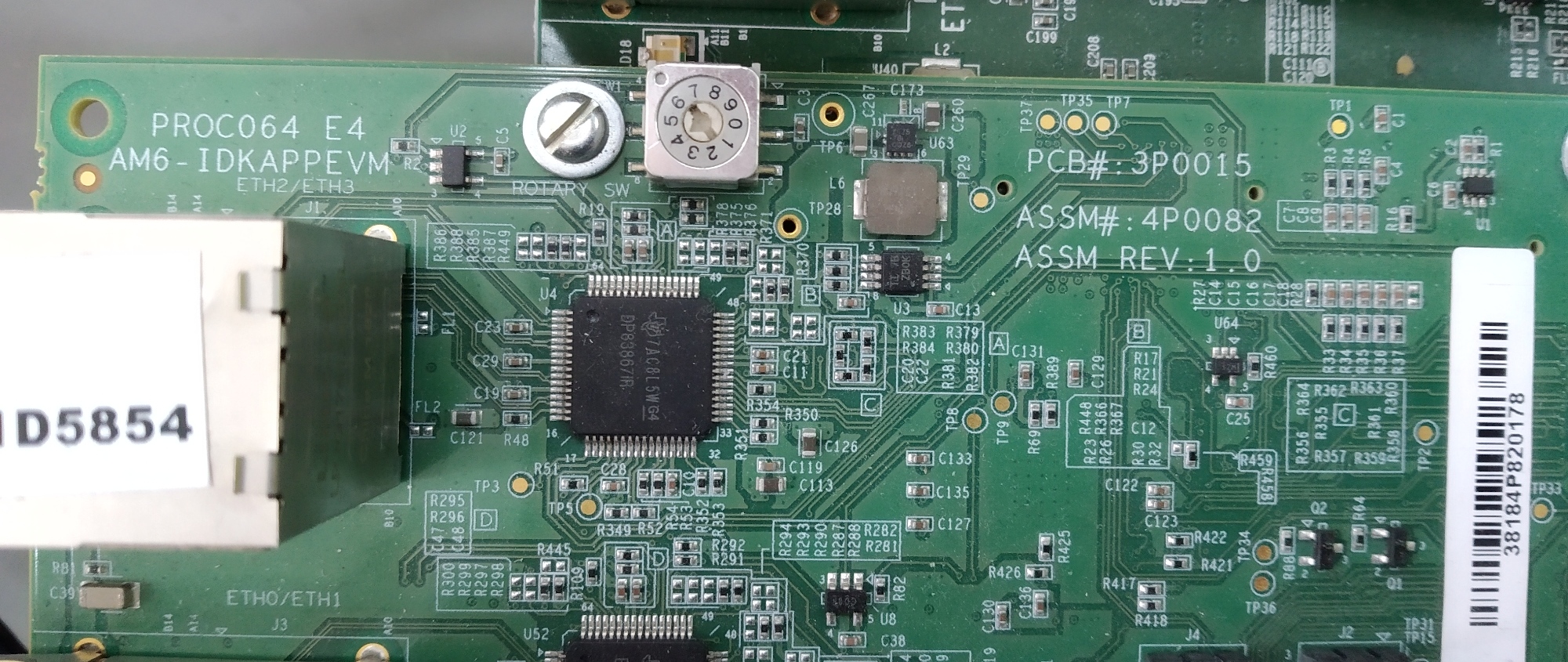

What I noticed is that when debug is launched LEDs on ETH0/1 port that indicate Link-up are turned off approximately in the moment when /am65xx/sciclient_ccs_init_mcu1_0_release.xer5f is loaded and executed.
This does not happen on PDK104.
I then modified Emac_Icssg_TestApp so that it uses only ETH2/3 port (#define EMAC_PORT_ICSS 2U in test_loc.h and uint32_t endPort = EMAC_PORT_ICSS+1; in main_am65xx.h).
With this modification application runs ok and completes the tests.
When I build the same example in PDK 1.0.4 and run it on the same AM65x (IDK) - TMDX654IDKEVM board it works fine.
I also checked Link status in debug mode and it seems that 1000Mbps FD is established via checking result in emac_icssg_update_link_params() in emac_drv_v5.c.
So I suppose that it is not an PRSDK-5544 issue with 100Mbps connection.
