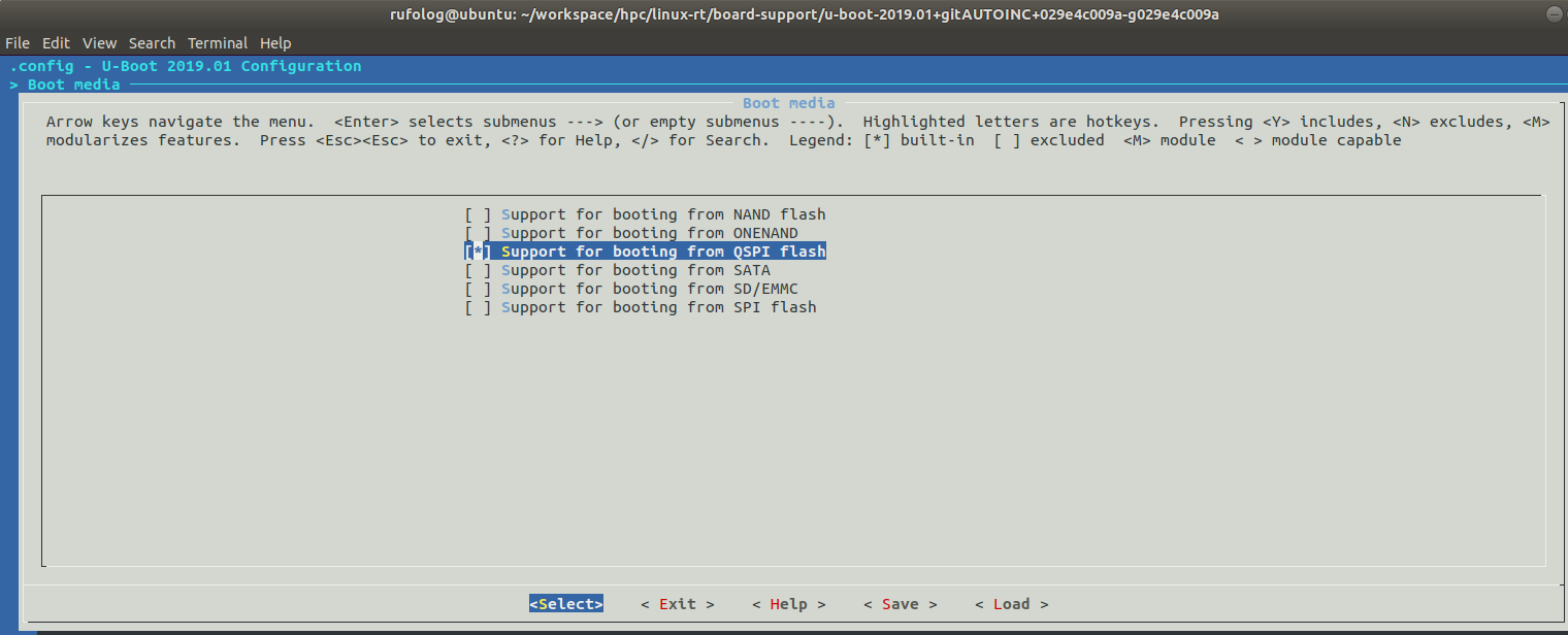

  • Hi Rex,
    in order to be sure to modify correctly the u-boot sources for my task, I have not modified the sources as described in my past messages but I have used make menuconfig. Below you can see my actions:
    But this actions produce the following errors during the u-boot build:

    Probably something shall be added/removed in menuconfig  in order to solve the issues above. Based on your experience, what are the actions to resolve the errors?
    Graziano
  • Hi, Graziano,
    Looking at the ProcSDK U-Boot User's Guide, for the DFU support, it needs to enable SPL-DFU feature. However, it is not an option kn K2G menuconfig. I suspect that is what is missing, and not supported by K2G.
    Rex
  • Rex,
    I  considered to  modify manually the u-boot sources (without using menuconfig) and in this way I restablished the situation described on the 3rd February, i.e.:

  • Hi Rex,
    Thank you for your response.
    My project does not comply mmc and nand device support, we have designed the custom board with only qspi flash as storage support and USB for first boot.
    However your example has given me the idea to change the way to proceed regarding the QSPI flash via DFU. First of all I verified that QSPI is flashed properly  via DFU in u-boot but unfortunaly the MLO and u-boot.img is not donwloaded (the .dtb yes instead). Therefore I use the DFU to download the binaries in RAM and save them in QSPI. In this way I was able to flash the QSPI.
    Below the steps to do
    in u-boot
    => env default -a;setenv dfu_alt_info ${dfu_alt_info_ram};dfu 0 ram 0
    in host PC
    # sudo dfu-util -c 1 -i 0 -a x -D y (where x is the alt partition in RAM address and y is the binary - MLO, u-boot.img, .dtb, kernel, filesystem)
    in u-boot
    => sf probe 4:0; sf write <RAM address> <QSPI offset> <byte length>
