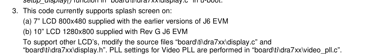

Hi team,
I came across one of the document regarding Early Splash screen on DRA7XX devices. As i was reading i came across this,
I am using HDMI port for display so what patches i have apply to get the early splash screen.

Hi Sam,
Can you provide info on the TI baseline release you are using here and also reference to the document referred here.

Hi Sam,
We only have reference patches for configurations mentioned in the application note.

Hi Gowtham,
We are working with Processor SDK Vision 3.07 and the reference document here is,sprac49(1).pdf

Hi Sam,
The application note is just a reference on how things can be done. This is not updated for every release.
As mentioned earlier we only have reference patches for configuration mentioned in the app note.
