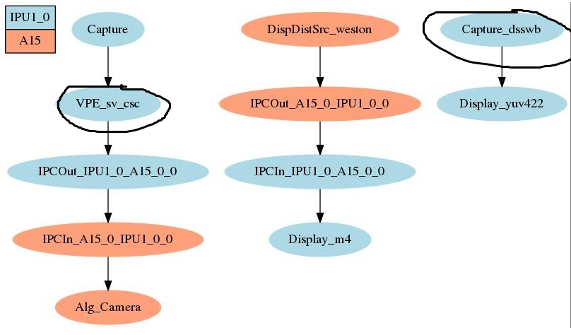

As the title said, is there any relationship between VPE and DSS?
Terence
Terence
Can you elaborate on what you mean by "relationship"? A hardware relationship or software use case of some sort?
thanks,
Alex
Hi Terence,
There is no relation between VPE and DSS. Both are independent HW modules and can work independently.
What functionality are enabled in VPE and DSS in above diagram?
Rgds,
Brijesh
Hello terence xia, we are expecting your feedback/explanation on what your use case is. Generally, you should be able to feed display output from camera. There is no direct HW link, but it is doable via software (you may try the demos in the SDK for example)

In this ticket,for more clear, I describe it again here, our problem is VPE link and DSS link can not work together, it will occur PVK error. If we remove DSS link, it will become normal.On the other hand, if we remove VPE link, also it is normal. Below is our usecase, and please find the attachment.
Hi
Error edma 43300000.edma: CCERR 0x00000001
indicates that System dma's Q0 is full and it has cross the watermakr/threshold value.
I am not sure if this is due to the impact of the l3_noc error or this itself is an issue.
