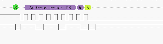

The test results for the 4 i2c buses are as follows, and you can see that both i2c0 and i2c1 were read successfully and the returned data was correct, but the i2c2 and i2c3 reads failed. Where i2c2 has an error state of LLD_HSI2C_NACK_ERR, i2c3 has an error state of LLD_HSI2C_ETIMEOUT.
 [HOST] [IPU2  ]     54.619288 s: portid is 0
 [HOST] [IPU2  ]     54.619593 s: recv data is 0xda, 0xff
 [HOST] [IPU2  ]     54.619654 s:  SetupI2C ok

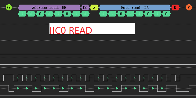

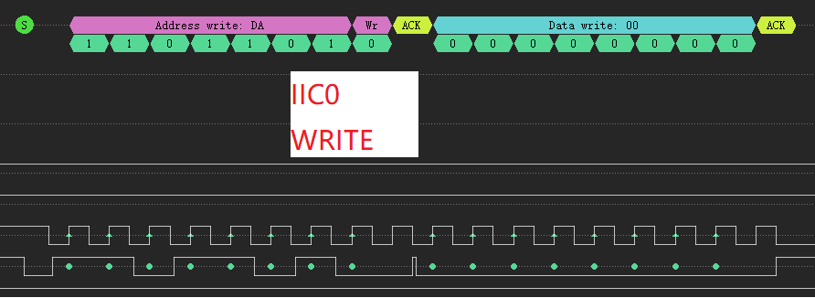

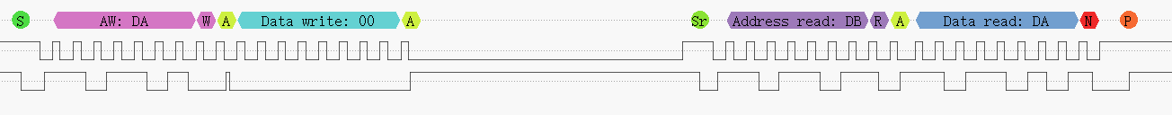

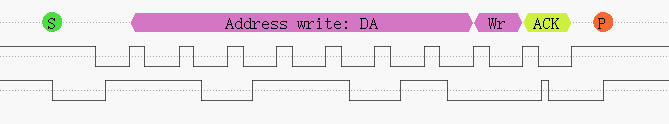

I monitored the i2c signal on the bus, where i2c0 and i2c1 write and read the signal as follows:
i2c2 and i2c3 have an error in the write register address, but from the signal point of view, after master write register address, slave has sent a ack signal, but why i2c2 will have LLD_HSI2C_NACK_ERR error?

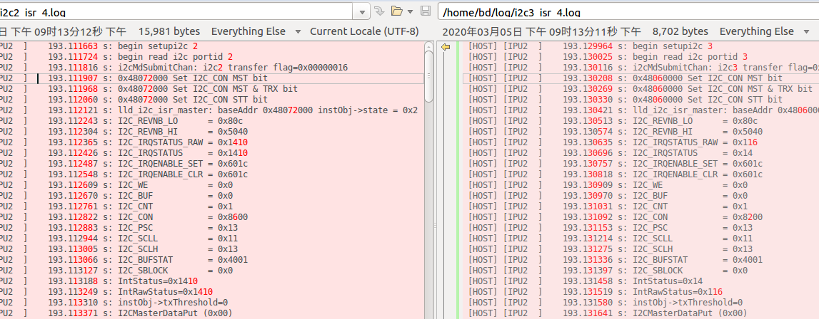

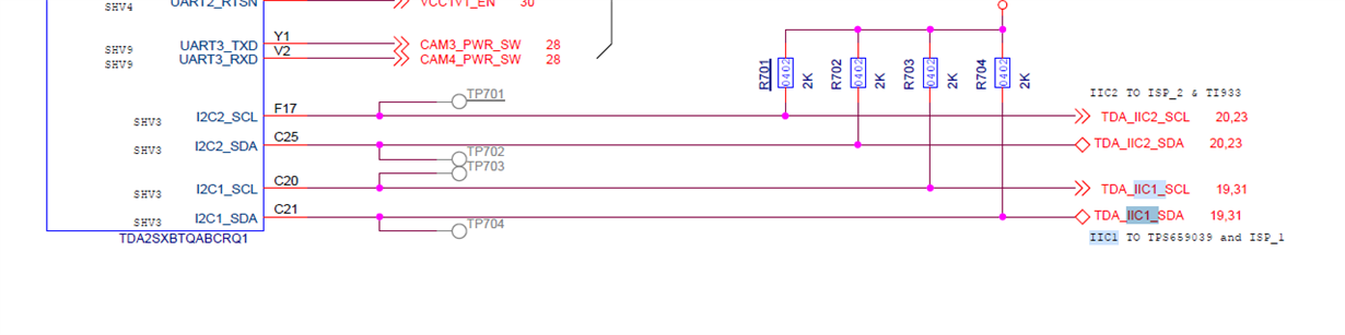

    Can you share the register dump of the I2C2 and I2C3 instance when the error happens?

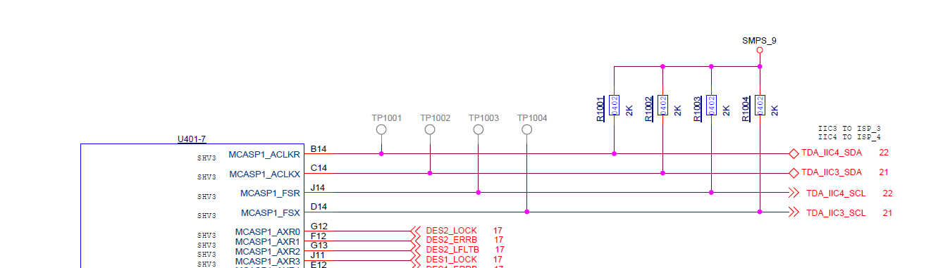

    Have you also verified the board design wrt the I2C lines like
    the pull ups connected, loading because of other devices connected on the bus etc. comparing between the 4 instances.
    Can you probe the i2c signals near to SoC?
    Prasad
  • Hi Prasad,
          Thanks for your reply.
          There are 2 devices connected on I2C2 bus, but only one device is connected on I2C3.
    When the first Isr entered by issuing the same command, both I2C_IRQSTATUS are 0x1010,
    but I2C2_IRQSTATUS_RAW = 0x1410, I2C3_IRQ_STATUS_RAW = 0x0116, the NACK bit was set,
    then I2C3 communication failed.

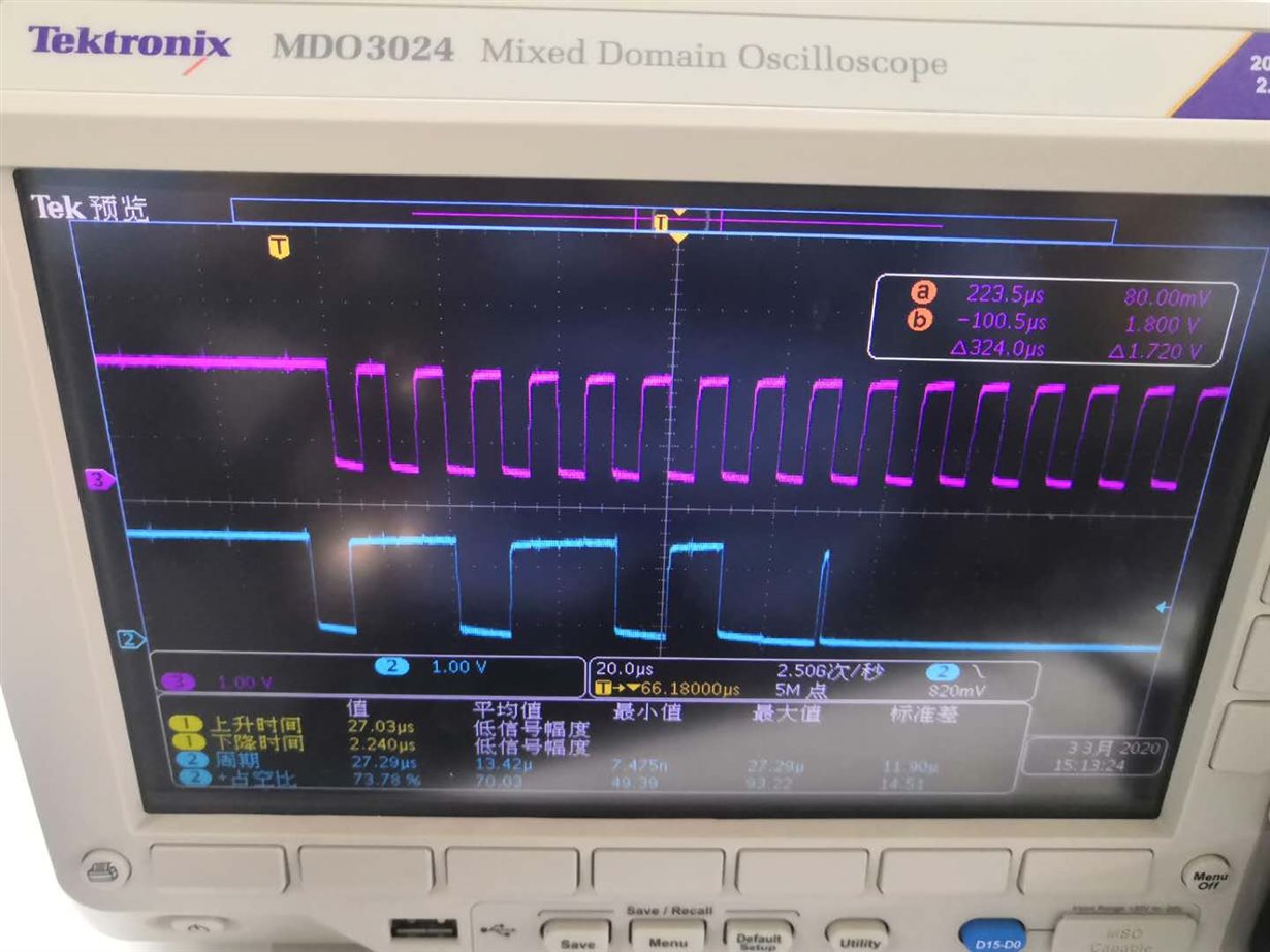

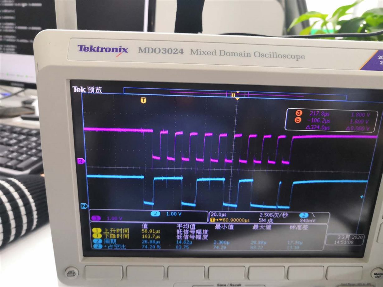

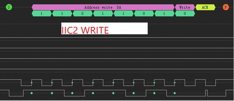

           Below are the oscillograms.
    I2C2:
    I2C3:
    Below is a compare of the registers dump:
    Please help to give some advice.
    Thanks!
    Kepei

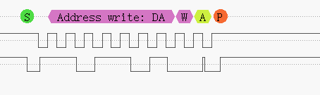

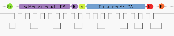

    Can you take the signal of the working case also and post.
    Do you have the i2c signal analyser which you can use instead of the scope which would be easy to analyse.
    Prasad
  • Hi Prasad,
             Below 3 pictures consist a working case of getting slave device ID.
           While the unworking case is like below:
    Thanks!

  • Hi Prasad,
          We tried to enable I2C2/3/4 on Linux side, and use "i2cget" command to communicate with the slave devices. We got the same result.
    I2C1/2 are OK, I2C3/4 are NG.
    I2C1 signal graph:
    I2C3 signal graph:
    Any idea?

  • Hi Prasad,
         Sorry for the lost graphs.
    I2C1 OK.
    I2C3 NG.
    Thanks!
    Kepei
    The Nack could be because of the Spick seen on the SDA (Going low to high) line near the clock boundary of SCL for ACK bit.
    Can you check by changing the cameras connected to the I2C3 lines and I2C1 lines.
    Prasad
