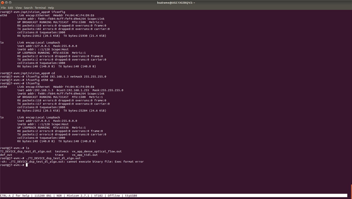

I am pretty new to TDA4EVM. I am trying to run the inference for the imported tflite model. Although I am able to import the model using TIDL Import tool, I am not able run the inference on the EVM board.
I am able to make the TI_DEVICE_dsp_test_dl_algo.out in ubuntu 18.04.
When I try to run this binary on the board, it says "Exec format error" and exits from the execution.
The screenshot is shown below.
Any thought is greatly appreciated.
Bindu
  • You are running PSDKLA and trying to launch the application from linux console
    TI_DEVICE_dsp_test_dl_algo.out is a standalone binary not to be launched by linux, and it has to be executed as documented in the user guide
    If you need to run the model as a part of the open VX framework (distributed with the SDK), please refer to the SDK user guide regarding how to import your network to openVX node
    - Subhajit
