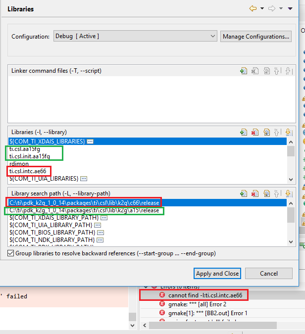

    By the way we are using the A15 core and not the DSP core. But when we tried to include the libs in the A15 folder "C:\ti\pdk_k2g_1_0_14\packages\ti\csl\lib\k2g\a15\release" the compiler accepted those libraries. (Screenshot attached).
    But however inside cache invalidation function, we commented out interrupts disabling and restoring function and finally the code was compiled.

    PS - In the attached figure, the red boxes show the libs that you mentioned in the earlier post. The lib files trigger error when they are linked in the project. The green boxes are the libs available for the A15.
    There is some mess up on A15 and DSP. All the mentioned CACHE_invL1d(), L1DIBAR, L1DIWC , L1DCFG and L1DCC, belongs to C66x DSP, they are not accessible on A15. If you are building an A15 application, those DSP functions and libraries shouldn't be there. Sorry I initially thought you were testing on C66.
    For A15, you may see TI OSAL how the cache is managed when using EDMA, depending you use TI-RTOS or baremetal:
    pdk_k2g_1_0_15\packages\ti\osal\src\tirtos\CacheP_tirtos.c
    or
    pdk_k2g_1_0_15\packages\ti\osal\arch\core\a15\CacheP_nonos.c
    Regards, Eric
