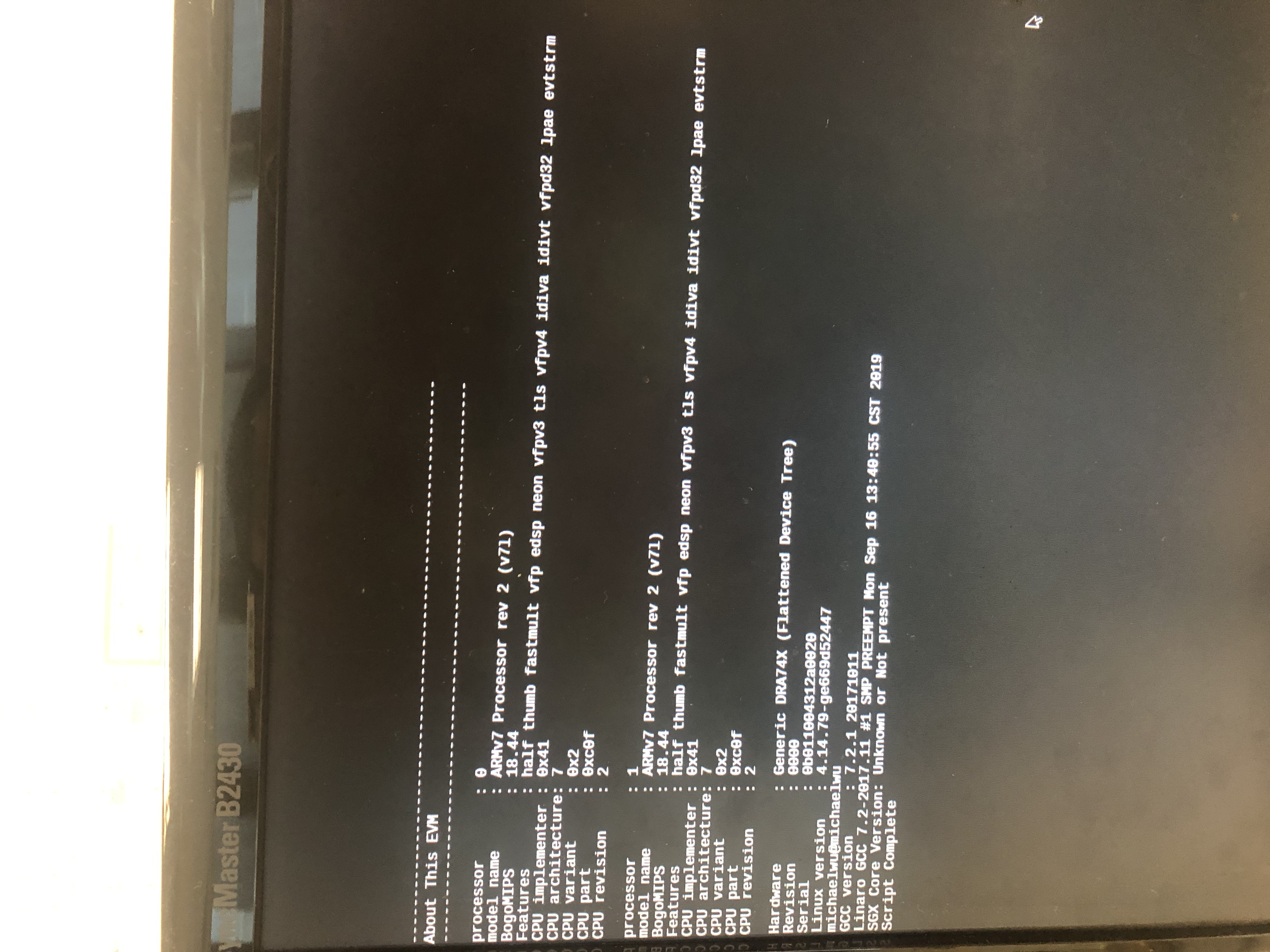

  • Hello RamPrasad,
    The SDK version is ti-processor-sdk-linux-dra7xx-evm-05.03.00.07-Linux-x86-Install.bin
    yavta --enum-formats /dev/video0
    Format 1: YUYV (56595559)
            Type: Video capture (1)
            Frame size: 176x144 (1/15, 1/30)
            Frame size: 320x240 (1/15, 1/30)
            Frame size: 640x480 (1/15, 1/30, 1/60)
            Frame size: 720x480 (1/15, 1/30)
            Frame size: 720x576 (1/15, 1/30)
            Frame size: 1024x768 (1/15, 1/30)
            Frame size: 1280x720 (1/15, 1/30)
            Frame size: 1920x1080 (1/15, 1/30)
            Frame size: 2592x1944 ()
    The System info,
    Michael
  • Hi Michael,
    Can you confirm the version of SDK?
    TI has released 4.14 based SDK v5.00.00.01 on DRA7xx devices.
    Please refer this link
    https://processors.wiki.ti.com/index.php/Category:Processor_SDK_Linux_Automotive
    TI has tested gstreamer v4l2src for VIP capture with OV10633 sensor and we didn't see any fsp issue here.
    Did you test with OV10633 sensor?
    RamPrasad
