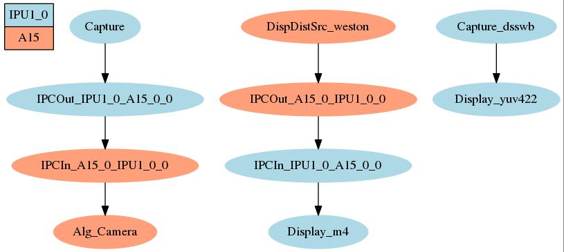

As the title said, if we enable DSP1 & DSP2, it will no output display in our usecase. But, it is normal,if only enable DSP1. Below is our usecase diagram, and please find the log in the attachment.

Hi terence,
The kernel logs you shared are not giving any details on why display is not observed.
Can you share some information like what algorithms are running on DSP2?
If you remove one of the chains (either Capture_dsswb or capture) do you see the display?
Can you also get the statistics with option 'p' ?

Hi RamPrasad,
1.We had capture the newest log in the attachment, include all cores print log, and get the statistics with option 'p'.
2.Nothing is running on DSP1&DSP2, except to the default thread of VSDK. Also you can check in the log.
3.If we remove the chains of Capture_dsswb, we can see the display.

Hi Terence,
From the log, I am seeing NEW_DATA command coming to display link. But there are two display links in your usecase.
Display_M4 and Display_yuy422. so I could not distinguish .
Can you please add some more prints in display_link like prevLinkID and linkID etc to get more information ?

Hi Terence,
The log shows there are two NEW_DATA commands received on both the display links.
Can you tell me which display is not seen?
DispDstSrcweston--> Display_M4 is a weston usecase. I guess this display is seen always. Are you able to launch weston clients?
Second chain Capture_dssWb --> Display_yuy422 . Is this being expected on a second display? and is this is not observed when DSP2 is enabled?

Hi RamPrasad,
Yes, you are right.
DispDstSrcweston--> Display_M4 is seen always. We can not see the dispaly of Capture_dssWb --> Display_yuv422, when DSP2 is enabled. While, only enable DSP1, the Display_yuy422 can output normal.
