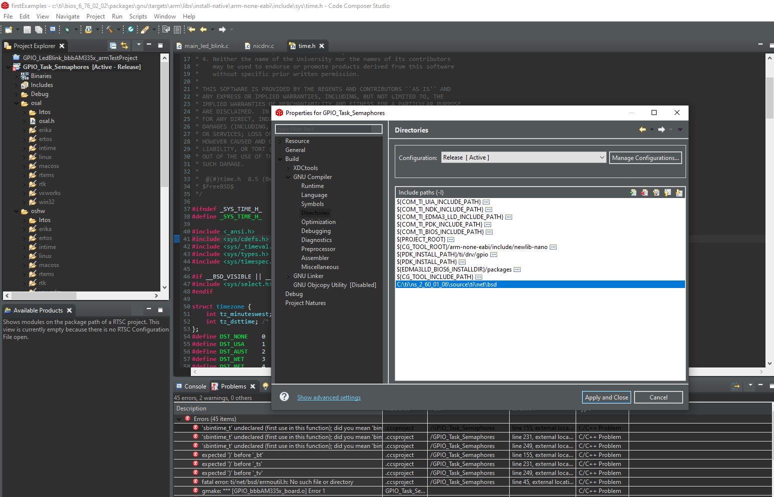

I write you since I want to create a raw ethernet socket. Folllowing NDK User's Guide at point F.1 Using BSD Sockets Provided by SlNetSock, they state to include #include <sys/socket.h>.
In order to let the compiler to find the header, I had to include the NDK path in project include Directories path "C:\ti\ns_2_60_01_06\source\ti\net\bsd" as shown in the picture below:
The problem is that I get several errors:
'sbintime_t' undeclared (first use in this function);
I kindly ask you what is the better way to include NS in a project.

  • Hi Davide,
    Some time back, the BSD support was moved from NDK to NS. What you have done should work.
    The undefined sbintime_t is probably caused by something else. In fact, the sbintime_t is defined in
    C:\ti_am3_610\bios_6_76_02_02\packages\gnu\targets\arm\libs\install-native\arm-none-eabi\include\sys\types.h or
    C:\ti_am3_610\gcc-arm-none-eabi-7-2018-q2-update\arm-none-eabi\include\sys\types.h
    Make sure you include the types.h and its path.
    Ming
  • Hello Ming,
    I could resolve that error by adding the following include directory path "C:\ti\bios_6_76_02_02\packages\gnu\targets\arm\libs\install-native\arm-none-eabi\include", however before including "C:\ti\ndk_2_26_00_08\packages\ti\ndk\inc\bsd" as explained by the guide I could include <sys/types.h> with no problem because "C:\ti_am3_610\gcc-arm-none-eabi-7-2018-q2-update\arm-none-eabi\include" was already included. It's just a little curios..
