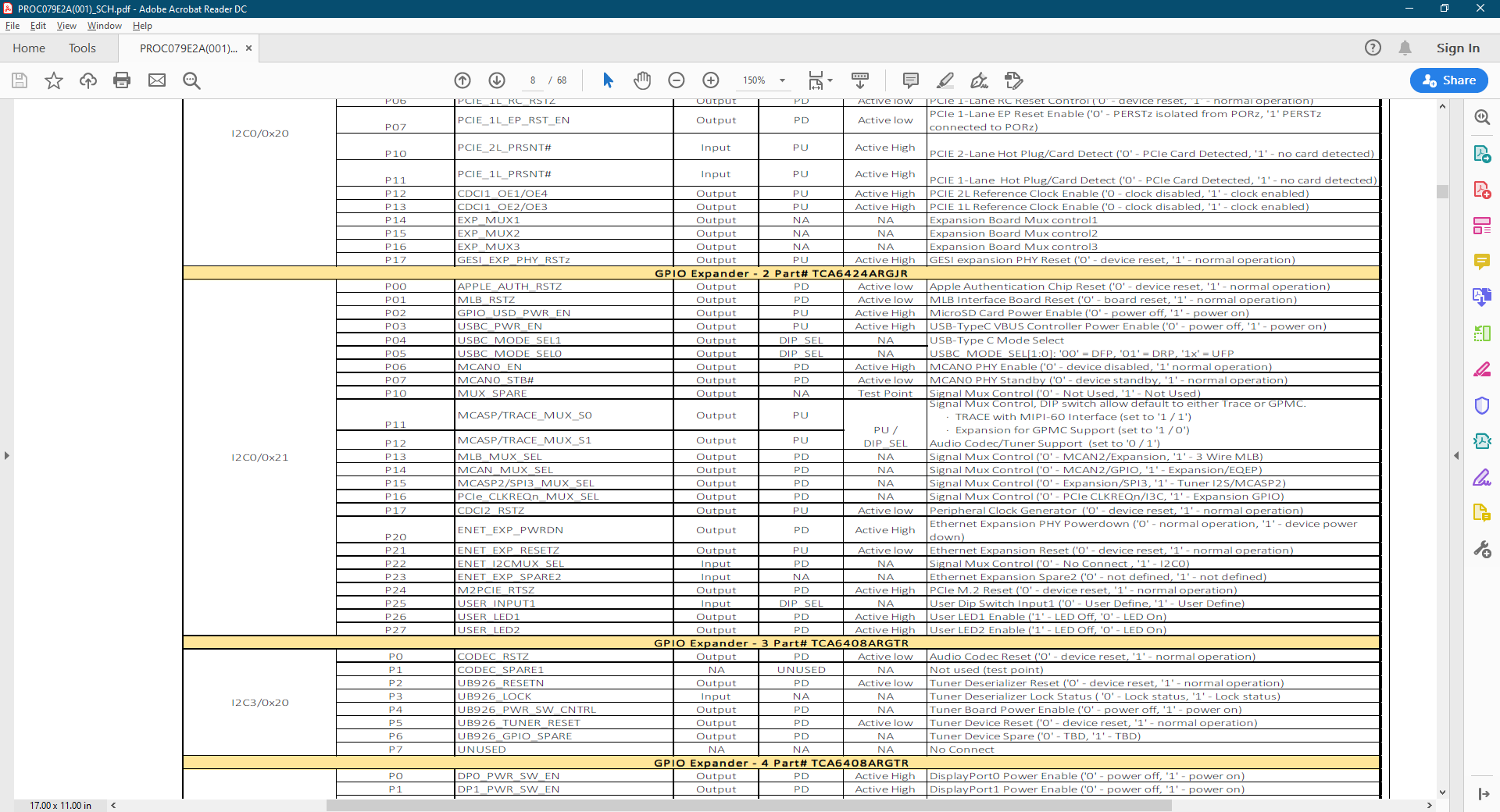

Looking at the comment at the top and the SetupI2CTransfer calls, the I2C address of the expander used here is 0x22.
However, as per the TDA4 EVM User Guide, the I2C address of this expander is 0x21.
What is the correct address?

  • Hello Vivek,
    As per the code snippet, the corresponding IO expander is TCA6424ARGJR.
    As per the schematic (please refer below), the I2C address for this expander is '0x21'.
    We ran some more experiments and found that even if we use address '0x21' or '0x23', the MCAN example works fine.
    So not really sure how this is to be configured.
    Thank you.

  • Hi Sagar,
    When you tried with '0x21' or '0x23', it is possible that default power-on configurations might be in favor of MCAN which might cause the MCAN test to pass. Can you please try to disable MCAN PHY through '0x22' and see if test fails.
