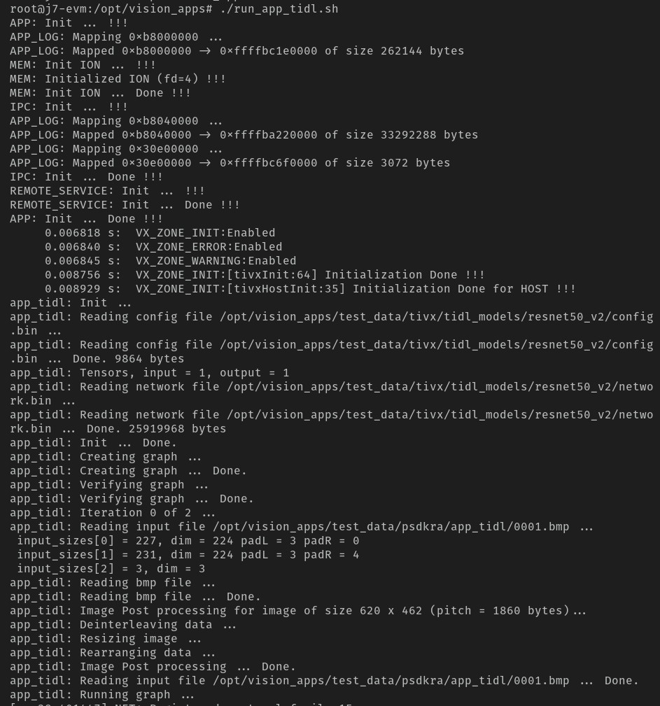

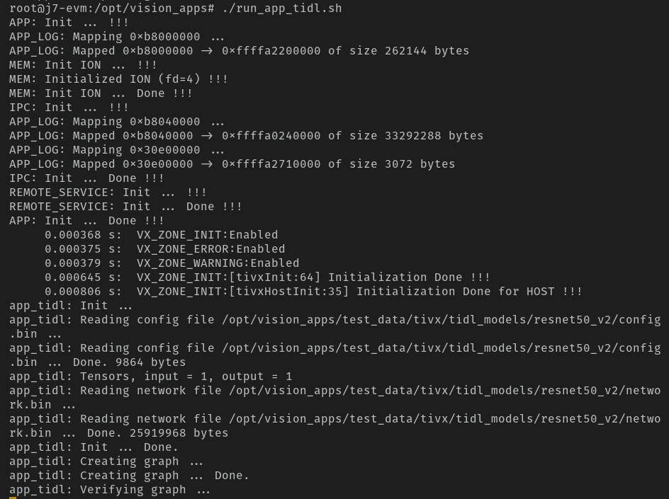

I am trying to use the app_tidl demo app to get performance and load statistics for different classification networks. I was able to run MobileNet and SqueezeNet, but when trying ResNet50 or ResNet18, the program stalls at Verifying graph step (vxVerifyGraph()) as shown in the screenshot below:
The problem occurs with all versions of ResNet: ResNet18 (ONNX), ResNet50 (Caffe), ResNet50v1 (TF) and ResNet50v2 (TF).
Then in order to avoid any possibility of implementation's bugs in vxVerifyGraph function, I commented the Verifying part in the code (main.c), and tried again and then I get the same stall but at Running Graph step this time, as shown below:
All of these ResNet networks were tested in baremetal mode, and they all worked without any problem.
