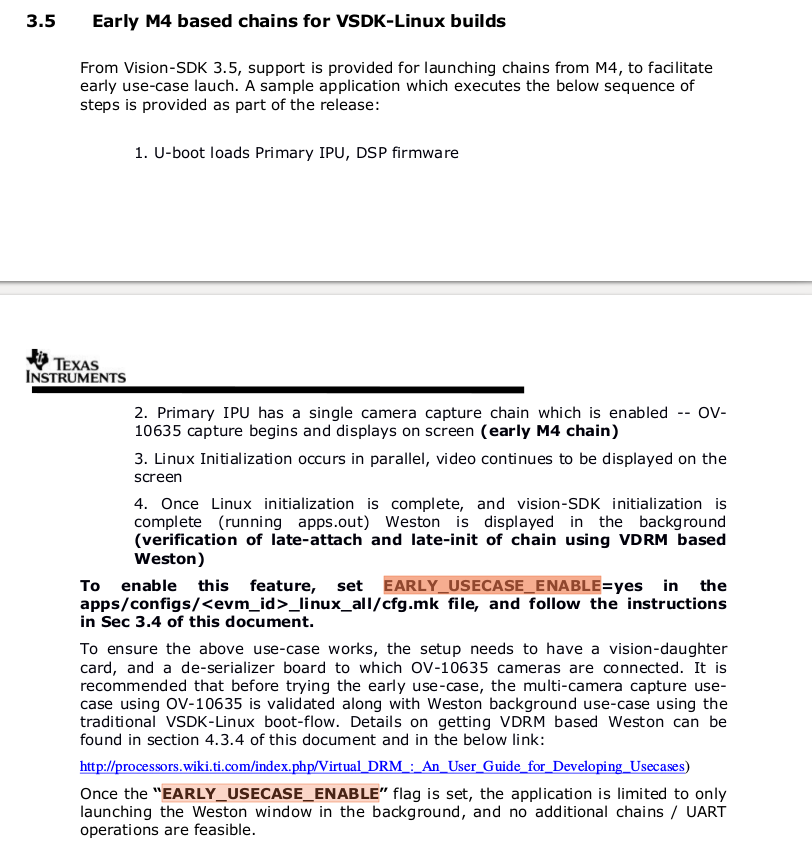

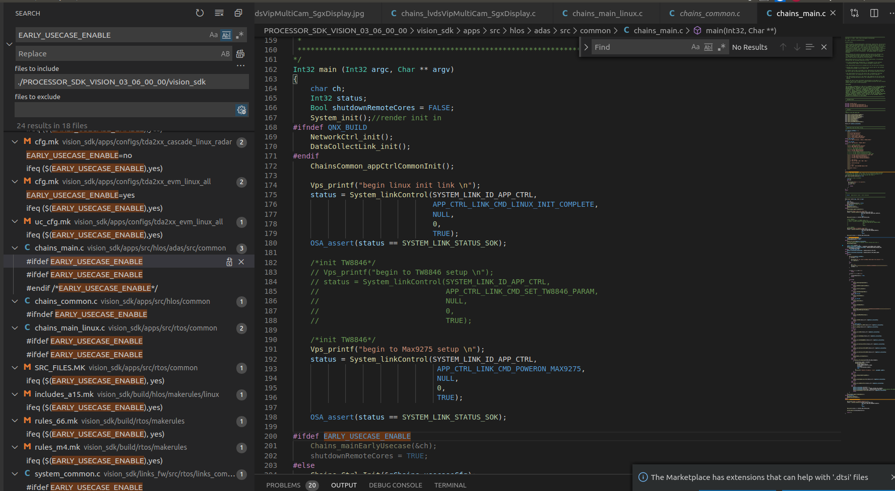

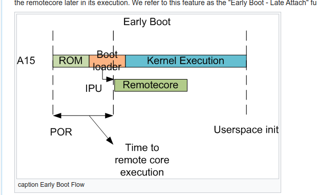

       I also try to do the early boot follow the  "Vision SDK(v03.06.00)Linux User Guide-3.4 Build Linux Vision SDK for fast boot (Early boot and late attach of remote cores)" instrutions, but it still used about 12s to get to the root login.How can I save the linux startup time effectively.The test environment is vsdk3.06,tds2x,emmc(8G).
