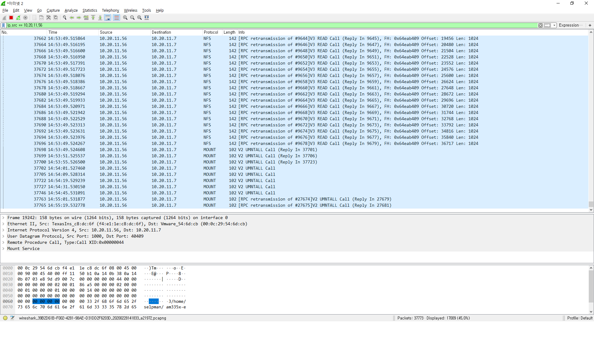

I started the boot loader with UART and downloaded the kernel image file and dtb with NFS configuration.
But, error occurs because the file system could not be found.
Question
Please suggest me how to boot the Linux using nfs
Environment is as follows
1.  Host os : Ubuntu 18.04 (Virtual machine).
2.  Connection : Ethernet direct connection of pc and processor without switch or hub.
3. SDK : am335x-evm-06.01.00.08
4. File system : tisdk-rootfs-image-am335x-evm
5. status :
NFS setting is okay
u-boot operation check
kernel image and dtb download check with wireshark
after bootz ${loadaddr} - ${fdtaddr}

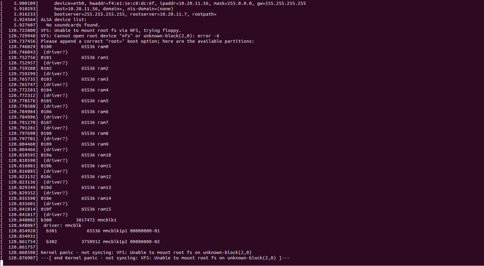

    Could you please attach a full boot log (.txt file) to a post. We need to see what is going on outside of the screen captures you have provided. Thank you.
  • Thank your reply.
    Boot log is here :
    => bootz ${loadaddr} - ${fdtaddr}
    ## Flattened Device Tree blob at 88000000
    Booting using the fdt blob at 0x88000000
    Loading Device Tree to 8df2b000, end 8df36f6c ... OK
    Starting kernel ...

    [ 1.531700] hctosys: unable to open rtc device (rtc0)
    [ 1.537325] ALSA device list:
    [ 1.540500] No soundcards found.
    [ 2.560053] [drm] Cannot find any crtc or sizes
    [ 97.763057] VFS: Unable to mount root fs via NFS, trying floppy.
    [ 97.770319] VFS: Cannot open root device "nfs" or unknown-block(2,0): error -6
    [ 97.777605] Please append a correct "root=" boot option; here are the available partitions:
    [ 97.786193] 0100 65536 ram0
    [ 97.786207] (driver?)
    [ 97.793077] 0101 65536 ram1
    [ 97.793201] (driver?)
    [ 97.799731] 0102 65536 ram2
    [ 97.799743] (driver?)
    [ 97.806122] 0103 65536 ram3
    [ 97.806133] (driver?)
    [ 97.812593] 0104 65536 ram4
    [ 97.812755] (driver?)
    [ 97.819024] 0105 65536 ram5
    [ 97.819035] (driver?)
    [ 97.825494] 0106 65536 ram6
    [ 97.825605] (driver?)
    [ 97.832051] 0107 65536 ram7
    [ 97.832056] (driver?)
    [ 97.838184] 0108 65536 ram8
    [ 97.838187] (driver?)
    [ 97.844366] 0109 65536 ram9
    [ 97.844369] (driver?)
    [ 97.850512] 010a 65536 ram10
    [ 97.850516] (driver?)
    [ 97.856729] 010b 65536 ram11
    [ 97.856732] (driver?)
    [ 97.862958] 010c 65536 ram12
    [ 97.862961] (driver?)
    [ 97.869172] 010d 65536 ram13
    [ 97.869175] (driver?)
    [ 97.875416] 010e 65536 ram14
    [ 97.875420] (driver?)
    [ 97.881646] 010f 65536 ram15
    [ 97.881649] (driver?)
    [ 97.887870] b300 3817472 mmcblk1
    [ 97.887874] driver: mmcblk
    [ 97.894727] b301 65536 mmcblk1p1 00000000-01
    [ 97.894731]
    [ 97.901568] b302 3750912 mmcblk1p2 00000000-02
    [ 97.901572]
    [ 97.908398] Kernel panic - not syncing: VFS: Unable to mount root fs on unknown-block(2,0)
    [ 97.916706] ---[ end Kernel panic - not syncing: VFS: Unable to mount root fs on unknown-block(2,0) ]---

    Please see this thread:
    https://e2e.ti.com/support/processors/f/791/t/841572?AM5728-NFS-boot-issue
    Can you check your NFS version and make sure version 3 is enabled? It might be interesting to try the full nfsvers=3 instead of just v3.
    Also, it might be good to try a full IP address spec, per the thread, for your static IP as well.
    I can't tell from the wireshark capture picture that you posted, but are you seeing activity after the dtb/kernel are transferred? What does that look like?
