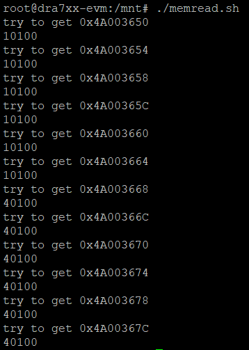

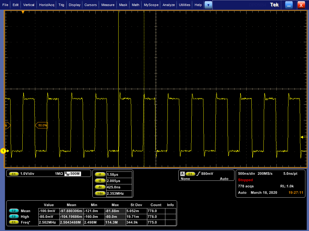

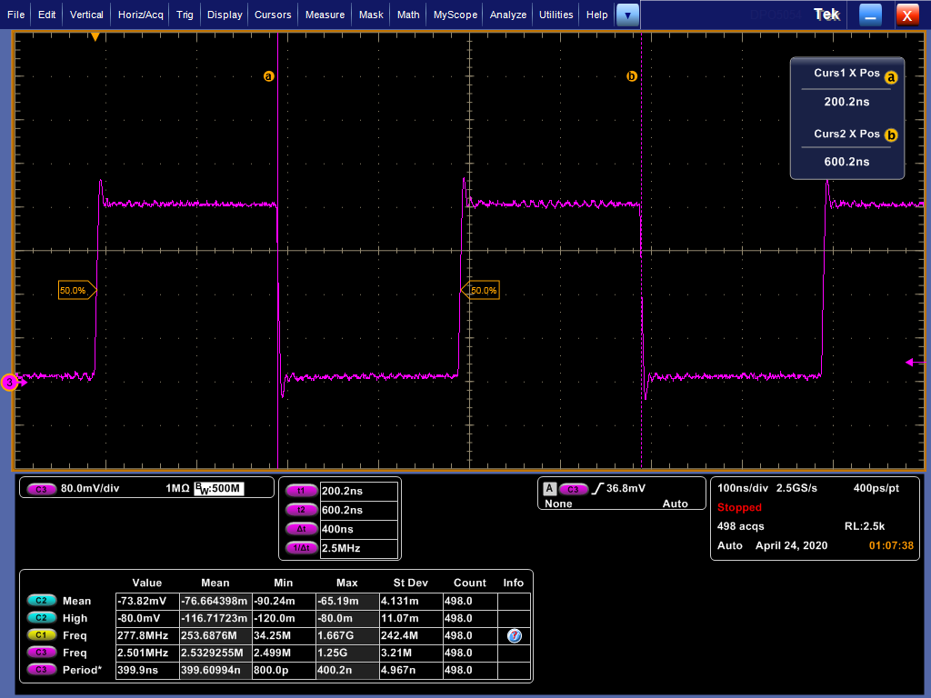

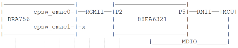

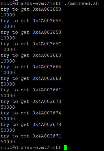

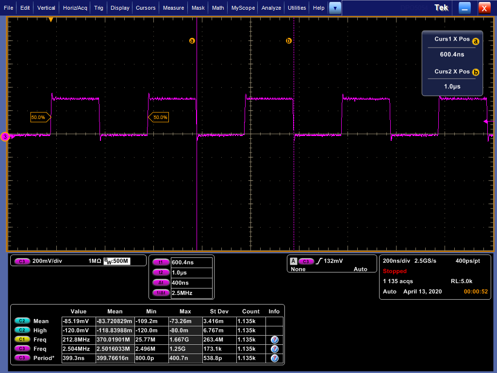

We have a customed DRA756 board and try to make its peripherals work well. Till now, all peripherals can work except for ethernet mac. For the mac, its connection is shown below:
In order to solve this, we try to locate problem. Then we found that RGMII[0]_TXC(W9) should have clock output signal during u-boot stage but not found, compared with TDA2Ex-17 Vision EVM Kit.
mux_data.h has been updated with pin mux tool. Below file is boot log of u-boot

    In these days, I check pinmux reg content in EVMX777G-01-40-00 (below 1st fig.) and customed board (below 2nd fig.), then I found GMAC related pinmux is empty. Therefore, I try to configure GMAC pinmux in u-boot or Linux dts. For u-boot, it seems we may need to modify code instead of changing dts. For Linux dts, it works at some degree.
    For Linux dts, we add below content in &mac node and &cpsw_emac0, and content of &cpsw_default and &cpsw_sleep is from dra7-evm.dts.
    &mac {
     status = "okay";
     pinctrl-names = "default", "sleep";
     pinctrl-0 = <&cpsw_default>;
     pinctrl-1 = <&cpsw_sleep>;
     dual_emac;
    &cpsw_emac0 {
        /*phy_id = ""; <&davinci_mdio>, <2>;*/
            mac-address = [ 00 00 00 00 00 0a ];
        phy-mode = "rgmii";
        dual_emac_res_vlan = <1>;
            fixed-link {
                speed = <100>;
                full-duplex;
    Then we found pinmux reg is change as below figure. Differences are from MODESELECT and weak Pull Up/Down bits. Besides, output clock of RGMII[0]_TXC(W9) is 2.5MHz shown in below oscil. figure.
    And I execute ethtool related command.

    So, there are several question:
    1 how to configure GMAC pinmux in u-boot code
    2 why pinmux still not same after using EVM pinctrl info
    3 why output clock is not 25MHz
    Hope for your reply and thanks very much.
    Daniel
  • Hi Daniel,
    Thanks for the update.
    For your questions 2 &3, can you please try changing the phy-mode in your DT entry as below:
    phy-mode = "rgmii-id";
    Santhana Bharathi.
  • Hi Santhana,
    Thanks for your support.
    I changed the dts file and double confirmed its generated dtb in TF card.
    However, freq. is still 2.5MHz and oscil. figure stiil the same. Below is ethtool related result and for your information. Thanks.

    Even though the ethtool says 100Mbps as link speed, there are chances for that not being reflected in the register configuration.
    So can you please check the values of below registers using "omapconf read <address>" from your linux terminal.
    WR_RGMII_CTL: 0x4848 5288
    SL_MACCONTROL: 0x4848 4D84
    Thank you
    Santhana Bharathi
  • Hi Santhana,
    Sorry for late reply and thanks for your suggesion. Below is read result:
    Thanks for your continued support and help. Hope for your reply.
    Daniel

  • Hi Santhana,
    Thanks for your reply and explanation. I have tried 10Mbps and 1Gbps, but the clock freq. is still 2.5MHz. Results are shown below :
    For 10Mbps, modified dts file is changed shown in below figure.
    And ethtool related result is here

    . The checked clock freq. is shown below.
    For 1Gbps, dts file is changed like this
    And ethtool result is here

    . The clock freq. figure is shown below
    Thanks for your support and hope for your reply. Thanks very much !
    Daniel

    However, TXC clock freq. is still 2.5MHz in the below figure.
    Then I'd like to open an another thread for the timing problem. Thanks very much for your great help and advices in these days. Hope you take care in the epidemic period and thanks again !
