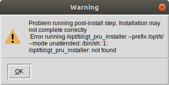

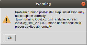

I downloaded .bin (linux executable) RTOS SDK installer from http://software-dl.ti.com/processor-sdk-rtos/esd/AM57X/latest/index_FDS.html
Towards the end of installation i got below mentioned four errors, which i could skip over to finish installation.
Now to create SD card with this RTOS SDK to boot same on beaglebone AI, i ran create-sdcard.sh file, and it failed with below mentioned error: . Could any help me know how to resolve this error? Do the errors mentioned above during installation causing this SD card creation issue? If so, how to resolve those errors?

    Apologies for the late response. The errors which you see in the dialog box are because you don't have the right CG TOOLS installed, or they are not in the right path. I am not sure if there is an option to give a custom path. I'll check this and get back to you.
