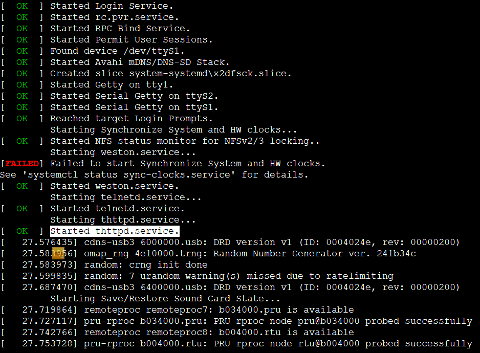

How to not let thttpd services start by default ?
We use this rootfs of tisdk-rootfs-image-j7-evm-20200304065520.rootfs.tar.xz.
Hi Allen,
can you try to run:
systemctl disable thttpd
and see if on the next boot it is disabled?
Yordan
Hi Yordan,
Thank you for your reply.
I want to know more, when we use the systemctl to enable or disable services,
where will the configuration file exist ?
After we set it up once, this configuration can be copied to multiple TDA4 platforms.
