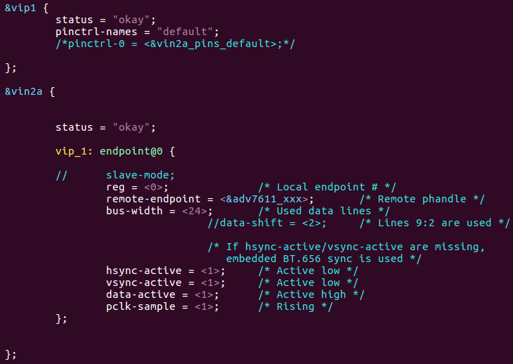

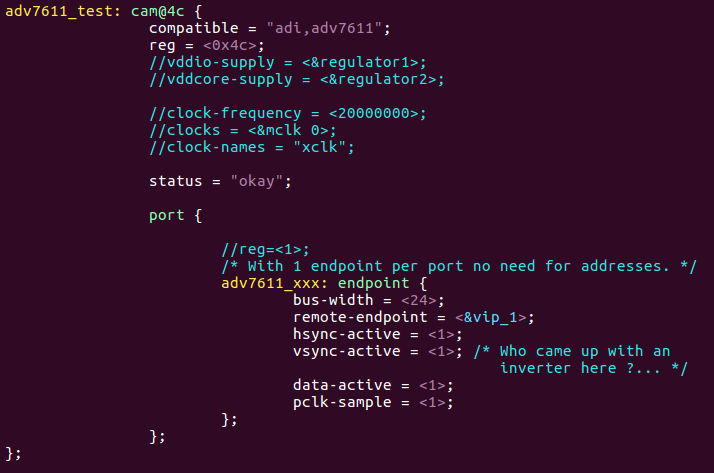

    For any new camera or video source, you should have a video subdevice driver.
    How do you control the ASIC? Is it via i2c/spi?
    If it has no control at all, you can write a platform driver, register a v4l2 subdevice and implement the required ops.
    You need to hard code the values when implementing the ops in the v4l2 subdev driver.
    And return 0 for set_stream kind of operations.
    Once you have this driver read, you can update the endpoints in VIP to point to your DT node and then VIP will call your ASIC driver and if everything is implemented correctly, video device will be registered.
    You can refer ov1063x.c for a list of v4l2 subdev ops that need to be implemented
    Also refer to https://www.ti.com/lit/an/spracd8/spracd8.pdf

    ov1063x is an i2c driver. You cannot reuse it. Better option is to write a platform driver.
    Also, being able to capture the video is last step.
    Your goals should be:
    * probe the platform driver and register a v4l2 subdevice
    * Bind it with the VIP driver using DTS endpoints and register a /dev/video device
    * Make sure you can open the /de/video device and all the subdev calls are going through, format reporting is correct
    * Finally try to do a video capture
    Nikhil D

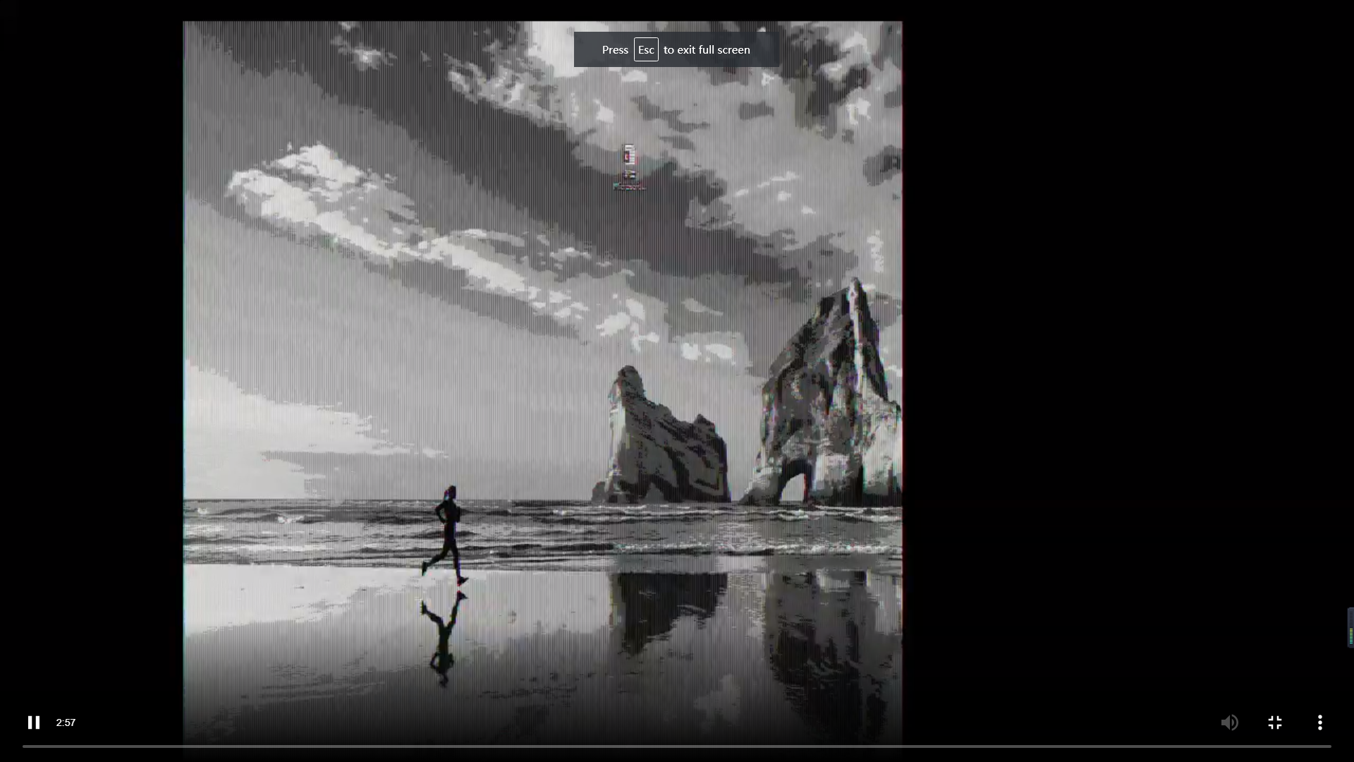

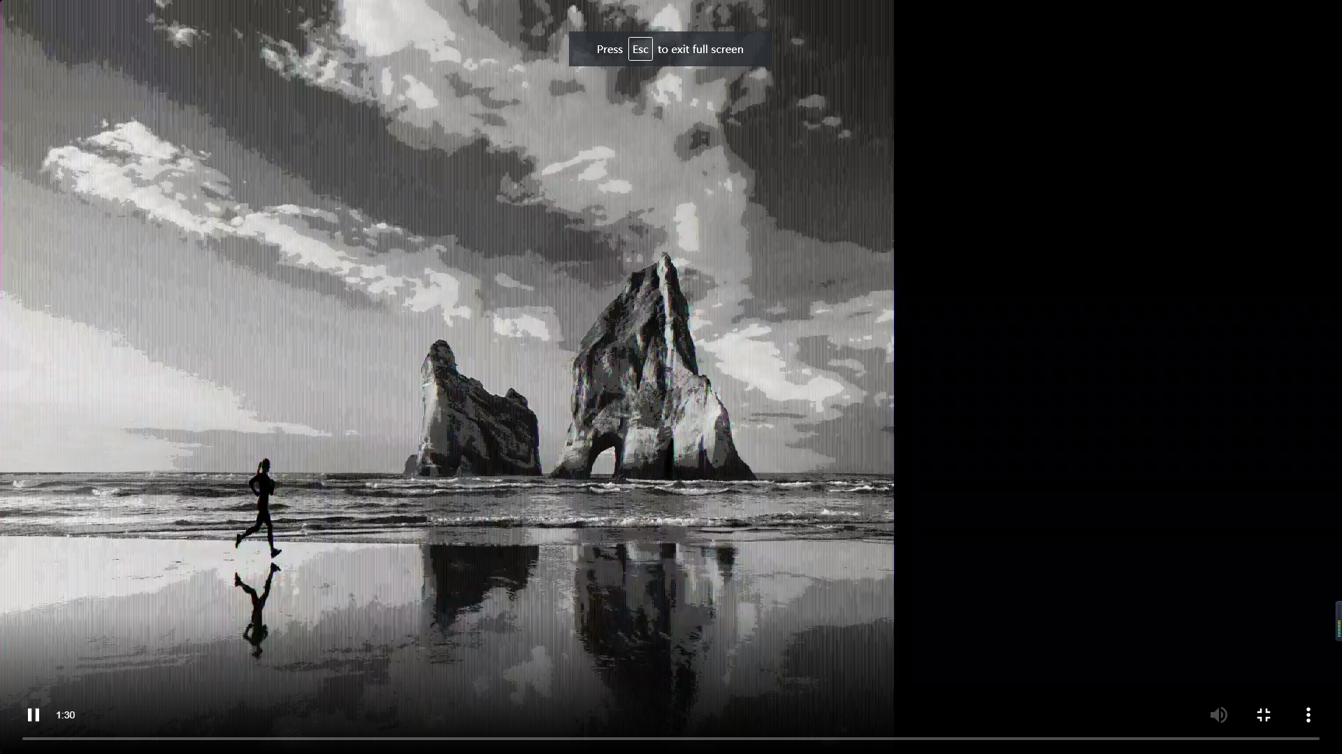

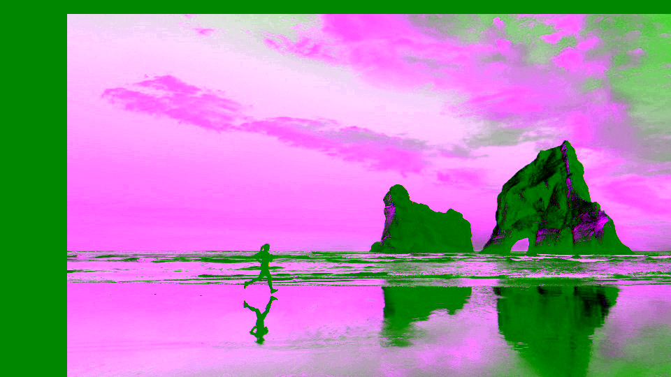

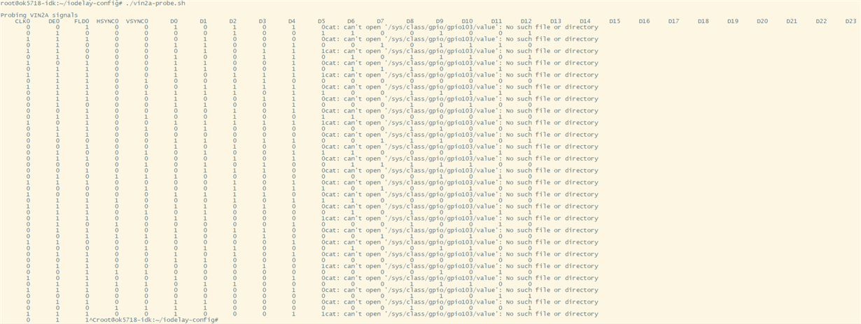

  • Hi Nikhil D.
    I just need one dummy v4l2 sub-device(pretended as IIC device), rewrite the driver is not easy for me, so choosing the ov1063x driver as start.
    I already did the following operation,
    (1). all IIC operations related with ov1063x return 0;
    (2). rewrite the v4l2 ops function;
    (3). hardcode the support resolution and colorspace;
    Is this ok to complete my wokr ?
    root@ok5718-idk:~# gst-launch-1.0 -v v4l2src io-mode=4  device=/dev/video1 ! video/x-raw ! \
    > videoconvert ! \
    > 'video/x-raw, format=(string)NV12, width=(int)640, height=(int)480, framerate=60/1' ! \
    > vpe !  \
    > ducatih264enc profile=66 rate-preset=1 ! h264parse ! video/x-h264, profile=baseline ! \
    > rtph264pay ! udpsink host=127.0.0.1 port=8004 &

  • Hi Nikhil,
    Now, I have some progress on my project.
    This is the picture got from webrtc server.
    This is the picture should be.
    Using the following command.
    gst-launch-1.0 --gst-debug=2 v4l2src device=/dev/video1 io-mode=4 ! 'video/x-raw, format=(string)RGB, width=(int)1280, height=(int)720, framerate=(fraction)60/1' ! \
    videoconvert ! \
    vpe ! 'video/x-raw, format=(string)NV12, width=(int)1280, height=(int)720, framerate=(fraction)60/1' ! \
    And generate the following warnings.
    0:00:00.212719851  1091   0x14b460 WARN          v4l2bufferpool gstv4l2bufferpool.c:748:gst_v4l2_buffer_pool_start:<v4l2src0:pool:src> Uncertain or not enough buffers, enabling copy threshold
    0:00:00.219868725  1091   0x14b460 WARN                     vpe gstvpebufferpool.c:425:gst_vpe_buffer_pool_get: Allocating a new input buffer index: 0/128, 0
    0:00:00.606932756  1091   0x14b430 WARN              bufferpool gstbufferpool.c:300:do_alloc_buffer:<vpebufferpool1> alloc function failed
    0:00:00.607128607  1091   0x14b460 WARN                     vpe gstvpebufferpool.c:425:gst_vpe_buffer_pool_get: Allocating a new input buffer index: 1/128, 1
    0:00:00.628458599  1091   0x14b430 WARN              bufferpool gstbufferpool.c:300:do_alloc_buffer:<vpebufferpool1> alloc function failed
    Can you give me some advice for this, thanks.

  • Hi Nikhil D,
    Now, my problem still not solved. Can you give me some advice?
    I use the followin command to capture the video,
    yavta -c10 -Ftest.yuv -s1920x1080 -t1/30 /dev/video1
    use the default colorspace and the colordeep.
    the following is the result:
    I have now idea about the shfit of the picture.
    Need help.
    First, you have to do the correct setting for active_video.
    This will make sure that the additional pixels/lines around the frame will not be captured.
    The OV1063x is a UYVY camera, that's why it returns the media_bus format which matches with the sensor.
    You have to make sure that the driver passes the correct format which matches with the RGB24 bit video.
    Also, the v4l2-endpoint should describe the correct bus-width to be 24bit so that VIP parser gets configured correctly.
    Nikhil D
  • Hi Nikhil D,
    For the image shift issue, it has been solved.
    I refer the thread https://e2e.ti.com/support/processors/f/791/t/773048?tisearch=e2e-quicksearch&keymatch=vip%20detect
    Do the following modifications.

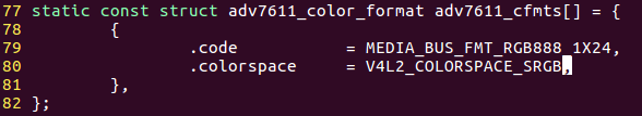

    I already set the bus width to 24bit, the following is v4l2 sub device code,
    But the output picture isn't ok, the resolution 1080P@30Hz,RGB444。
    Need help.
    Thanks.
    MEDIA_BUS_FMT_RGB888_1X24 is just the format.
    The bus width is specified in the v4l2 endpoint device tree node
    Nikhil D
  • Hi Nikhil D,
    The format is already set to MEDIA_BUS_FMT_RGB888_1X24  and the bus width set to 24bit.
    And the image I get is abnormal.
    Please refer to the above reply.
    Need help.
    Thanks.

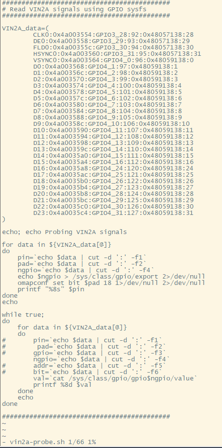

    Did you add the pinmux for the additional 16 data lines?
    Based on yout custom board scematics, add the pinmux data.
    If done already, you can generate the GPIO probe script which will read the pads to show you the status of the data lines.
    https://git.ti.com/cgit/glsdk/iodelay-config Refer to README for more details on the GPIO probe script (use the -g option)
    This will show you if some lines are toggling or not
    Nikhil D

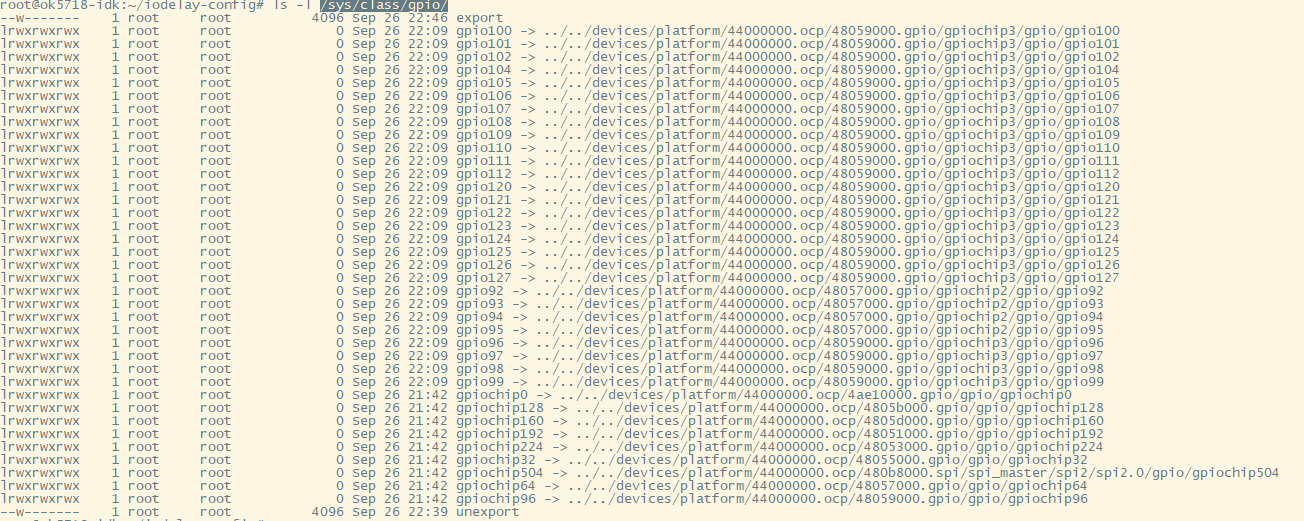

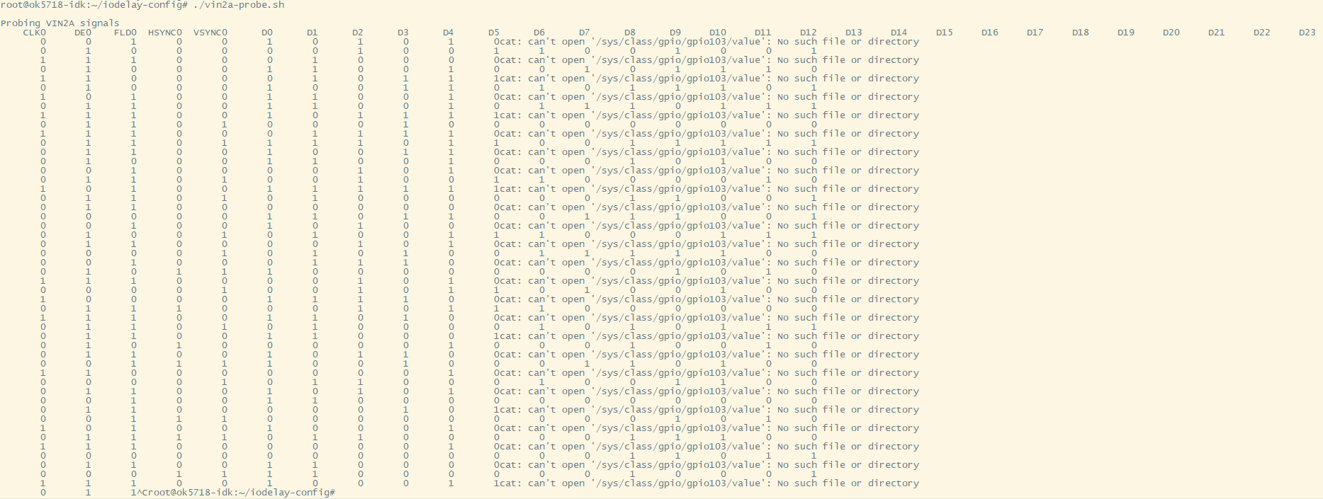

  • Hi Nikhil D.
    After using the iodelay-config, I get the following result:
    PS: Double check the /sys/class/gpio/* , except gpio103 isn't there,other gpios already exported.
    Individually checking the others pins(D13~D23), there's signal toggle.
    But the image I get still isn't ok.
