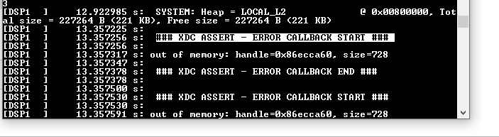

### XDC ASSERT - ERROR CALLBACK START ###
I am trying to implement hough transformation on Alpha Adas Board, and I deleted whole code, just left the dynamic allocation of memory using calloc and the program still has no memory. SDK version is VISION_SDK_02_12_01_00.

I am running Alg_Preprocessor on eve1 and edge detection on eve2 before Hough algorithm. Both Alg_Preprocessor and edge detection came implemented so I didnt wrote them. Everything is running on IPU1_0. I found mem segment file where I can manually add or substract memory for every processor and I set it like this:

There is no way that with this I cannot do one simple allocation so I need some help with this.
