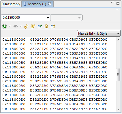

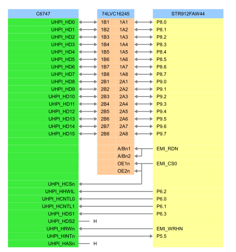

  • Hi Kyle, I've been talking with my customer to get clarification and here's a summary:
    • The host processor is a STR912FAW44. This device is not able to latch data (only address) so I had to set UHPI_HDS2n to High and to deassert /assert UHPI_HDS1n manually. I know this is a little fudge but I couldn't find another way to do it. The host is also not able to acknow UHPI_HRDYn.
    • UHPI_HCSn is driven by STR9 EMI interface. I've tried to get the control of this line and set it manually during RD/WR transfers with no success.
    • Last thing made me think  that internal HSTRBn could be asserted by UHPI_HCSn. Which, according to the HPI user's guide is not recommended.
    • Between the host and C6747 HPI there is a 74LVC16245 transceiver to separate HPI bus from STR9 external SRAM memory  Here's a little schema of this configuration:
    kcastille said:
    Is it possible that the *first* read has some issue in some logic/statemachine (maybe in an FPGA?)
    I'm afraid so but why it happens only during boot and not after application starts? I've followed your suggested sequence and I'd like to share some diagrams to get clarification:
    kcastille said:
    HPIAW = 0x11800000
    2. HPID++ = 0x03020100, 0706050403, ... , 0xFF, FE, FD, FC // 256 Bytes written
    3. HPIAW = 0x11800000 // to flush
    4. HPIAR = 0x11800000
    After performing these steps I can see next memory content of C6747:
    Which is correct! Now I've followed with next steps

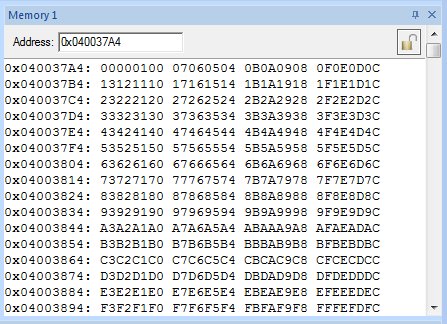

    5. Read HPID++ (64 words, 256 Bytes) w/ auto-increment  // What do you get? Is first word always wrong as before?
    Yes, same as before
    Here's the timing during last read
    It seems there's a misbehave at the first data to be read where UHPI_HRDYn holds to High and then deasserted by the chip select UHPI_HCSn (since I have no control over this line).
    I repeated next steps reading 64 and 32 word remaining data with the same results. Your last suggestion (repeat starting from reset with HPIAW=0x11800100) has a worse outcome: The first 4 read bytes are zero. However contiguous data are ok.
    Well, I'll try to think more about all this. Please, let me know if you have any ideas.
    Gaston
  • Gaston,
    It's illegal to deassert the HSTROBE (effectively HCS in your diagram) while HRDY is 'not ready'.  When does the host latch read response data?  It may be that you're latching the data before it has been fetched and placed on the bus by the HPI.  In general, the very first HPI read access takes longer since the internal bus request has to flow through the SoC.  This is reflected by the HRDY signal.
    To visually verify this, try using a data pattern that sets HD12 (by setting bit 12 and 28 in the memory pattern) so that you can see HD12 transition from 0 to 1 on your waveform.
    I'm not quite sure why it works during run time but fails at boot.  One explanation may be that if you're always reading linear addresses, it's only the very first read that has a 'not ready' condition.  After that, the internal FIFO prefetching that the UHPI performs may provide data to the local FIFO such that any subsequent read by the host is able to read directly from the FIFO.  At run-time, are you reprogramming the HPIAW and HPIAR to access (effectively) random locations, or do accesses always proceed linearly?  My guess is that if you reinitialize HPIAW/HPIAR at a later point in time after system boot you'll see the same failure.
    If at all possible, you should investigate means to have your host extend it's data access timing dependent on the HRDY signal.
    If your host doesn't have a 'ready' signal to control the bus timing then you have two (fairly bad) choices:
    1) Make your host strobes slow/wide enough such that you *never* violate the HRDY timing requirement even though you don't have HRDY.  This is dangerous since internal DMA/bus loading will make the HRDY timing variable and new system conditions may lead to cases where the timing is violated.
    2) Write to the HPIC.FETCH bit to preload the read fifo.  Then read from HPID after the FIFO is preloaded.  Even this suggestion is problematic as you don't really know when the internal read FIFO has been preloaded.  As in point #1, If you wait long enough it should work, but that timing may change as system conditions change.
    Not a great answer, but I hope this helps.
    Kyle
