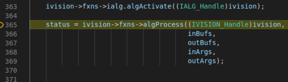

  • Hi Shyam:
    Sorry about I click the wrong button, may you cancel the resolved?
    I found that the crash is happened at tivx_alg_vision.c:365.
    Then, I can't go into this function.
    Also, can't exactly tell you where the problem is occurred.
    The "crash" is meaning the "segmentation fault"
    Thanks and Regards,
    Ted
  • Hi Ted,
    Can you please also confirm that you have initialized this call-back function pointer and ensured that your function signature matches the one below?
    /* defined in itidl_ti.h*/
    typedef struct {
      /** Call back Function pointer to Custom Layer Process API */
      int32_t (*TIDL_CustomLayerProcess)(sTIDL_Layer_t *tidlLayer,
                                         void *inPtrs[],
                                         void *outPtrs[],
                                         void *params,
                                         void *udmaDrvObj,
                                         int32_t tensorStats);
    TIDL_CreateParams;
    And make sure you initialize the function pointer in setCreateParams function in app_tidl/main.c file
            if (VX_SUCCESS == status)
                if(createParams_buffer)
                    TIDL_CreateParams *prms = createParams_buffer;
                    TIDL_createParamsInit(prms);
                    prms->isInbufsPaded                 = 1;
                    prms->quantRangeExpansionFactor     = 1.0;
                    prms->quantRangeUpdateFactor        = 0.0;
    #ifdef APP_TIDL_TRACE_DUMP
                    prms->traceLogLevel                 = 1;
                    prms->traceWriteLevel               = 1;
    #else
                    prms->traceLogLevel                 = 0;
                    prms->traceWriteLevel               = 0;
    #endif
                    /* Initialize callback function pointer here */
                    /* prms->TIDL_CustomLayerProcess = <custom layer function> */
                else
                    printf("app_tidl: ERROR: Unable to allocate memory for create time params! %d bytes\n", capacity);
                vxUnmapUserDataObject(createParams, map_id);
    Shyam
  • Hi Shyam:
    Thanks for your help.
    It works !
    Thanks and Regards,
    Ted
