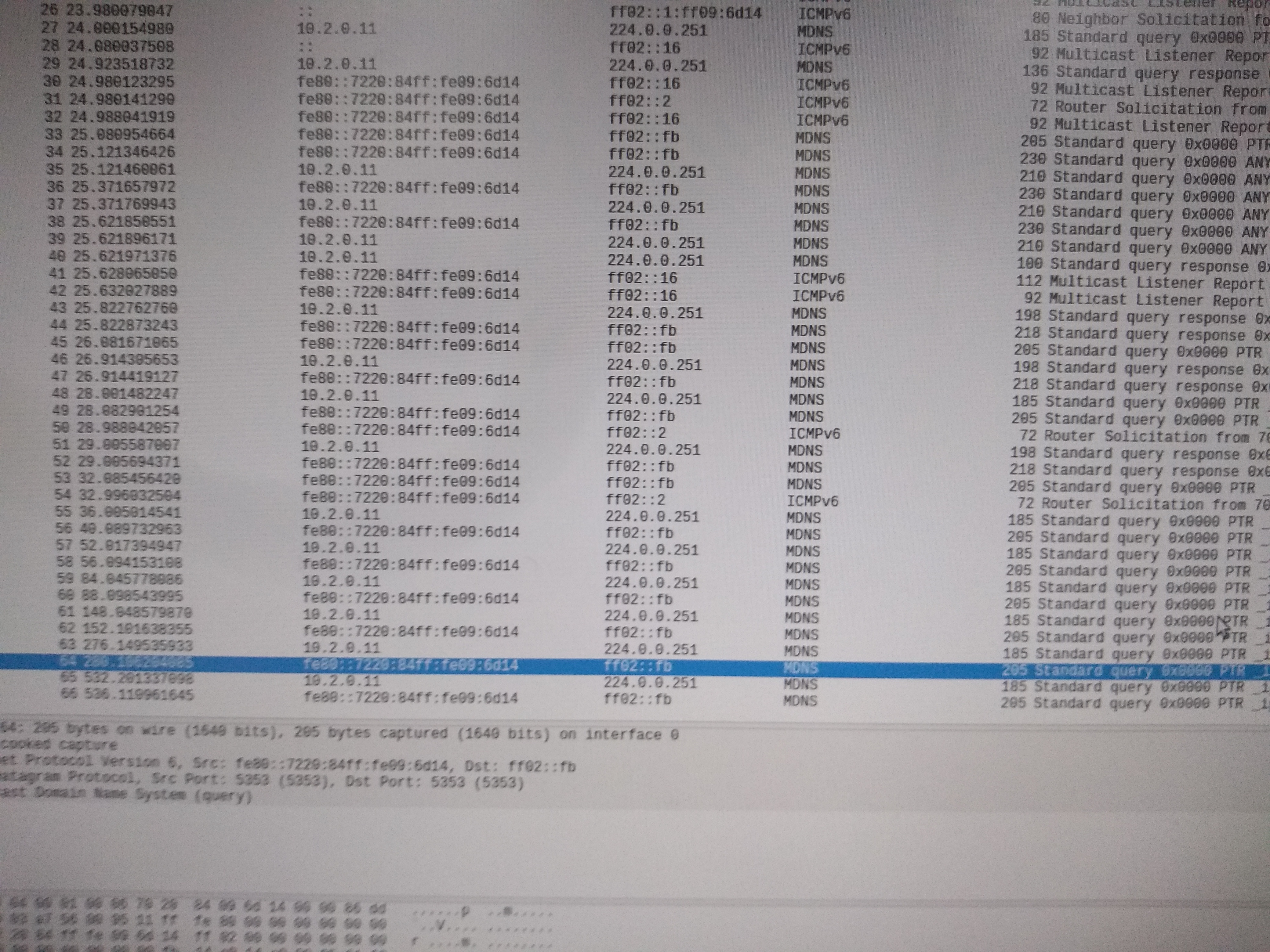

Hi all,
I have configued the TI ndk stack to get the  udp packets from ecu that is running tda2px.
The ecu is sending the data through ethernet that i can verify by seeing the logs on teraterm
I am not seeing the UDP packets in wireshark on linux pc that is connected to the ecu using ethernet cable.
Both in NDK  and linux machine i am configuring static ip.Please see the packets i am seeing in wireshark.
Please find the NDK configuration below and also the wiresahrk image attached.
My doubts are:
a) If we have to do some configuration on the NDK side to get UDP packets.
b) If i am seeing MDNS packets instead of UDP packets what does that verify ,does it
indicate that ecu is sending data to pc.

    I have tried to debug my application.On the ecu side sendto is working on.On server side(linux machine) i am getting connection established.
    But i am not able to ping the ecu and also i am not able to see the UDP packets in wiresahrk.On ecu side the application is sending some algorithm data over the
    network.With the packets that i am getting in the image above what can i conclude about the ndk stack,is it working or not or if i am missing any configuration on ndk.
    I have posted my ndk configuration also and i dont think there is any issue in ndk configuration.
    If someone can tell whether NDK is working or how i can is ee udp packets in wireshark on linux machine.
    Mayank
  • Mayank,
    Do any of the packets in Wireshark have EVM's MAC address as source MAC address? The MAC address of the EVM is typically printed when application starts.
    Your NDK config settings seem correct to me. They match the configuration in our example applications.
