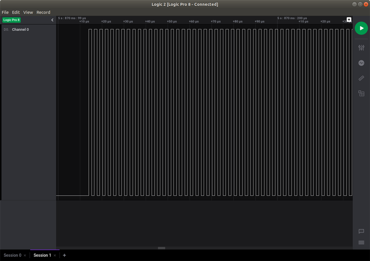

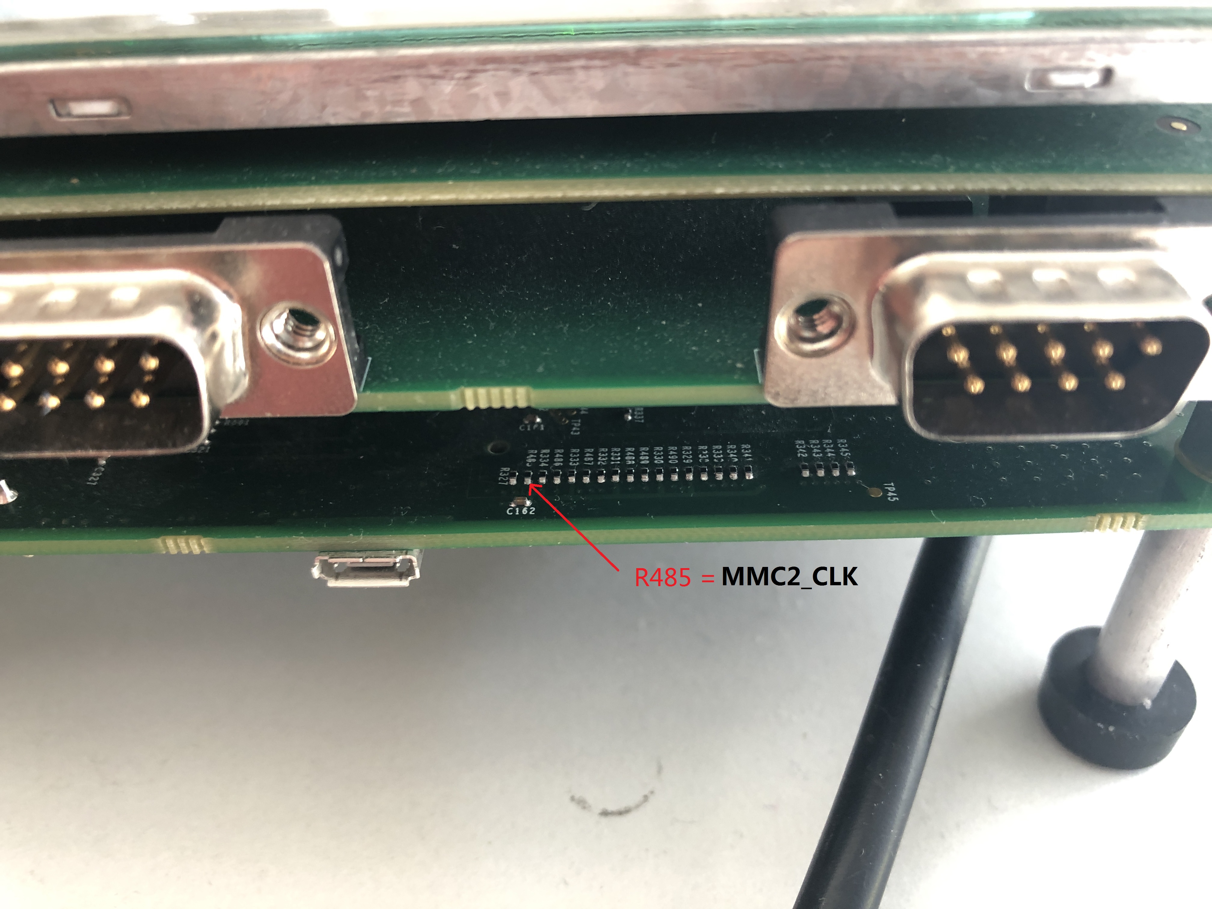

Hi There,
I want to use MMC3 as SDIO interface for WiFi module.The processor SDK 05.03.00.07 is downloaded and run it on AM335x GP EVM.
Unfortunately after successful booting, I can't see MMC3 detected via dmesg. Then I go to am335x-evm.dts, do the following changes:
wlan_en_reg: fixedregulator2 {
        compatible = "regulator-fixed";
        regulator-name = "wlan-en-regulator";
        regulator-min-microvolt = <1800000>;
        regulator-max-microvolt = <1800000>;
        /* WLAN_EN GPIO for this board - Bank1, pin16 */
        gpio = <&gpio1 16 1>;      <---- change value from 0 to 1
        /* WLAN card specific delay */
        startup-delay-us = <70000>;
        /* enable-active-high; */  <---- comment out this line
All the rest parts of this dts file are kept unchanged.  Following the results of dmesg | grep mmc

As you can see no mmc3 is detected. Running ls /sys/bus/sdio/devices, there is no any sdio device appears. What could be the reason?
Any configuration missing? The complete boot log is attached.I need your help, Thanks
Xi

  • Hi Andreas,
    thanks for the advise. Would you please tell me which clock frquency is used for MMC3? I can't find the value in dts file.
    And where can I configure the MMC3 clock frequency?
    Anton
  • Anton,
    It is usually negotiated between the host controller and the MMC/SDIO device during probe depending on mutual capabilities (there is a way to turn on debug prints in the Kernel via CONFIG to get more verbose into), unless set specifically...
    Just add something like max-frequency = <2500000>; to the respective device tree node, see here for an example: https://git.ti.com/cgit/processor-sdk/processor-sdk-linux/tree/arch/arm/boot/dts/dra7.dtsi?h=processor-sdk-linux-4.19.y#n1157
    Regards, Andreas
  • Andreas,
    I insert a MMC card (8GB)) into MMC3 slot (bottom of daughter board), the bootable MMC card is in the MMC1 slot (bottom of base board). Profile 1 is chosen. The image is from TI SDK 05.03.00.07. After scuccessful boot I still can't see the MMC3 recoginzed in the boot log. Following I list the dmesg | grep mmc messages.
    Would you please do me a favour,  just put a MMC card into the MMC3 slot on your EVM to see if you can see the MMC3 slot recognized using SDK 05.03.00.07 ?  Maybe I missed some settings, so if you can
    do the reference booting it would be very helpful for me. Thank you

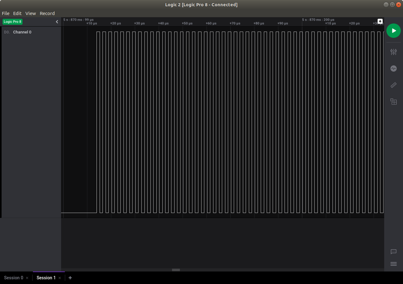

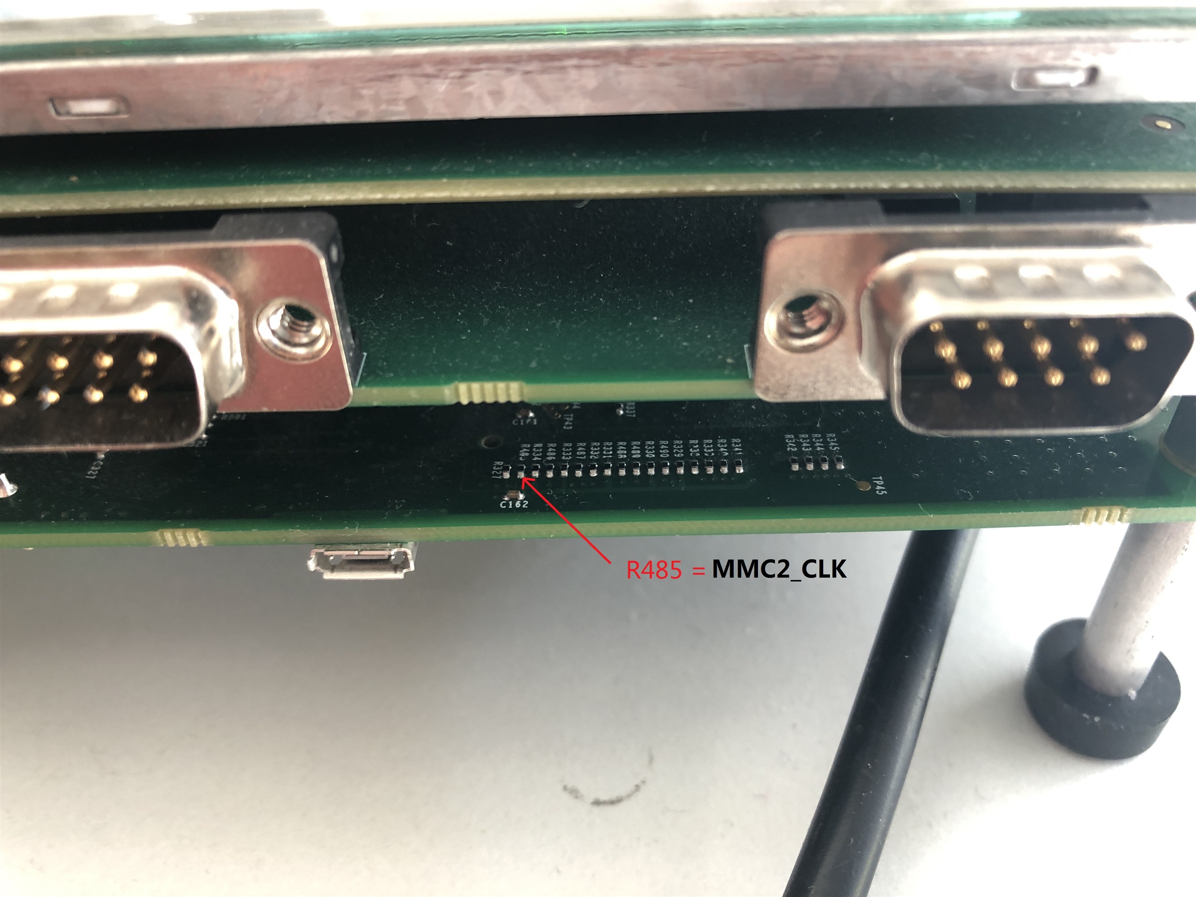

  • Hi Andreas,
    I measured the MMC2_CLK (at R485) and MMC2_CMD (at R486), but no any signal can be observed during the whole boot up process.
    Addtionally I also measured the DC voltage, at R485 the voltage is Zero and at R486, R487, R488, R489, R490 it is as expected 1.8V.  Following the picture showing where I did the measurement
    Question 1: What could be the reason that no MMC2_CLK signal on the COM connector?  Would you please check it on your side if you have the same results?
    In the file am335x_evm_gpdaughterboard_3h0001_bottomassembly_rev1_1A.pdf, I see the MMC2 (the 3rd device MMC interface) as the following
    Question 2: Why here in the PCB layout of the daughter board bootom side it is SDMMC1, not MMC2?  Just a name mismatching?
    Best Regards
    Anton

  • Anton,
    I just tried it, using an unmodified Linux SDK image from the AM335x Linux SDK v06.01.00.08 as created with the included SD card creation script, and I can see a 400kHz clock on MMC2_CLK from the host driver's probe attempts, see attached screenshot, measured via R485 using a logic analyzer. The reason there is no associated output in the Kernel message log is that the MMC commands that are sent go unanswered, hence the device driver never gets to the stage trying to match SDIO vendor and device IDs (after which an actual WiFi driver would get probed for example).
    I also enabled additional debug prints in the omap_hsmmc driver, and saw various CMDx getting issued, which corresponds with the CLK signal activity that was observed. For example...
