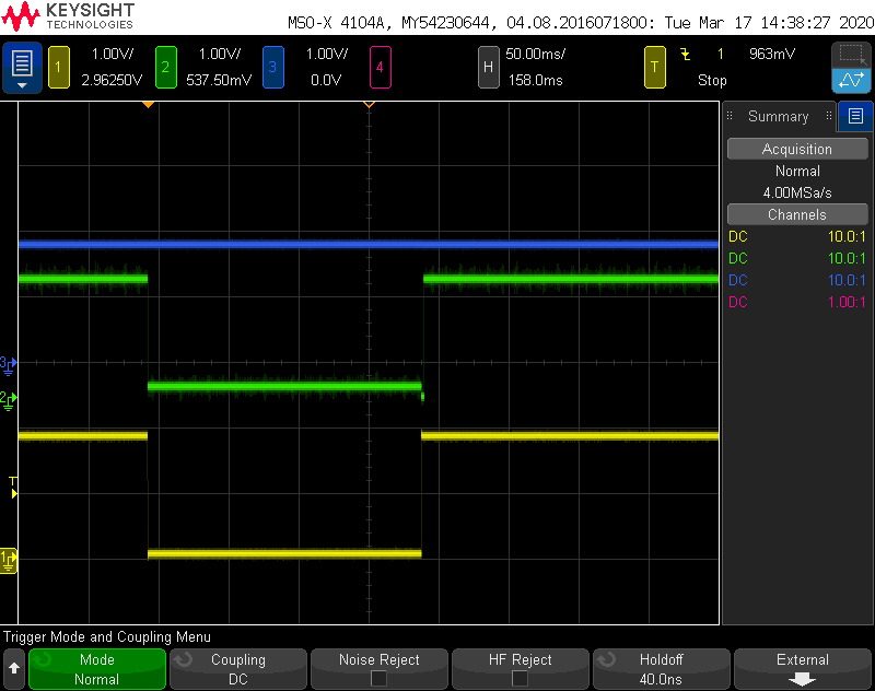

  • Working condition. Applying Reset via SW6 in schematics (B_CPU_POR_RESETn)
    1. Blue for RESETn
    2. Green for RESETOUTn
    3. Yellow for PORZ
    RESETOUTn going High -Z can be observed.

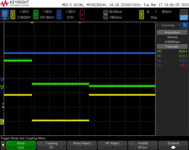

  • Non Working condition (After loading FPGA). Applying Reset via SW6 in schematics (B_CPU_POR_RESETn)
    1. Blue for RESETn
    3. Yellow for PORZ

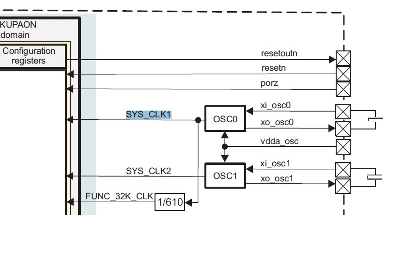

    In TRM i could find the following
    All PRM reset outputs are asynchronously asserted, while the deassertion is synchronous to the
    SYS_CLK1 clock. The reset managers in PRM use this clock to stall, or delay, deassertion of reset upon
    source deactivation.
    So is guess RESETOUTn will be asserted on PORZ but to release it needs SYS_CLK1.
    Can GPMC affect SYS_CLK1 functioning?? I guess sysboot pins are latched on release of reset.
    Is there any other dependency for SYS_CLK1

  • Now the problem is resolved!!
    As you suggested it was GPMC creating issue. After programming FPGA , it was corrupting the sysboot(8) sysboot pin defining clock source. The voltage level there dropped to 0.49V from 1.8V after programming FPGA. Resistor configurations were overridden by FPGA.
    After providing default pullup/pulldown in  FPGA code  as per sysboot resistor configuration this issue got resolved.
