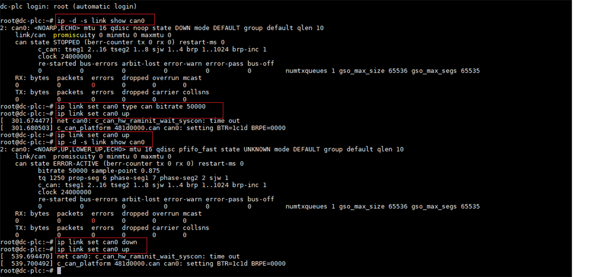

Hi:
I download the linux-rt-4.18.38 kenrel src from IT and switch on can0 device node in dts.
when I enable can0 of am4376 board and do like following:
#ip link set can0 type can bitrate 250000
#ip link set can0 up
  net can0: c_can_hw_raminit_wait_syscon:time out
  c_can_platform 481d000.can can0:setting BTR=1c5 BRPE=0000
It sometime tells "time out", but if I do "ip link set can0 up" again, and it will tell nothing.
and what's wrong with it?
Thanks!

  • Hi, thanks for your reply.
    1: The board is made by myself ,but it's mostly the similar with TI evm board.
    2: The boot log is in attchment.
    3:  It always tells "time out" no matter whether connect a can slave device or not.
    4:  It's strange that the can driver works well although it tells "time out" when I up it. The warning message "time out" seems to have no effection .
         I test it using a can socket with can slave device,  It works ok and it sends and receives data packages correctly.

    root@dc-plc:~# ip -d -s link show can0
    2: can0: <NOARP,ECHO> mtu 16 qdisc noop state DOWN mode DEFAULT group default qlen 10
        link/can  promiscuity 0 minmtu 0 maxmtu 0
        can state STOPPED (berr-counter tx 0 rx 0) restart-ms 0
              c_can: tseg1 2..16 tseg2 1..8 sjw 1..4 brp 1..1024 brp-inc 1
              clock 24000000
              re-started bus-errors arbit-lost error-warn error-pass bus-off
              0          0          0          0          0          0         numtxqueues 1 gso_max_size 65536 gso_max_segs 65535
        RX: bytes  packets  errors  dropped overrun mcast
        0          0        0       0       0       0
        TX: bytes  packets  errors  dropped carrier collsns
        0          0        0       0       0       0
    root@dc-plc:~# ip link set can0 type can bitrate 50000
    root@dc-plc:~# ip link set can0 up
    [  301.674477] net can0: c_can_hw_raminit_wait_syscon: time out
    [  301.680503] c_can_platform 481d0000.can can0: setting BTR=1c1d BRPE=0000
    2: can0: <NOARP,UP,LOWER_UP,ECHO> mtu 16 qdisc pfifo_fast state UNKNOWN mode DEFAULT group default qlen 10
        can state ERROR-ACTIVE (berr-counter tx 0 rx 0) restart-ms 0
              bitrate 50000 sample-point 0.875
              tq 1250 prop-seg 6 phase-seg1 7 phase-seg2 2 sjw 1
              clock 24000000
        0          0        0       0       0       0
        0          0        0       0       0       0
    root@dc-plc:~# ip link set can0 down
    [  539.694470] net can0: c_can_hw_raminit_wait_syscon: time out
    [  539.700492] c_can_platform 481d0000.can can0: setting BTR=1c1d BRPE=0000
    root@dc-plc:~#
