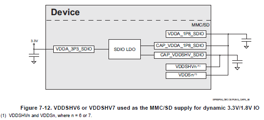

  • Hi Keerthy,
    I have a follow question regarding the actual implementation.
    Let us assume there are two SD CARD connectors on a board, CN1 and CN2, and both have an SD CARD inserted.
    CN1 is connected to the AM6526 via MMCSD0.
    CN2 is connected to the AM6526 via MMCSD1.
    How do you configure VDDSn or VDDSHVn so that:
    • 1st SD CARD @ 1.8V or 3.3V, independent from...⇓
    • 2nd SD CARD @ 3.3V or 1.8V
    Are the connections for VDDSHV & VDDS the same as shown in the older DS? (see below image)
    • (Rev.H、JAJSGC3H –NOVEMBER 2017–REVISED JUNE 2019)
    If connections are made following the diagram as shown in Figure 7-12, there is only one "CAP_VDDSHV_SDIO" pin to connect VDDSHVn to...so if VDDSHV6 was connected here, then VDDSHV7 can't be...
    Honestly, this is a little beyond me. If you can summarize the proper connection for two SD CARDS for dynamic 3.3V/1.8V functionality, independent of each other, it would be a huge help.

  • Hi Keerthy,
    Before raising a new post let me try asking this...
    There is documentation for migrating from Silicon Revision 1.0 to SR 2.0, but no DS for SR 2.0 yet.
    The last DS to have a discussion/example of the configuration for dynamic voltage with MMCSD is Figure 7-12 from the Revision H datasheet.
    The datasheet gives an example for dynamic voltage by connecting VDDSHVn (6 or 7?) to CAP_VDDSHV_SDIO.
    But there is only 1 CAP_VDDSHV_SDIO on the AM5x device...if so, then how can, for example, 1 VDDSHVn be dynamically set to 1.8V, while the other VDDSHVn is set dynamically for 3.3V?
    Am I misunderstanding something in relation to the VDDSHVn functionality?
    Darren

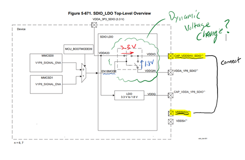

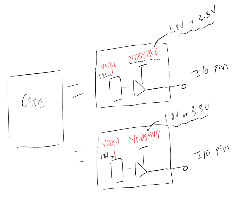

  • Hi Keerthy,
    Let me start over and try go through this step-by-step...
    • My understanding (as shown in the below image) is that the SDIO_LDO can be used to set the VDDSHVn to 3.3V or 1.8V.
    • This VDDSHVn is the power supply for the IO module (while VDDSn is the supply for the IO logic, usually 1.8V)
      1. See below image
    • Is it possible to change the voltage of VDDSHVn by changing the SDIO_LDO for 3.3V or 1.8V, without having to reset the entire device?
      • I ask because the SR 1.0 Erratta discusses the need for PORz when changing this voltage...
