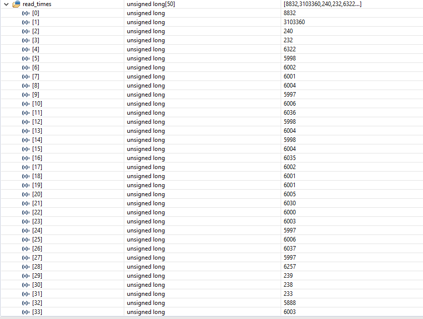

  • Frank,
    So I switched things over to polling to avoid the HWI and I am seeing the same results. Letting it run for a bit, 7% of the messages coming in are correct. The others are getting corrupted by overrun errors. Do you have any examples for profiling the UART read time?
    It is running at 48MHz.
  • Hi Connor,
    Unfortunately I don't have any examples. Here's a basic outline of how this can be accomplished:
    • Use the timestamp provider in <BIOS>/docs/cdoc/xdc/runtime/Timestamp.html & add timestamps at strategic locations in the application & UART LLD driver code.
    • If UART LLD in blocking mode, start by adding timestamps before/after the UART read function.
    • If UART LLD in callback mode, start by adding a timestamp before the UART read function, and another timestamp inside the callback function.
    • Add timestamps to UART HWI ISR to more granunularity.
    Can you increase the CPU frequency? I recall the default GEL files provided with BBB set the MPU PLL to 600 MHz.
    Frank
  • Frank,
    My mistake,48MHz is the input frequency for the UART. The CPU is running 800MHz.
    I had a hard time adding the timestamp.h to the UART LLD. I have been using the gmake (Windows) procedure to build the PDK and drivers and it requires additional include directories to use the timestamps. I was able to add the timestamps to my project code and found some interesting results. Read_times[0] is high due to the startup to first read time. But the time between the 1st and 2nd read is alarming. These times are in microseconds, so this is a 3.1 second delay. While stepping through the code, I am witnessing a delay of approximately 3 seconds so I believe this is an accurate measurement.
    Any suggestions for how I can add the timestamps to the UART drivers and be able to compile them? Any other suggestions for how I can dig in and find what is causing this delay?
    Connor
  • Hi Connor,
    It might be worthwhile to instrument your code with GPIO signaling to confirm the time stamps are correct.
    You should be able to add the same time stamps to the UART driver. To recompile theUART driver, open DOS prompt and issue these commands:
    > cd <PDK>\packages
    > pdksetupenv.bat
    > gmake uart_lib LIMIT_SOCS="am335x" BUILD_PROFILE="release"
    You might consider compiling the driver in debug mode and stepping through the code to get a better understanding of the driver flow. In this case use:
    • use "debug" instead of "release" for the above build command
    • add "UartPackage.Settings.libProfile = libProfile;" to .cfg file
    The UART_read() function will call UART_read_v1() in <PDK>\packages\ti\drv\uart\src\v1\UART_v1.c. The next read function called depends on whether the read is configured for interrupt or polling mode. Assuming you're using interrupt mode, the next function called is UART_read2_v1(). This function reads characters from the Rx FIFO until the read is complete or the FIFO is empty. If the Rx FIFO is empty but there are more characters to read before the transfer is complete, the remaining reads will occur in UART_v1_hwiIntFxn().
    You can add timestamps as need to difference portions of these functions to determine where all the time is being spent.
    Frank
