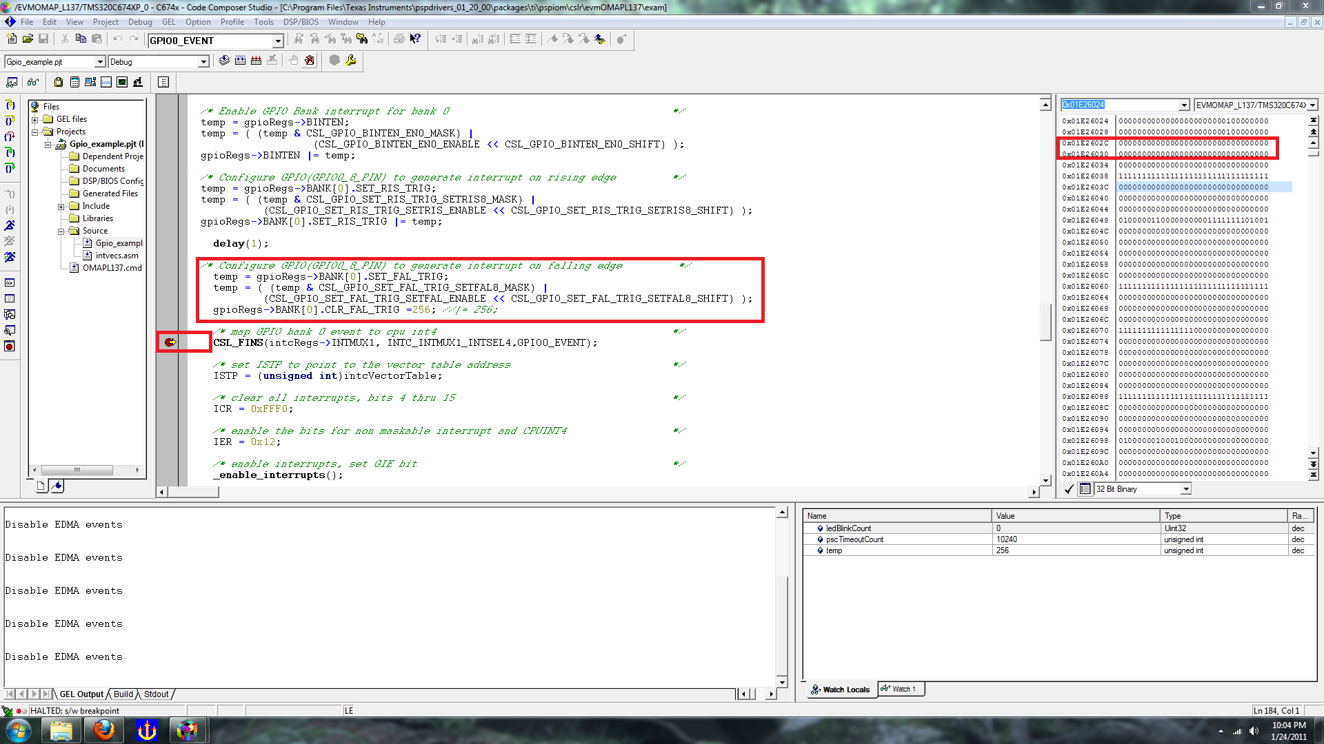

  • What I found with cSLR example was:  I couldn't access to the SET_FAL_TRIG register.  In another words, I cannot configure to generate an interrupt on a falling edge.  Please see the snapshot.
  • Sean,
    I'm afraid that screenshots do not work very well with the forum.  If you could post small code snippets and address/data pairs as text, it would be easier to follow.  For example:

  • Normal 0 false false false EN-US ZH-CN X-NONE
    Tommy, no problem, I can post the code snippets and address/data output as text.  Thanks for the reminder of the dip switch denouncing, I was aware of it.  My primary confusion is about the configuration operation to GPIO registers and how the ISR is called.
    I did a test on both “TI cSLR example code” and “TI BIOSPSP example code”.  So in the following, I’ll post the code snippets, and address/data output after the code is executed (i.e., a breakpoint just after the posted code).

    /* Configure GPIO(GPIO0_8_PIN) to generate interrupt on falling edge         */
    temp = gpioRegs->BANK[0].SET_FAL_TRIG;
    temp = ( (temp & CSL_GPIO_SET_FAL_TRIG_SETFAL8_MASK) |
    (CSL_GPIO_SET_FAL_TRIG_SETFAL_ENABLE << CSL_GPIO_SET_FAL_TRIG_SETFAL8_SHIFT) );
    gpioRegs->BANK[0].CLR_FAL_TRIG =256; //|= temp;
    Address = Data said:
    GPIO SET_RIS_TRIG01 (0x01E26024) = 0x00000800
    GPIO CLR_RIS_TRIG01 (0x01E26028) = 0x00000800
    GPIO SET_FAL_TRIG01 (0x01E2602C) = 0x00000000
    GPIO CLR_RIS_TRIG01 (0x01E26030) = 0x00000000
    My questions are:
    1.        Why SET_FAL_TRIG was not set correctly?
    2.       Where are     _enable_interrupts() and _disable_interrupts() are defined?

  • Sean,
    Thanks for posting the snippets and data.
    I suspect that this may be because your code is writing the 0x100 value to the CLR_FAL_TRIG register instead of the SET_FAL_TRIG register.

                /* Make the GPIO pin (GPIO0_12_PIN) conected to the LED to high *
                * This turns the off the LED DS2 - see schematic    */
                //temp = gpioRegs->BANK[0].SET_DATA;
                            //temp = ( (temp & CSL_GPIO_SET_DATA_SET12_MASK) |
                //          (CSL_GPIO_SET_DATA_SET_SET << CSL_GPIO_SET_DATA_SET12_SHIFT) );
                gpioRegs->BANK[0].SET_DATA= 0x1000u;
                delay(2000);
                                        printf("ledBlinkCount  = %d\n", ledBlinkCount);
                            /* clear corresponding INTSTAT01 interrupt bit */
                            temp = gpioRegs->BANK[0].INTSTAT;
                            temp = temp | 0x100u;
                gpioRegs->BANK[0].INTSTAT = temp;
                            /* to control/avoid the ISR running twice (i.e. LED blinks twice) */
                            flag = 0x1u;
    “printf ("1st time flag = %d\n", flag);” will be executed only when ISR is executed, while “printf("%d\n", ledBlinkCount);” will be executed only when a true falling edge was detected.  As shown below, the ISR was completely executed and then it was executed again IMMEDIATELY.  I also monitored the value of 0x01E26020h (IN_DATA01) and 0x01E26034h (INTSTAT01).  IN_DATA01 Bit-8 and entire INTSTAT01 register were 0 when the ISR was executed for the second time.
    Waiting for user to configure SW3-1
    1st time flag = 0
    1st time flag = 0                      (<-- printed when ISR was executed)
    ledBlinkCount  = 0                 (<-- printed when a falling edge was detected)
    ledBlinkCount  = 1
    ledBlinkCount  = 2
    1st time flag = 0                      (<-- printed when ISR was executed, immediately)
    ledBlinkCount  = 0
    ledBlinkCount  = 1
    ledBlinkCount  = 2
  • Tommy, thanks for the quick response.  I replaced the read-modify-write with your recommended operations, but it seems like the extra interrupt was still there.  This is what the new code looks like now:
    Code Snippet said:
    interrupt void GPIO_input_isr(void)
        volatile Uint32 ledBlinkCount;  //to delete later
        volatile Uint32 temp = 0;
        volatile Uint32 flag = 0;
        delay(6000);
        if ( ((gpioRegs->BANK[0].IN_DATA & 0x100u) == 0) && flag == 0)
                for (ledBlinkCount = 0; ledBlinkCount < 3; ledBlinkCount++) //blink DS1
                /* Make the GPIO pin (GPIO0_12_PIN) conected to the LED to low. *
                gpioRegs->BANK[0].CLR_DATA = 0x1000u;
                delay(2000);
                delay(2000);
        /* to control/avoid if() executed twice */
        flag = 0x1u;
    “printf ("1st time flag = %d\n", flag);” will be executed only when ISR is executed, while “printf("%d\n", ledBlinkCount);” will be executed only when a true falling edge happens.  As shown below in Stdout, it seems like the ISR was completely executed and then it was executed again IMMEDIATELY.  That’s what confused me.
    1st time flag = 0
    1st time flag = 0
    0
    1
    2
    1st time flag = 0
    0
    1
    2
  • Sean,
    I didn't notice in your previous post, but it looks like you are performing a read-modify-write on the INTSTAT register as well.  This register is write-1-clear (W1C) so it is similar to the CLR register.  By doing the read-modify-write, you are clearing all of the active INTSTAT values at once.  Perhaps it is hiding the source of the second interrupt.
    -Tommy
    Tommy, I changed the read-modify-write operation of INTSTAT, but the extra interrupt was still there.  One question:  assume now I have an interrupt that has already generated 1 in INTSTAT register.  Before this flag bit is cleared (to 0), there comes a second exactly same interrupt.  Will this second interrupt be ignored?  Or will it be stored so that it can be serviced after the first ISR?
  • Sean,
    Good point.  Even when the INTSTAT flag is set, subsequent GPIO activity on the pin will generate additional interrupts to the CPU so it's possible to have an additional interrupt queued up while the pin signal is bouncing in the ISR debouncing wait function.  To see if this is the case, you can disable the GPIO interrupts for that specific pin with the CLR_*_TRIG registers before the debouncing wait function and then reenable it after the wait function.
    If that works, there is still the possibility that a really fast follow-up GPIO bounce can strike between the time that the CPU branches to ISR and when you disable the interrupt.
    -Tommy
  • Tommy, you provided a good approach. I disabled the trigger at the beginning, and renabled it at the last step of the ISR. This way the extra interrupt disappeared.  Regarding the CPU capability to queue up the interrupts, is there anyway to disable this function, or is it always the case for L137?  I truly appreciate your help along my laundry list of questions.
  • Sean,
    There's not an easy way to disable the queueing of interrupts.  This is typically a desired feature so that high-latency systems will not miss interrupt events.  You might be able to mask GPIO interrupts for a period of time at the interrupt controller level, but that can lead to problems if you are looking for interrupts from multiple pins in the same bank.  The safest thing to do would probably be to disable only a single pin interrupt at a time through the GPIO module and ignore interrupts where INTSTAT is empty.
    -Tommy
  • Tommy, do you know in which document I can find the descriptions of the queueing of interrupts?
  • Sean,
    The interrupt architecture is described in the C674x Megagmodule guide: http://www.ti.com/lit/pdf/sprufk5
    Since you are using a dedicated interrupt line, I think the DSP clears the status flag before entering your ISR.
    -Tommy
  • What is the relationship between IFR, GPIO INTSTAT01, and EVTFLAG65?  Is INTSTAT01 sort of an event-level flag, same as the EVTFLAG65, while IFR is the ultimate DSP CPU INT-level flag to trigger the processing of ISR?
  • Sean,
    INTSTAT01 is local to the GPIO module.  The GPIO module has one interrupt signal per bank.  In the case of BANK0, this signal is hooked up to event 65 in the DSP megamodule's interrupt logic.
    Event 65 is routed per the user's configuration to an actual INT signal in the DSP megamodule (INT4-INT15).  The IFR register reflects the history of the INT signals.
    -Tommy
  • Got it, thank you for your explanation, Tommy.
