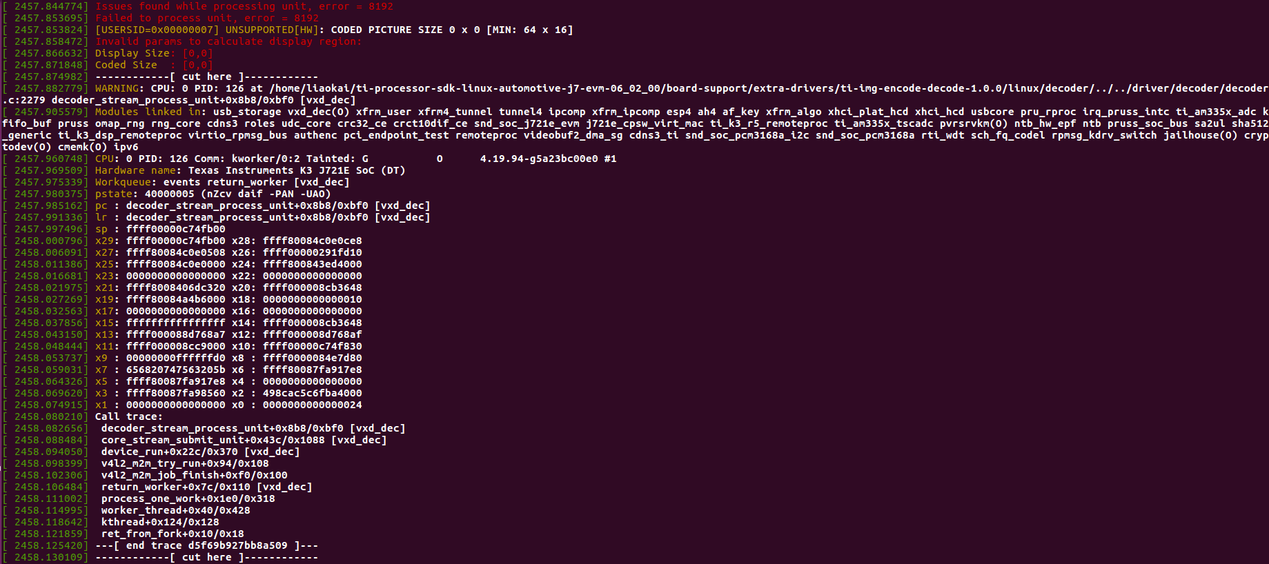

Hi guys,
When I use tidec_decoder demo program provided by TI to decode our H264 format data stream, the program is stuck at same frame each time. I tried many other H264 data streams, and got the same result.
I am not sure whether there is some type of frames that the decoder can not recognize or decode, and this type of frame will stuck the decoder.
Because of this problem, we are not able to use decoder on TDA4 now, so please help to solve this problem as soon as possible. Thanks very much!
Below is the print info of dmsg command. SDK version is 6.2.

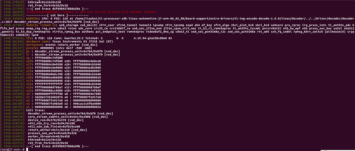

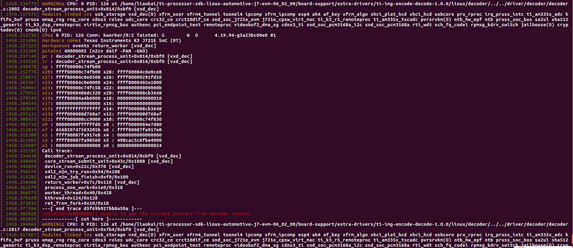

  • Updates to this issue.
    We switched to RTOS Decoder Node with OpenVX, and narrow down this root cause. This issue is caused by abnormal i frame in the video sequence.
    Test video should be 14 p frame + 1 i frame, but this video contains some abnormal i frames, which occurs inside 14 p frames. This causes Decoder stucked.
    Here is the log from OpenVX.
