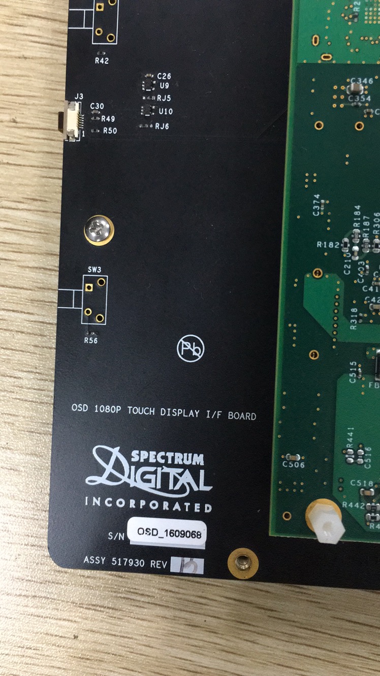

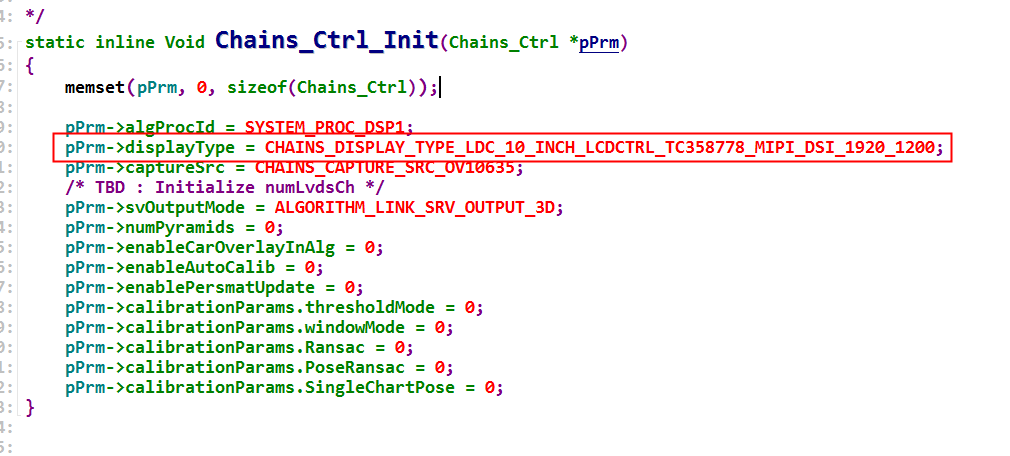

2.i want to modify display to lcd,and i modify the config:
~\vision_sdk\apps\src\hlos\adas\include\chains.h

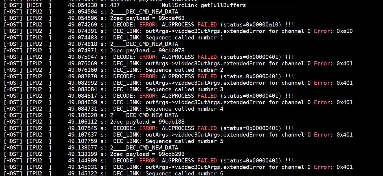

3.the error:

  • Hi Cesar,
    This error is from the decoder and has nothing to do with LCD>
    Did you use proper hdr file in this usecase?
    The decoder error says , decoder did not get a valid frame.
    Is this working without any of the changes?
    RamPrasad

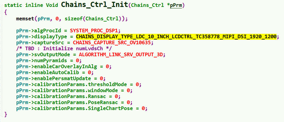

  • Hi RamPrasad,
    the hdr file is corrected and remove the error,but the lcd is not output, i only modify the config:
    pPrm->displayType = CHAINS_DISPLAY_TYPE_LDC_10_INCH_LCDCTRL_TC358778_MIPI_DSI_1920_1200;

    You no need to do any changes in the code for choosing the display type.
    after boot-up, press 'S' from the keyboard then choose your display type.
    Gaviraju

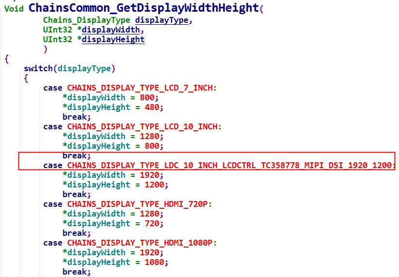

    the lcd all config:
        CHAINS_DISPLAY_TYPE_LCD_7_INCH = 0,
         /**< Output displayed on 7 inch LCD */
         CHAINS_DISPLAY_TYPE_LCD_10_INCH,
         /**< Output displayed on 10-inch LCD */
         CHAINS_DISPLAY_TYPE_LDC_10_INCH_LCDCTRL_TC358778_MIPI_DSI_1920_1200,
         /**< Output is displayed on 10Inch 1920x1200 LDC */
    I tested that everything didn't work..
    regards,
    cesar

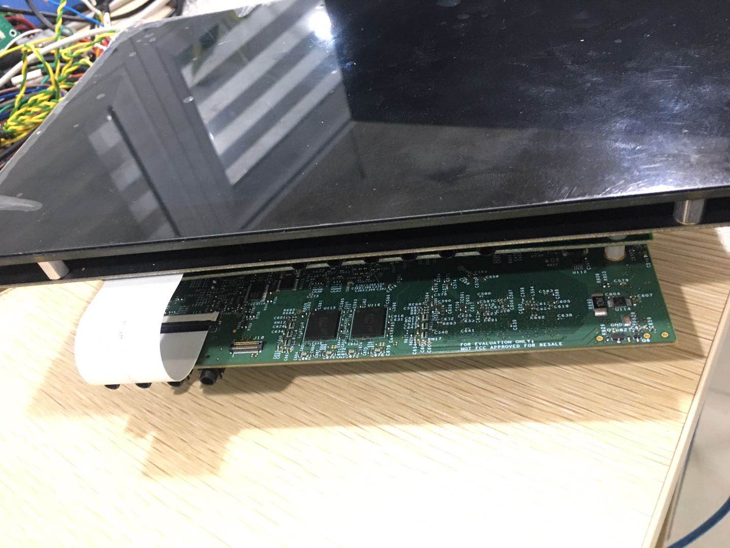

    You are running use-case in Linux is (NullSrc + Decode + Display (Only 1920x1080 H264/MJPEG Video Input Bit-Stream Supported))'
    The supported display option in Linux is
    1: LCD  10-inch 1280x720@60fps
    2: HDMI 1080P60.
    By default, the HDMI display is configured & you can choose the display at run time.
    If you choose the LCD display option, then you have to do changes in use-case because in the use-case the input & display is configured for 1920x1080 resolution.
    Gaviraju
    are you sure ? the evm lcd is 1080p and , the usecase already get the resolution from the config:
    I hope you can test it and then reply to me.
    thanks
    cesar
