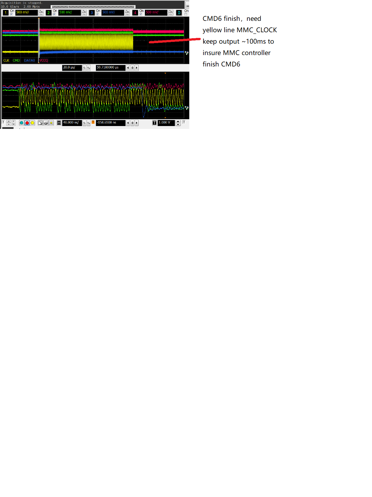

Our customer need use PON (Power off notification) function at their project. Micron eMMC when received PON command -- CMD6, Micron emmc need long time to process the PON command. But J6 emmc driver will stop eMMC_CLK very quickly. So micron emmc can not successful finish PON command.
Could you please suggest how to disable J6 emmc power save mode? We have try to modify omap_hsmmc_set_ios() power_off case and delete all those POWER_OFF function. it can not keep eMMC send out clock.
Best Regars!

  • Hi Han Tao,
    In Linux Kernel omap_hsmmc driver we don't think there is an issue handling power off notification.

  • Hi Vishal:
    Thanks for your help.
    Except your provided driver modify. At linux PSDK release use below command can continue send out MMC clock.
    With below command, now can continue send out eMMC_CLK at EVM board. Believe this method can work.
    dd if=/dev/mmcblk0 of=/dev/null count=1000000 &
    omapconf write 0x480B4010 0x14
    omapconf write 0x480b4110 0x130C
    omapconf write 0x480b412C 0x118620
