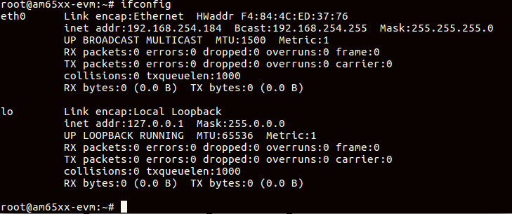

I am using default file system  and i am able see all the PHY interfaces enabled using ifconfig(ex:- eth0,eth1....) by default after successfully booting.
But while using  arago-tiny-image-am65xx-evm only ETH0 is detected .
Is there any possibility of enabling two MII(PHY) Ethernet interfaces in Arago tiny file system ??
regards
Venkatesh

  • Hi Karthik ,
    I have prepared a kernel image with required kernel modules and with this image, generated target NFS .Copied entire TargetNFS folder to rootfs of EVM SD card , after booting i can see all the PHY's.
    I didn't change any def-config files used default ones.
    Now the issue is  if I use the same image in arago-base-tisdk-image-am65xx-evm filesystem and copied this filesystem to sdcard  i can see only 2 PHYs  .
     "You have to look into the kernel, modules, dependencies and the init scripts - the problem, in my best guess, could lie here."
    Can you please provide any references , elaborate dependencies and  init scripts?
    BR
    Venkatesh
