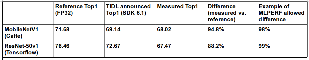

Hello TI,
I am trying to validate many classification networks on emulation, but I was not able to get the same numbers published in 6,1 SDK TIDL docs for these two networks. Here are the numbers:
These networks were imported using the default TI configs present in 6.2 version of the SDK and downloaded from the links provided in TIDL documentation (pretrained models). Please note that the validation was performed on the first 10000 images of the ImageNet (ILSVRC2012) validation dataset as mentioned in the docs.
We expect the values to be less than the reference FP32 implementations since TIDL importer does quantize the networks, but we would like to understand the source of the difference comparing to the values you obtained.
Also, we noticed that these validation numbers were removed from the TIDL documentation in the latest release of the SDK 6.2. Does that mean that we should expect the same values, or that those numbers are not valid anymore?
Youcef.
