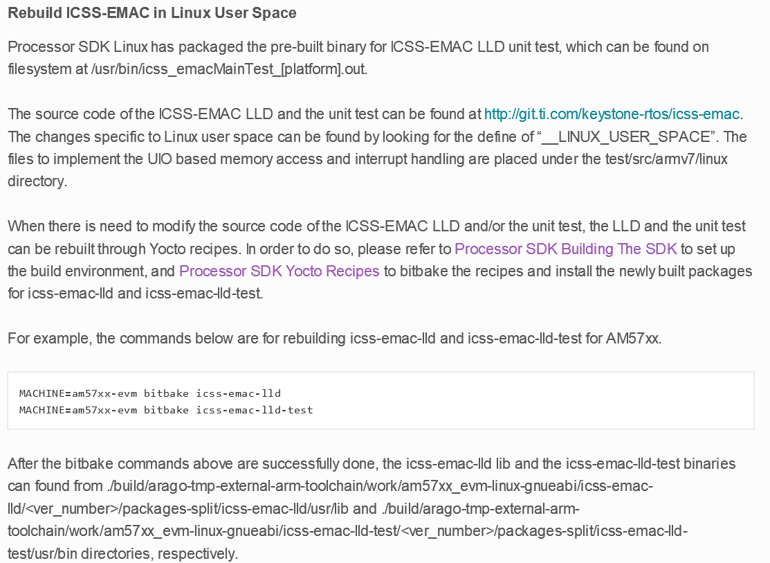

I have two question on rebuild ICSS_EMAC in Linux User space
When need to modify the source code of the ICSS_EMAC LLD and unit test, why we need use Linux SDK to compile it? Can we use RTOS SDK to compile the PRU unit test, then generate the *.out file which can be put as PRU image in Linux file system?
If we re-build the icss-emac-lld and icss-emac-lld-test for AM57x, where to put RTOS source code in Linux SDK folders?
