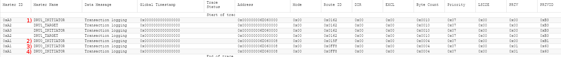

  • Hello Dave,
    these firewalls seem to be all disabled. Also we're not getting any exceptions logged. We manually configured a different firewall to block access to DDR memory, and got the expected errors logged, so I suppose we're looking at the right registers for FW configuration and logging.
    We're currently trying to figure out if the problem is due to the size of the write transactions. While we're only executing 32-bit wide accesses on the x86 we see 16-byte accesses in a "Transaction logging" trace (last column shown is "Byte Count"):
    This shows a write to offset 0x8 on a PCIe BAR that is set up to map 0x6d060000, followed by a read of the same word:
    I'm not sure if we're chasing ghosts here, e.g. if the transaction logging feature is being fooled. If we're executing these accesses using the debugger or the R5f core though, the transaction size is 4 bytes in length:
    Write using "CS_DAP_0" ...memory.writeWord (I'm assuming this uses the DAP's AHB master):
    Write using activeDS.memory.writeWord (I'm assuming this uses the R5f processor):
    Write using application running on the R5f:
    My guess is that somewhere (within the x86, within the PCIe EP, within some interconnect) my 32-bit access is translated to a larger burst with only certain byte enables set - no idea if that makes any sense at all - and that the DRU registers are unable to handle this kind of transaction, while the UDMA registers are able to cope with that.
    I've checked writes to DDR memory and MCU SRAM, too, and all writes via the PCIe EP reach the target with a Byte Count of 0x10.
    I've also checked that even though the transaction log sees a 16-byte write with a 16-byte aligned address (6D060000 when writing to 6D060008), only the desired bytes get actually written.

  • Hello Dave,
    We're currently trying to figure out if the problem is due to the size of the write transactions. While we're only executing 32-bit wide accesses on the x86 we see 16-byte accesses in a "Transaction logging" trace. I'm not sure if we're chasing ghosts here, e.g. if the transaction logging feature is being fooled. If we're executing these accesses using the debugger or the R5f core though, the transaction size is 4 bytes in length:
    1) shows a write to offset 0x8 on a PCIe BAR that is set up to map 0x6d060000, followed by a read of the same word
    2) shows a write using "CS_DAP_0" ...memory.writeWord (I'm assuming this uses the DAP's AHB master)
    3) shows a write using activeDS.memory.writeWord (I'm assuming this uses the R5f processor)
    4) shows a write using application running on the R5f (same Route ID as before, so probably the same initiator)
    It would be great if you could confirm or refute my assumptions:
    • Is it possible that the PCIe controller or the AXI <-> VBUSM bridge within the PCIE subsystem translates our 32-bit write to a 128-bit write with only certain byte enables set?
    • Is there any documentation of the CBA/VBUSM, e.g. what kind of transactions it supports?
    • Is it possible that this 128-bit write (with byte-enables) poses a problem for the DRU registers, but can be handled just fine by the UDMA controller for example?
    Dominic

  • Hello Jian,
    I tried to further debug this, first using the DRU firewall, then using PCIe AER header logging, but unfortunately I haven't come very far.
    After restricting access to the DRU using the firewall, I was able to see my access getting logged, the x86 returned all 0xff, and the PCIe endpoint set the SIGNALED_TARGET_ABORT.
    • Just like the transaction log the firewall shows all accesses aligned to 16 bytes
    • The firewall shows all READ accesses as 16 bytes long, no matter whether I try to read/write 1, 2, 4, 8 or 16 bytes.
    • The firewall shows my WRITE accesses as 8 bytes long, no matter whether I try to read/write 1, 2, 4, 8 or 16 bytes.
    • My access to the DRU_CHRT_* registers at 0x6d06nnnn show up with a target address of 0x0008nnnn. Addresses up to 0x6d05fff0 show up un-shifted, at 0x60000 the addresses seen by the firewall have an offset of 0x20000. No idea if that's relevant. Apart from that, accesses to other parts of the DRU region are seen the same way by the firewall, i.e. aligned to 0x10, size 16 for reads and 8 for writes.
    I have no idea if there's anything in the x86 (RC) that could cause my requests to be delivered to the AM65x that way. I tried to (ab-)use the PCIe advanced error logging to have my TLP logged, but haven't been successful that way. I managed to have my accesses treated as CA (completer abort) or UR (unsupported request), and I get the HEADER_LOG_OVERFLOW_STATUS bit set, but the Header Log registers always contain 0. The devmem utility is using /dev/mem with O_SYNC and should thus treat the memory as "uncacheable".
    Apart from the size of the access I noticed a few more differences in the transaction log:
    • The Privilege is 0 (User) for accesses coming from PCIe, and 1 (Supervisor) for access from the R5f.
    • The Data Type is 2 (DMA) for accesses coming from PCIe, and 0 (CPU) for access from the R5f.
    • The Sharability is 0 (Non shareable) for accesses coming from PCIe, and 3 (System) for accesses from the R5f.
    • The Secure field is 0 (not secure) for accesses coming from PCIe, and 1 (secure) for accesses from the R5f.
    • The Memory Type is 1 (Normal WB cacheable) for accesses coming from PCIe, and 0 (device) for accesses from the R5f.
    The differences could also be a reasonable explanation for the behaviour I'm seeing, but I have no idea how to influence these attributes of my accesses.
    Any help would be appreciated.
    Dominic
    Is this also true for RC transactions to a regular memory region, say MSMC SRAM region? If answer is yes, then we can focus on RC packing, if answer is no, then we can focus on EP, thoughts?
    Jian
  • Hello Jian,
    I verified the effect on the firewall logging again, and the behaviour is different between writing to the DRU region and writing to DDR memory.
    READs and WRITES to DRU registers mapped via BAR5 are logged as 16 bytes for READs and 8 bytes for WRITEs.
    READs and WRITES to DDR registers mapped via BAR2 are logged as 16 bytes for READs and WRITEs.
    I'm accessing addresses at an offset +0x8, but the logged address is always 0x10 bytes aligned, for READs and WRITES to both DRU and DDR memory. This could mean that the WRITE transaction to the DRU arrives as 16 bytes at the DRU firewall, but is split into two 8 byte writes at the firewall. Also the transaction trace doesn't show a difference for READs and WRITEs to the DRU registers.
    If I block access to the DRU for the R5f the transaction gets logged with the correct address and size.
    I guess we'll be able to trace the PCIe transactions on the bus, but that wont happen before next week.
    Can you comment on the differences between PCIe and R5f access visible in the transaction log?
    Dominic

  • Hello Jian,
    we've verified the TLPs coming from the x86 using a PCIe analyzer, and the transactions seem to be just fine.
    We tried reading/writing 8, 16, 32 and 64 bits aligned to 0x...0, 0x...4 (not for 64-bit) and 0x...8, and the accesses appear as MRd(32) TLPs with a length of 1 or 2 and the appropriate 1st/last byte enables set. The address is always the actual address read or written (0x...0, 0x...4, 0x...8).
    In the SoC transaction log the accesses appear as 0x10 bytes long with an address aligned to 0x...10).
    Could you verify again with your colleagues if there's anything in the PCIe EP implementation, maybe the AXI2VBUSM bridge that could explain this behavior?
    It would also be interesting to know why this poses a problem for the DRU but not for the MAIN or MCU UDMA registers (if the transaction length really is the issue).
    Dominic
