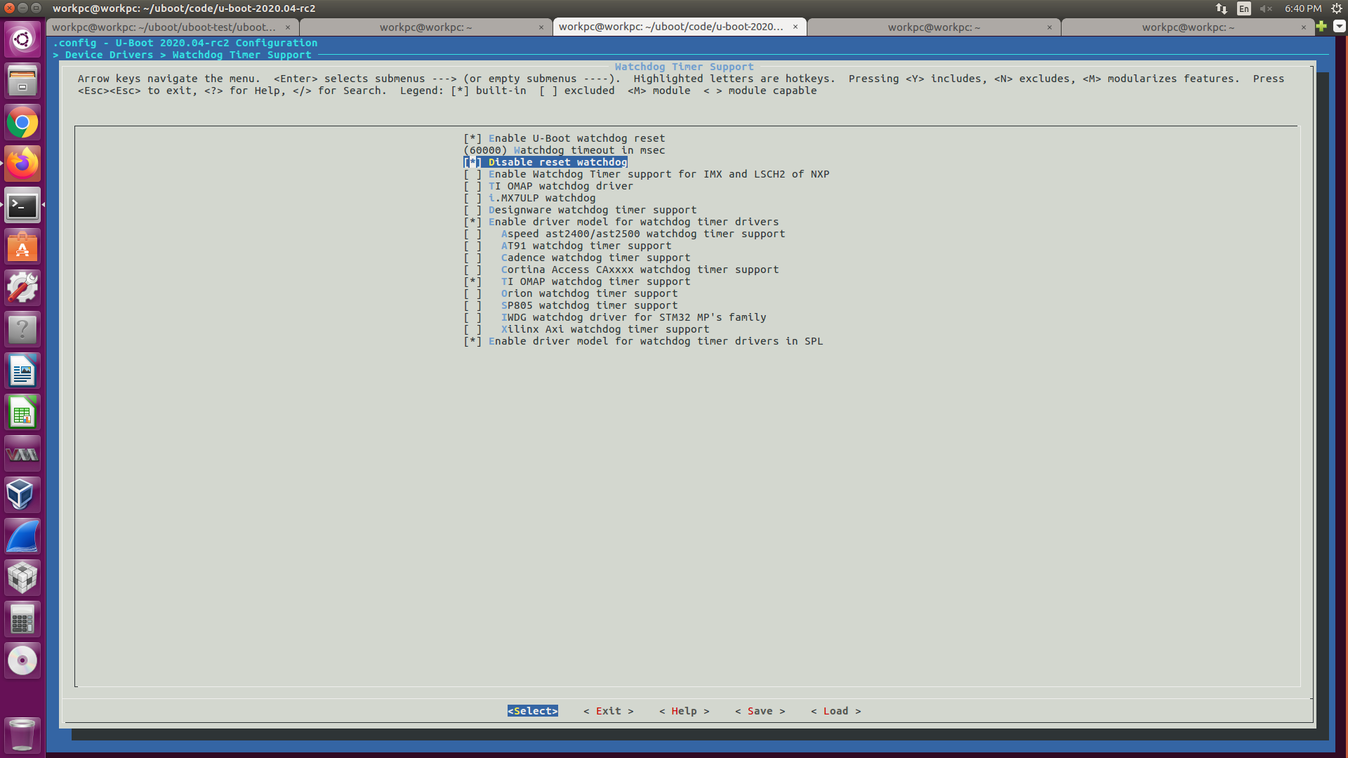

BEAGLEBK: WDT support in SPL
Part Number: BEAGLEBK
For Beagle Bone Black, when I try to include the the watch dog timer feature in SPL through u-boot menuconfig
"Device Driver>Watch Dog Timer Support>Enable Driver Model for Watchdog timer driver in SPL"
The below build error is generated.
arch/arm/mach-omap2/built-in.o: In function `spl_board_init':
/home/workpc/uboot/code/u-boot-2020.04-rc2/build-am335x_evm/../arch/arm/mach-omap2/boot-common.c:211: undefined reference to `hw_watchdog_init'
make[2]: *** [spl/u-boot-spl] Error 1
make[1]: *** [spl/u-boot-spl] Error 2
make: *** [sub-make] Error 2
Does u-boot SPL for Beaglebone Black support Watch Dog Timer or not??

  • Part Number: BEAGLEBK
    U-Boot Version:2020.04-rc2
    Target Board:Beaglebone Black RevC
    In the u-boot code for Beaglebone Black ,could you please elaborate on the menu-config option "Disable reset Watchdog" at
    Device Drivers> Watchdog Timer Support
    From the help given with this option,
    " Disable reset watchdog, which can let WATCHDOG_RESET invalid, so that the watchdog will not be fed in u-boot."
    I could not understand its purpose.
    Was also trying to see if the other option "Enable U-boot Watchdog reset"  along the same menuconfig path ,has anything to do with this?
    Adarsh
