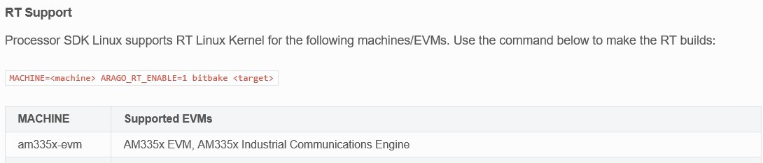

Hello
Is RT Linux supported in AM335x Starter Kit?
Best Regards.
    There is RT support for the AM335 evm-sk. The pre-built images in the RT SDK show the board EVM-SK dtb is getting built. The TI EVMs for a processor class all use the same the binary images for u-boot and the kernel.  There is a board dtb for each board that defines the peripherals that are in use on a particular EVM.
    This is most likely a documentation issue. After building make sure that the am335x-evmsk-am335x-evm.dtb and am335x-evmsk.dtb are generated.
    Schuyler
